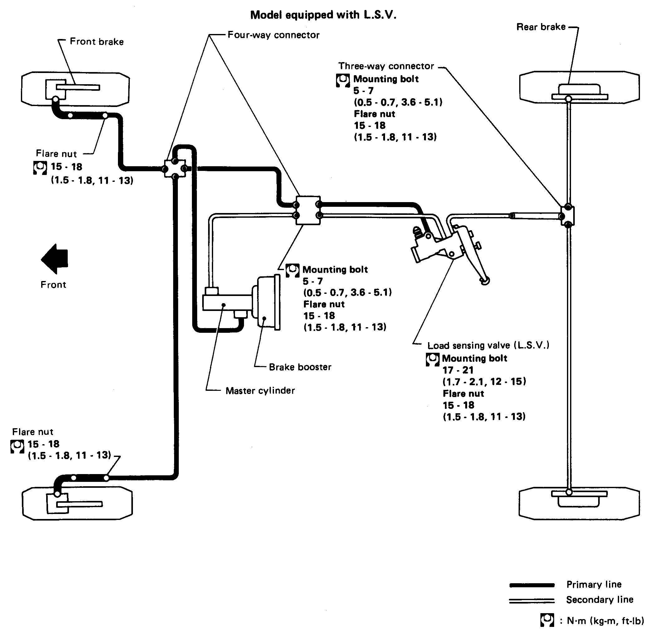

I own the truck listed above which I use occasionally to do things like haul trash or furniture. I parked my truck back in June and when I parked it the brakes worked perfectly fine. got my truck out the other day hooked the battery up truck started right up I put it into drive and head down my driveway start to approach cross street step on brakes pedal goes to floor. tried pulling emergency brake nothing happens. put truck into neutral coast to a slowdown throw it in park. at this point I checked the brake fluid it's slightly low, so I top it off thinking problem solved. I put it back into drive only to have the same problem as before. if the engine is off you have a brake pedal soon as you turn the engine on there is no brake pedal or no brakes. as I said the car hasn't been driven since June and I'm trying to figure out what could have happened to cause this issue.

I have to be honest, if there are no fluid leaks, you need to replace the master cylinder. Chances are the internal plungers have failed and are allowing brake fluid to bypass them. However, confirm there are no leaks before doing this. Since you filled the fluid, pump the brakes several times to see if the fluid level drops. Take a look through this link:
https://www.2carpros.com/articles/brake-pedal-goes-to-the-floor
If you determine the master cylinder is the problem, here is a link that explains how in general to replace it:
https://www.2carpros.com/articles/how-to-replace-a-brake-master-cylinder

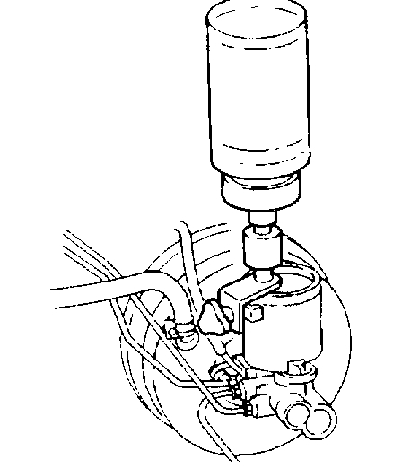

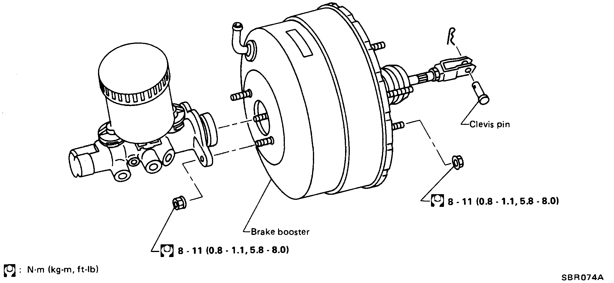

Here are the directions specific to your vehicle for replacement. The two attached pics correlate with the directions.
____________________________________
1990 Nissan-Datsun Truck D21 Hardbody 2WD L4-2389cc 2.4L SOHC MFI (KA24E)
Removal/Installation
Vehicle Brakes and Traction Control Hydraulic System Brake Master Cylinder Service and Repair Procedures Removal/Installation
REMOVAL/INSTALLATION
Brake Booster And Master Cylinder
pic 1
1. Connect a vinyl tube to the bleeder screws.
Brake Bleeding
pic 2
2. Depress brake pedal, open bleeder valves and drain fluid into suitable container. Repeat until master cylinder is empty.
3. Disconnect brake lines, remove master cylinder attaching nuts, then master cylinder.
4. Reverse procedure to install, bleed brakes.
CAUTION:Do not spill brake fluid on painted areas, it may cause paint damage.
For additional information see Notes, Warnings, and Hints. See: Brake Master Cylinder > Fundamentals and Basics

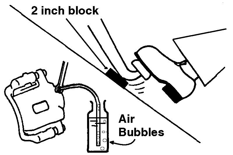

1. Have someone slowly pump the brake pedal several times, then apply steady pressure.
WARNING: Do not Full Stroke the brake pedal, this may damage the master-cylinder. Place a 2 inch block of wood under the brake pedal to prevent Full Stroking.
pic 3
Brake Bleeding
pic 4
2. Loosen the brake bleed screw to allow air to escape from the system. Then tighten the bleed screw securely. Repeat this step until a steady stream of brake fluid is emitted.
NOTE: Do not release the brake pedal until the bleeder valve is fully shut.

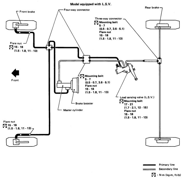

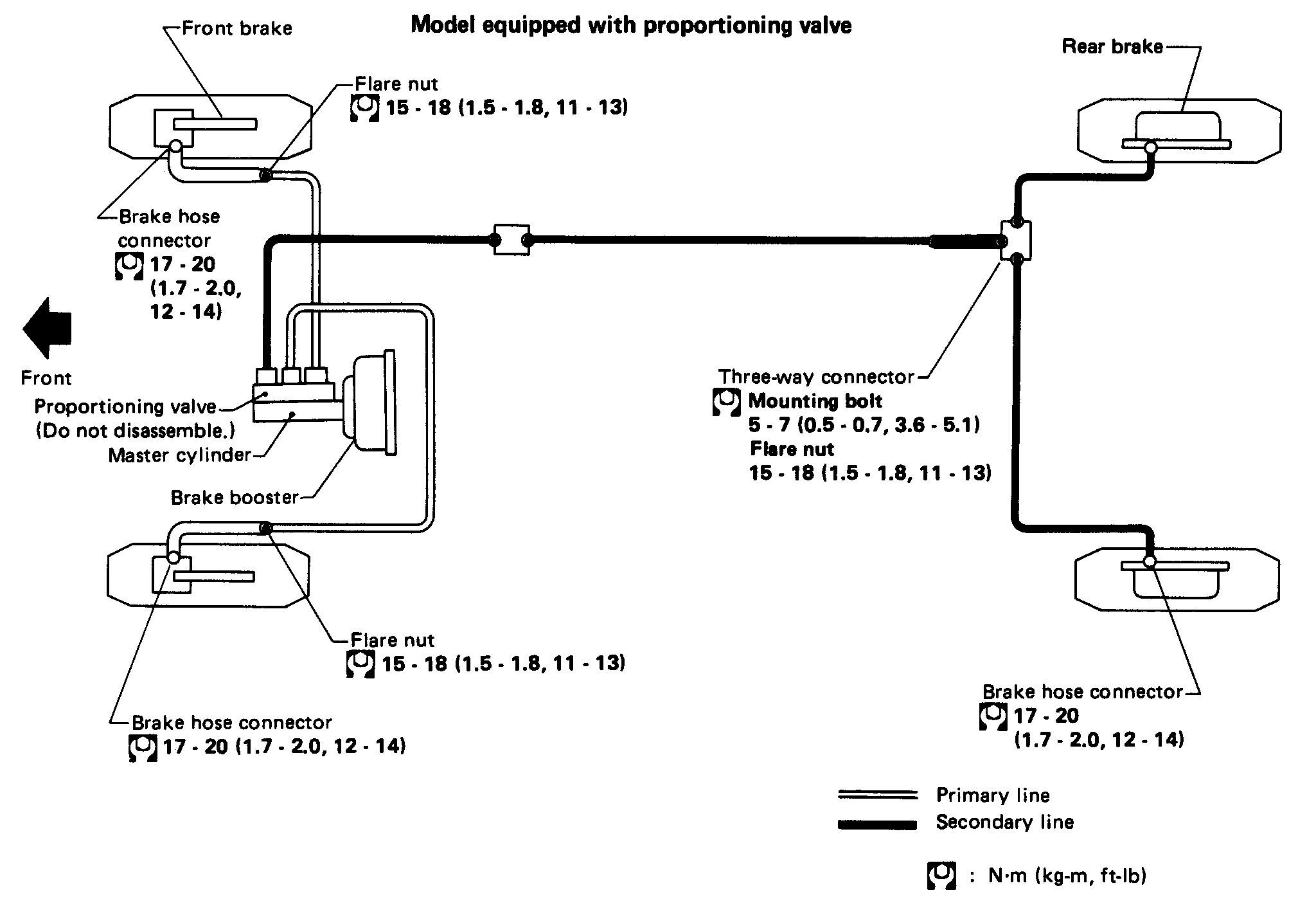

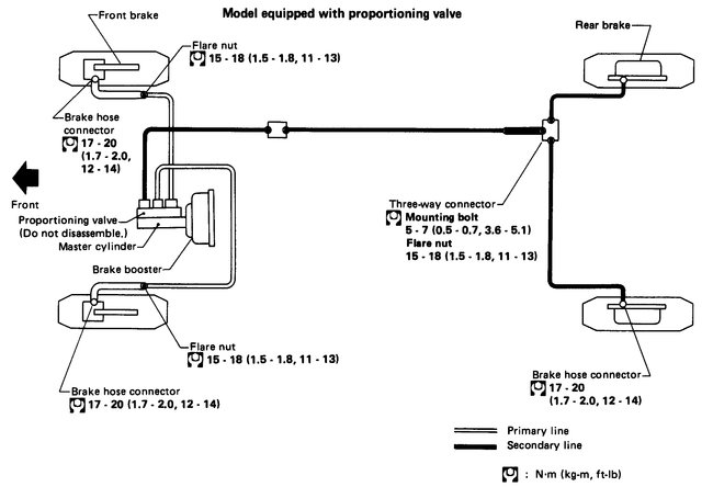

3. Repeat the procedure for each wheel in the sequence shown below.
pic 5
pic 6
WITH L.S.V. AND PROPORTIONING VALVE
Brake Bleeding Sequence
1. Load Sensing Valve air bleeder (LSV) if equipped.
2. Left rear.
3. Right rear.
4. Left front.
5. Right front.
WARNING: Do not bleed the brakes with the drums removed. The wheel cylinders will over-extend and eject the pistons.
