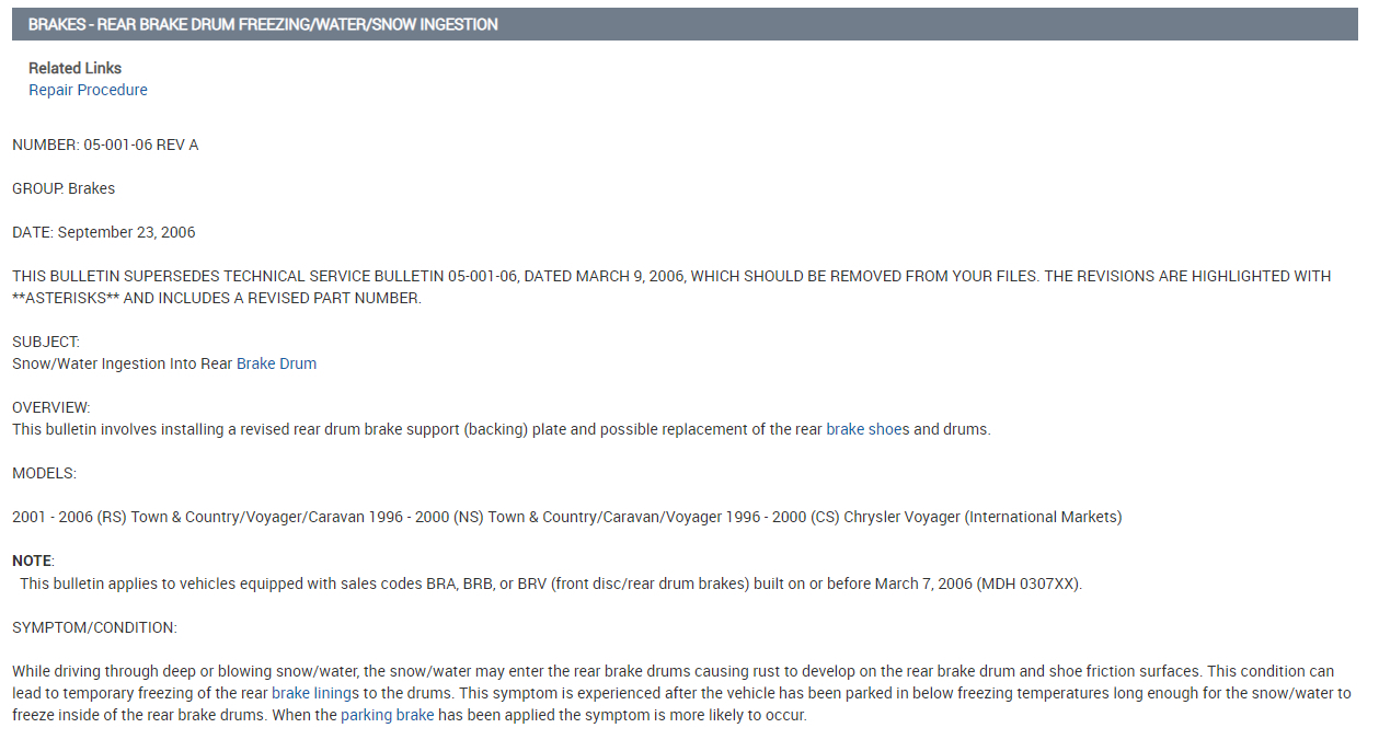

my front brakes seem to lock up and make a moaning sound
1997 DODGE CARAVAN
222,000 MILES • 3.3L • 6 CYL • 2WD • AUTOMATIC
KIM MILLS JACKSON
With new pads, rotors, caliper my front brakes seem to lock up and make a moaning sound only in wet slushy snow. I get stopped and go again and if it's dry they don't lock up again, if not they will lock again.

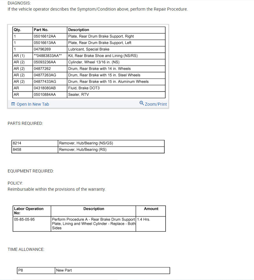

NICKOLAOSF
  • 69 POSTS
Hi Kim Mills Jackson,
We can help you with this information. This sounds like you have brake issue and you should see service bulletin. Check out the diagrams (below).
then report back with exactly what you have performed repairs and if noise is coming from the rear. you will have to figure out where your issue is front or rear, was it doing that before parts were replaced? Let us know what happens and please upload pictures or videos of the problem any lights showing on your dash.
Cheers, Nick
Mar 2, 2021 at 10:15 AM
