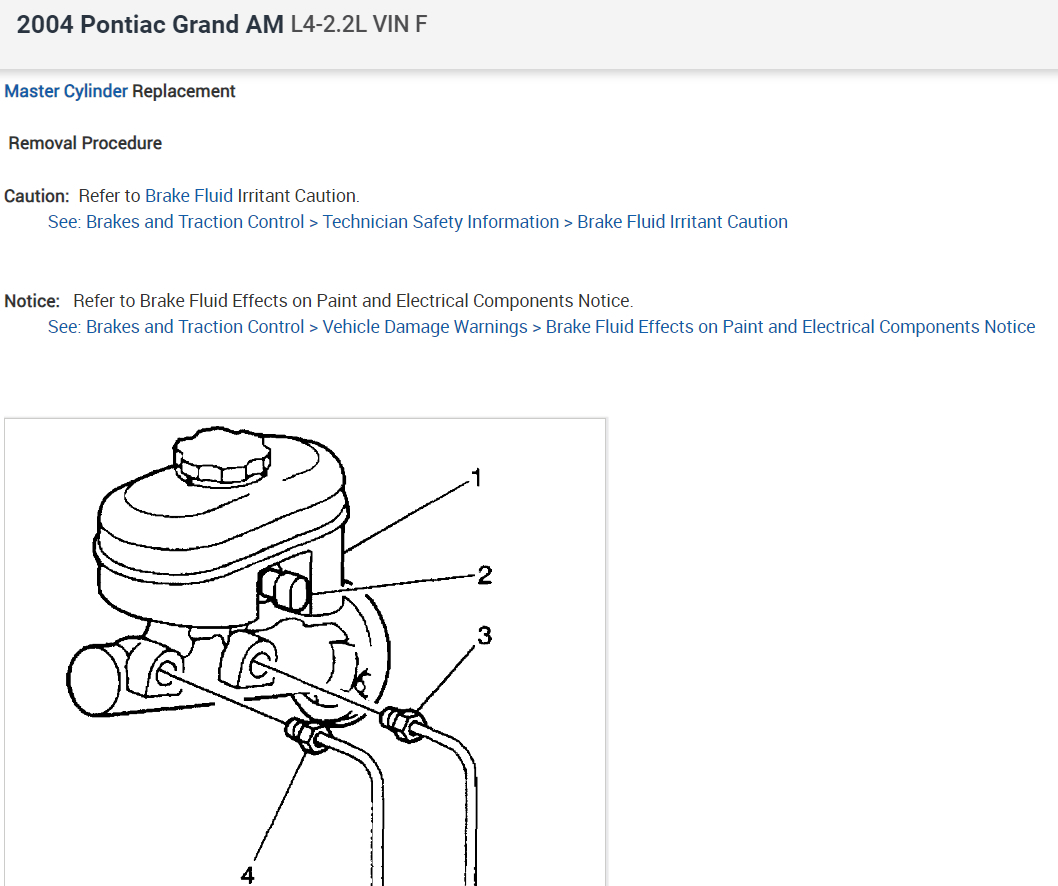

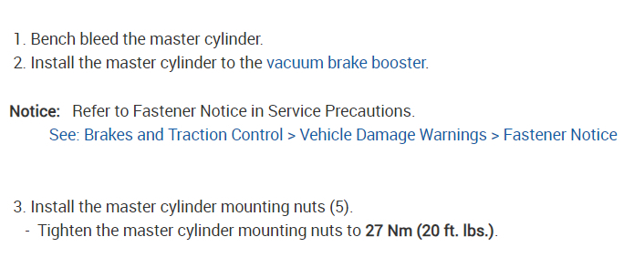

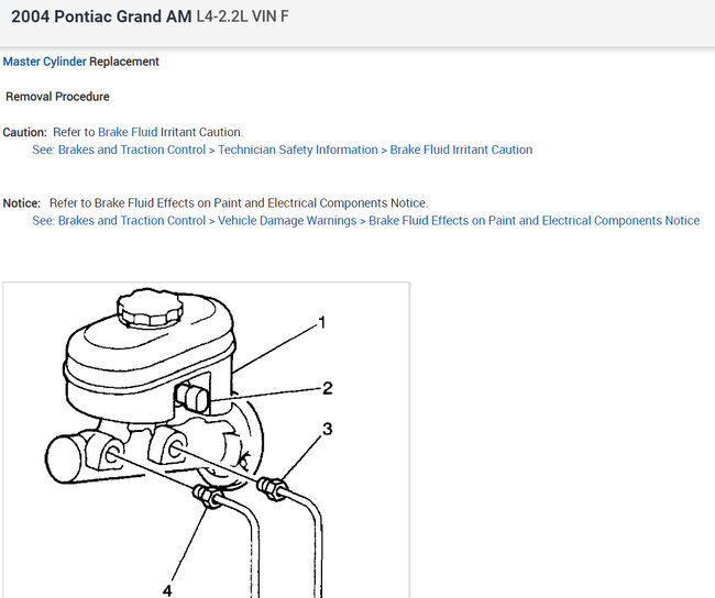

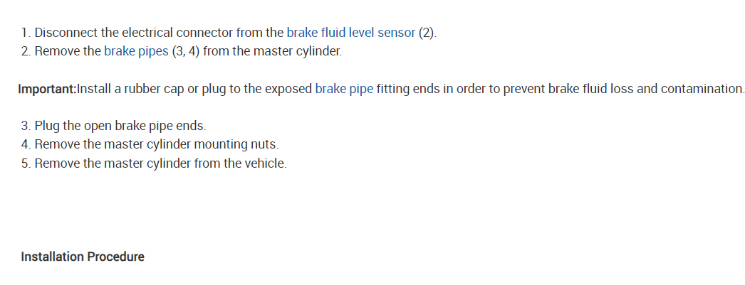

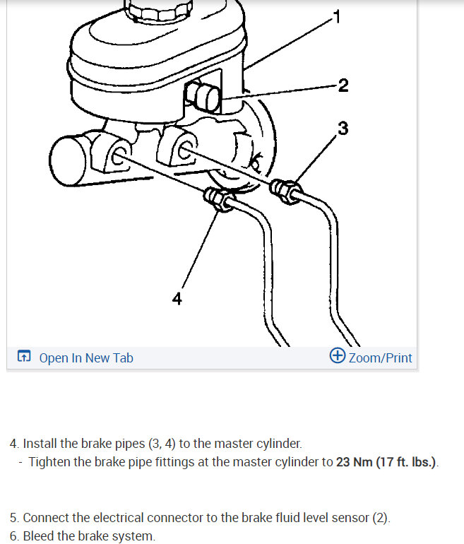

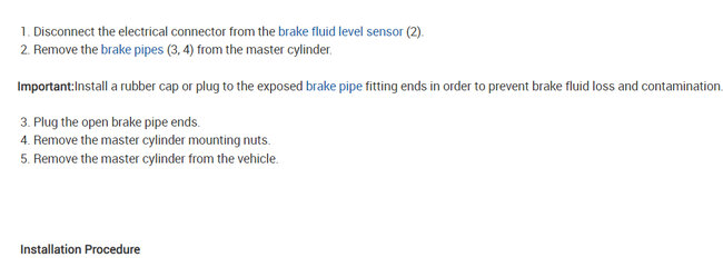

To me it sounds like a classic brake master cylinder failure, but you should check the caliper slides to make sure one of them is not frozen.
Here are two guides to help you see what's going on and how to replace the brake master cylinder as well:
https://www.2carpros.com/articles/brake-pedal-goes-to-the-floor
and
https://www.2carpros.com/articles/discover-why-automotive-brake-pads-wear-unevenly
Here is a video to help you bleed the brake master before installation:
https://youtu.be/WDxvEQrMkBg?si=tjfLIwJFTpwcTEW2
