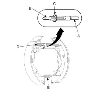

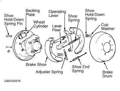

1. Remove the shoe hold spring and shoe hold pin (B).
2. Remove the upper return spring (A).
pic 1

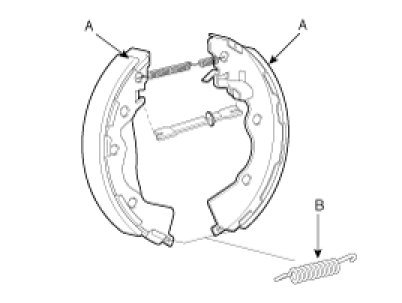

3. Lower the brake shoe assembly (A), and remove the lower return spring (B). Make sure not to damage the dust cover on the wheel cylinder.
pic 2
4. Disconnect the parking brake cable from the parking brake lever.
5. Remove the brake shoe assembly.

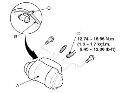

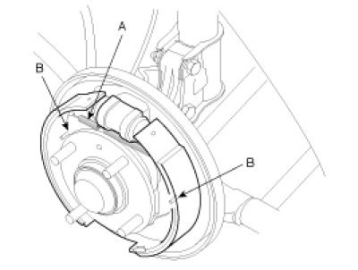

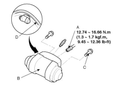

6. Disconnect brake tubes(A) from the wheel cylinder(B).
7. Remove the bolt (C) and the wheel cylinder(B) from the backing plate(D).
pic 3

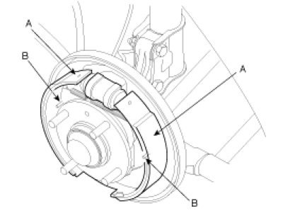

1. Apply sealant (C) between the wheel cylinder (A) and backing plate (B), and install the wheel cylinder.
pic 4
2. Connect the brake tubes (D) to the wheel cylinder.

4. Clean the threaded portions of adjuster sleeve (A) and push rod female (B). Coat the threads of the adjuster assembly with grease. To shorten the clevices, turn the adjuster bolt (C).
pic 5
5. Hook the shoe adjuster lever, then install it to the brake shoe.
6. Install the adjuster assembly and upper return spring (D) as right direction. Be careful not to damage the wheel cylinder dust covers.
7. Install the lower return spring (E).

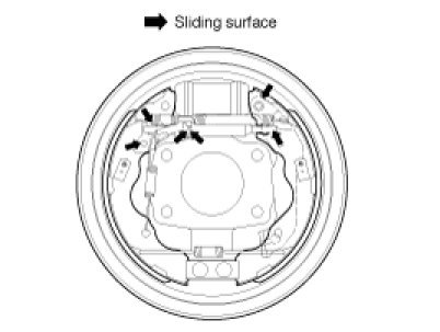

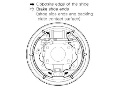

8. Apply brake cylinder grease or equivalent rubber grease to the sliding surfaces shown. Don't get grease on the brake linings.
pic 6
9. Apply brake cylinder grease or equivalent rubber grease to the brake shoe ends and opposite edges of the shoes shown. Don't get grease on the brake linings.
pic 7
10. Install the brake shoes (A) onto the backing plate. Be careful not to damage the wheel cylinder dust covers.
11. Install the shoe hole down pins (B) and the shoe hole down springs.
pic 8
12. Install the brake drum.
13. If the wheel cylinder has been removed, bleed the brake system.
14. Depress the brake pedal several times to set the self-adjusting brake.
15. Adjust the parking brake.

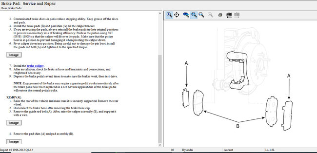

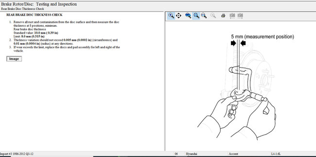

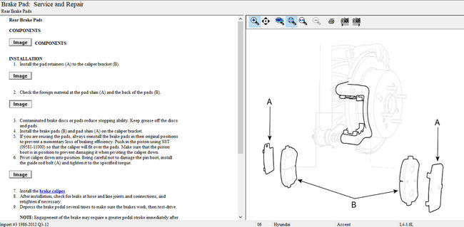

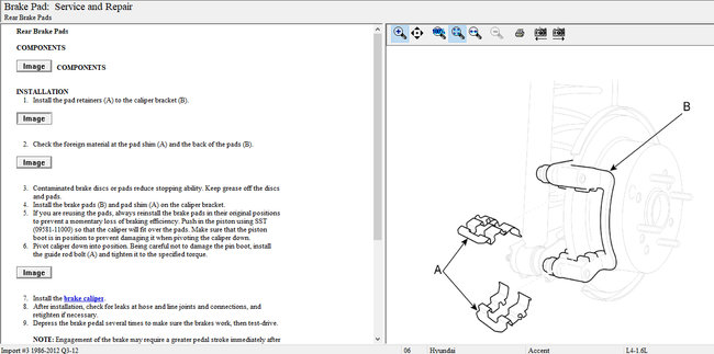

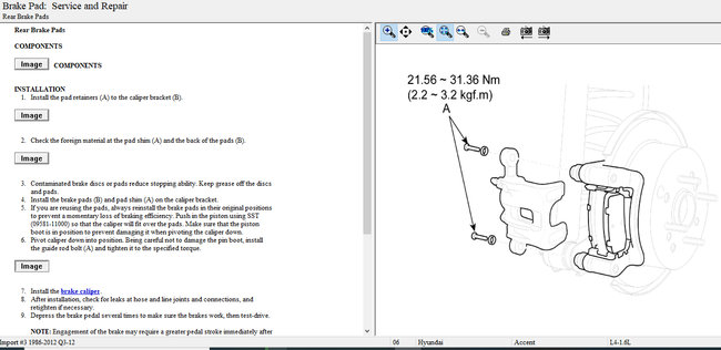

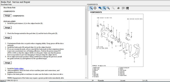

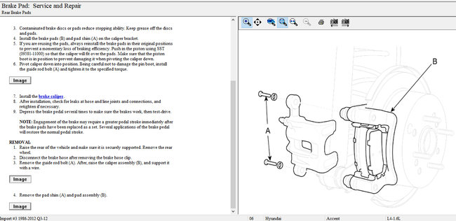

Check out guide below how to replace rear brake pads and discs.
https://www.2carpros.com/articles/how-to-replace-rear-brake-pads-and-rotors

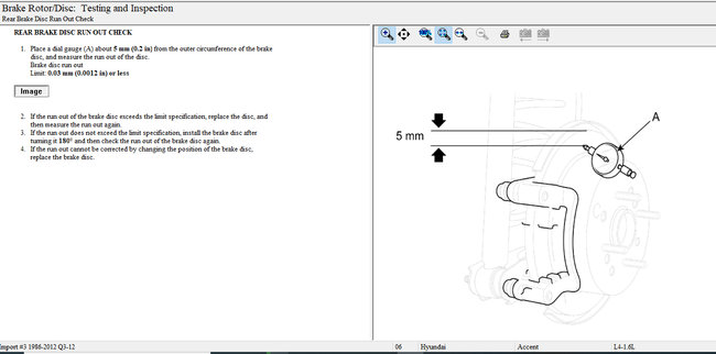

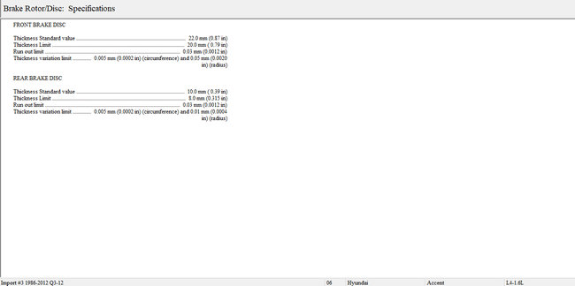

Check the diagrams below how to replace rear pads and discs .how to measure discs runout and thickness.
hope these helps.
thank you.

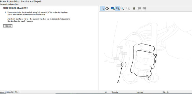

I cant seem to get my rear brake drum off. I dont want to break anything so untill i am certain what to do i havent been to forcefull. I removed the tire now what to get the drum off thanks
Feb 26, 2021 at 11:27 AM (Merged)
BMRFIXIT
  • 19,053 POSTS
Remove tire Spray penetrating oil on the drum center use a hammer and tap around the drum, which should free the drum and allow you to pull it out
