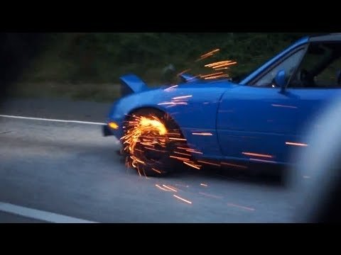

Hi I have recently been working in one of my clients car. She said lots of sparks and fire was coming out when she press the brakes. It's the first time that i heard about this. Can i please know why does that happen and do i have to change the pads for it or the rotors?
Thanks for the help by the way.
Just like the one in the image.

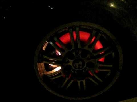

JOHNJY56
  • 43 POSTS
I took a picture of the pads as well after the car stopped.
Mar 16, 2020 at 2:14 AM
She is super overheating the brakes.
I would send her on her way. You will live with that car forever due to her bad driving habits.
Send her to the dealer.
