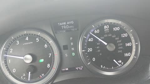

Hello, I'm having a small problem from what I am noticing. The issue that I am noticing is when I am driving the car and trying to slow down the car pulsate exactly when my speedometer touches 5 MPH then I pump the brakes and the pulsation goes away.
Things that I have done are: replaced front rotors, front pads, back rotors, back pads. I already made sure there is no air in my brake line. I had to check professionally they couldn't find anything I have not gone to the dealer yet.
I have checked up Google as well to see if I can find anything. I looked at all my calipers to make sure nothing was getting stuck and didn't see anything obvious I already cleaned my ABS sensors for front right. now I'm at lost on what to check next or if anything lastly I do not have any engine light or ABS light. thank you

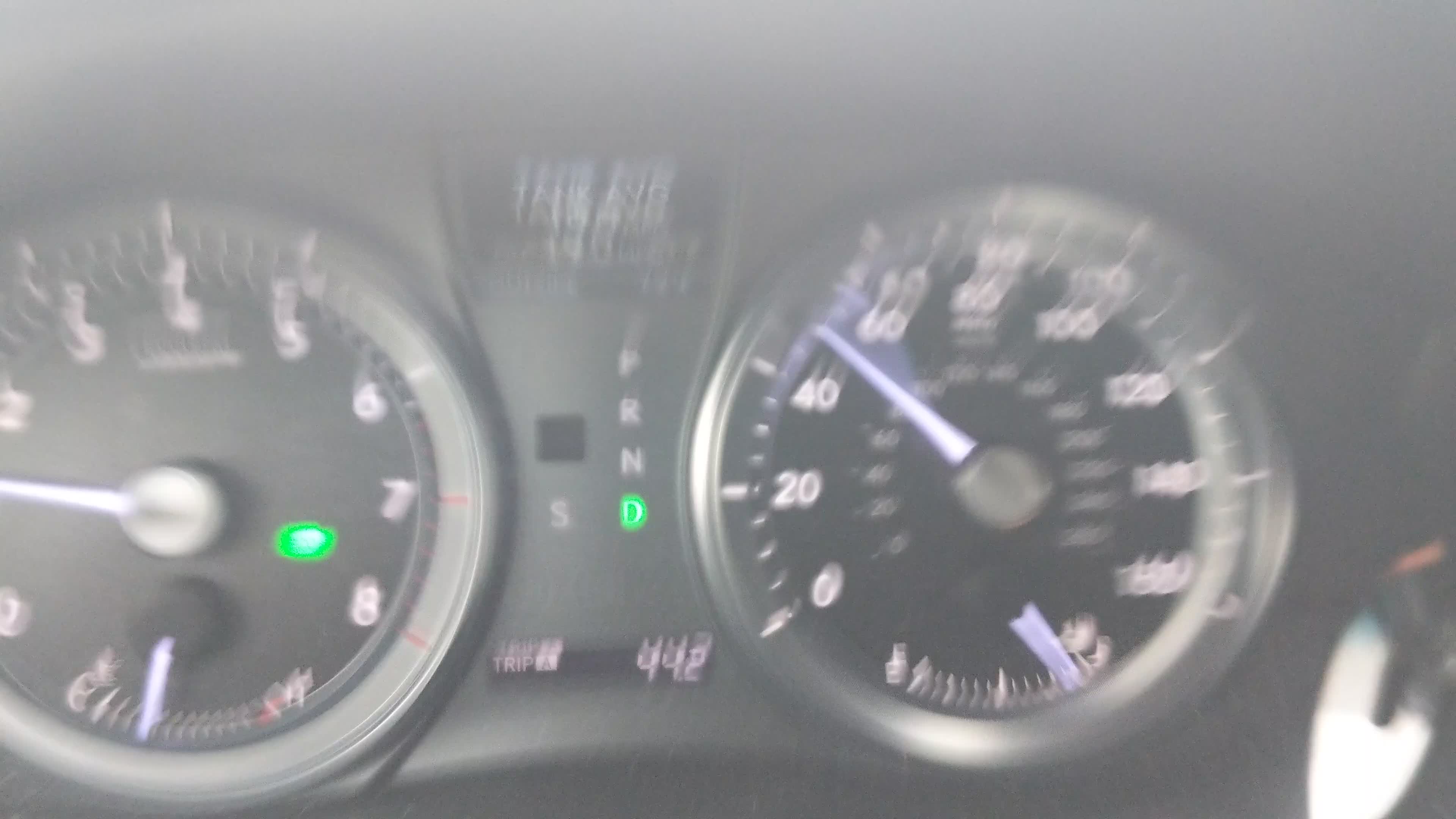

Please see the video and I hope you hear the pulsation. Also I did not see any pulling to either direction when the car stop or pulsation occurred.

I think you forgot to upload the video.

3rd time :)
Jun 14, 2021 at 11:51 AM
94 TRANSAM
  • 680 POSTS
If what I think I heard in the the less than 1 second it lasted did sound like the ABS engaging.
Have you retrieved the codes yet?
