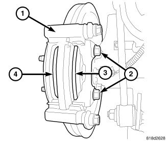

Fluid level was low but filled. Then I heard grinding coming from the rear I did some checking and need to replace the rear brakes.
Sep 11, 2019 at 3:11 PM
  • 110,194 POSTS
Replacing rear brake pads and rotors really isn't too hard. If you do it yourself, make sure to get lifetime parts so you won't have to pay for them again in the future. Also, you can expect rear brake pads to last approximately 30,000 miles. However, that varies based on driving habits and terrain.
To start, here is a link that shows in general how it is done. You can use this as a guide.
https://www.2carpros.com/articles/how-to-replace-rear-brake-pads-and-rotors
Next, here is a video showing it being done on a Dodge Nitro. Although it is a different vehicle, the procedure is similar.
https://youtu.be/GwU7nfBaRr0
Here are the directions specific to your vehicle for replacement. The pics below correlate with the directions.
___________________________________________
2010 Jeep Truck Wrangler 4WD V6-3.8L
Brake Pads - Removal (Rear)
Vehicle Brakes and Traction Control Disc Brake System Brake Pad Service and Repair Removal and Replacement Brake Pads - Removal (Rear)
BRAKE PADS - REMOVAL (REAR)
REAR DISC BRAKE PADS
pic 1
1. Raise and support vehicle.
2. Remove the wheel and tire assemblies.
3. Compress the caliper.
4. Remove the caliper, (Refer to 05 - Brakes/Hydraulic/Mechanical/CALIPER, Disc Brake - Removal) .
NOTE: Do not allow brake hose to support caliper assembly.
5. Support and hang the caliper.
6. Remove the inboard brake pad (3) from the caliper adapter (1).
7. Remove the outboard brake pad (4) from the caliper adapter (1).

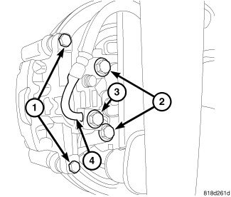

pic 2
1. Bottom pistons in caliper bore with C-clamp. Place an old brake shoe between a C-clamp and caliper piston.
2. Clean caliper mounting adapter and anti-rattle springs.
3. Install anti-rattle springs.
NOTE: Anti-rattle springs are not interchangeable.
4. Install inboard brake pad (3) in adapter (1).
5. Install outboard brake pad (4) in adapter (1).
6. Install caliper, (Refer to 05 - Brakes/Hydraulic/Mechanical/CALIPER, Disc Brake - Installation) .
7. Install wheel and tire assemblies and lower vehicle, (Refer to 22 - Tires and Wheels/Wheels - Standard Procedure) .
8. Apply brakes several times to seat caliper pistons and brake pads to obtain firm pedal.
9. Top off master cylinder fluid level.

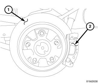

BRAKE ROTOR - REMOVAL (REAR)
REAR
pic 3
1. Raise and support the vehicle
2. Remove the tire and wheel assembly.

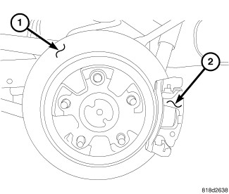

pic 4
CAUTION: Never allow the disc brake caliper to hang from the brake hose. Damage to the brake hose will result. Provide a suitable support to hang the caliper securely.
3. Remove the disc brake caliper adapter (2) (Refer to 05 - Brakes/Hydraulic/Mechanical/ADAPTER, Disc Brake Caliper - Removal) .
4. Remove the retaining clips and rotor assembly.

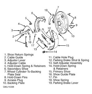

I bought a set of brake shoes for the rear of my Jeep and I noticed that one shoe is a different color from the other. Does it matter which way the shoes are placed when installing them?
Mar 15, 2021 at 1:35 PM (Merged)
MECHCURT
  • 184 POSTS
When placing the shoes on the smaller shoe goes to the front. The color should not be an issue. But look closely at the shoe, one of the shoes surfaces will be just slightly smaller (the pad). Ensure it goes to the front or you will get binding. Let me know if this helps this guide and video should help. This video shows the job being done on a similar car but the process is the same.

any suggestions as to why my brake drums bind after brake job, it only does it after I tighten the lug nuts on the wheel like it is compressing the drum against something. The adjustment screw is as small as it can get also, I can barely turn the wheel after it is tightened. I did try to bleed them but that is not the problem, they are new shoes and drums (I tried to put on the old drum over the new shoes, same problem)
Mar 15, 2021 at 1:36 PM (Merged)
DOCFIXIT
  • 18,828 POSTS
Did you back off parking brake adjustment? see diagram is park brake strut on properly?
