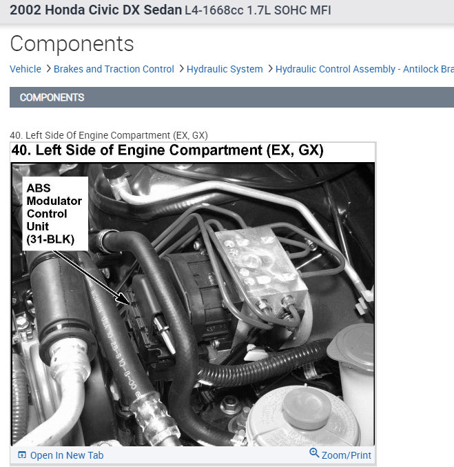

SQM
  • 6,383 POSTS
So, it sounds like due to the flow issue the brake was not engaging properly.
At this point you will have to trace the brake line and see if you see any type of obvious issues, like outside damage. If there are connections you can remove that connection and check for flow again and work toward the module.
Without figuring out the restriction, you won't be able to bleed the brake properly.

IFYUSER
  • 54 POSTS
I only see one connection at the master cylinder for the rear and six at the ABS pump, but they did brake. The brakes were stuck when I installed them, they were too tight in the drum I didn't set them in the grove they where supposed to go.

SQM
  • 6,383 POSTS
Right, those two out of the master cylinder should go to the ABS module and then four will come out of the module for each wheel. I wonder if something just got out of alignment and creating this issue.

IFYUSER
  • 54 POSTS
I figured it out. I disconnected the rear left ABS hose and there was fluid, but it was black. The stuck shoes heated the fluid in the lines plugging the line I'm a clean in with a vacuum.
