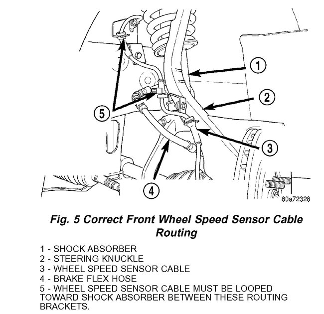

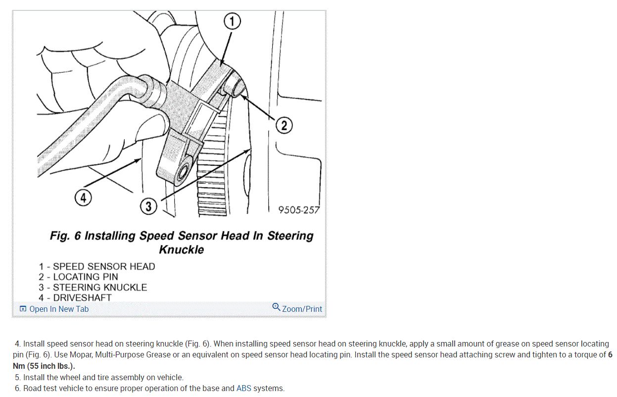

We replaced all four wheels brakes rotors and master cylinder. We bench bled the master cylinder and bled all four wheels according to the manual, not getting any air bleeding out it is clean fluid. The ABS brake light comes on telling me I need the right front wheel speed sensor

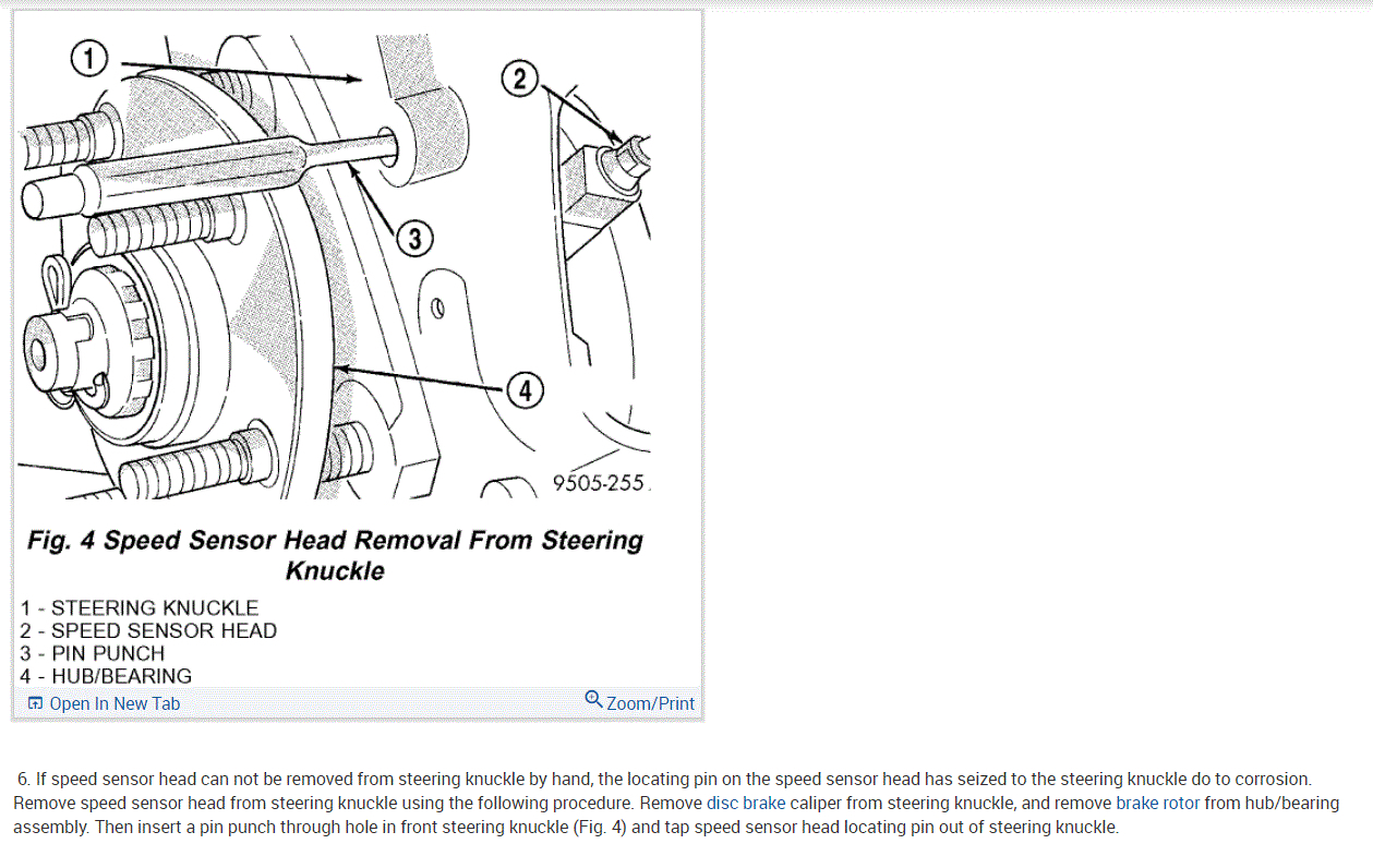

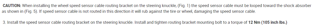

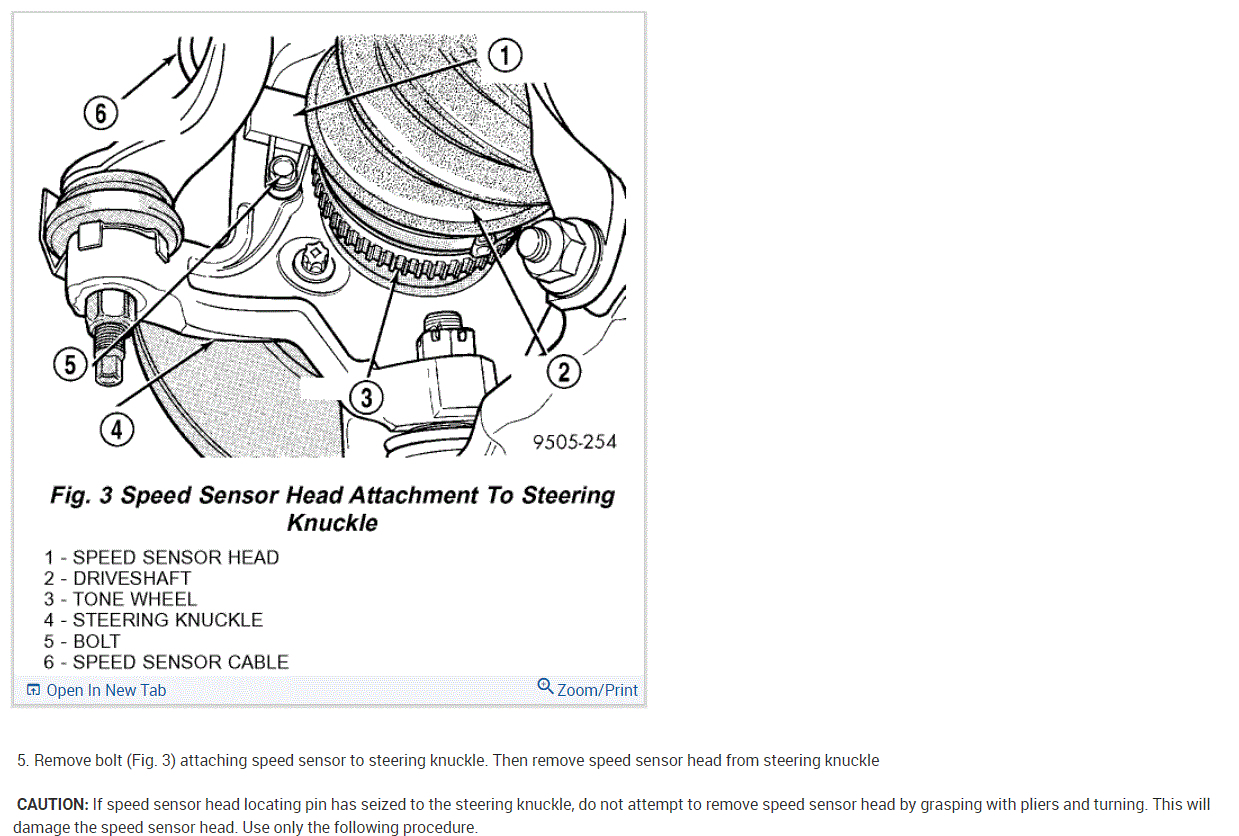

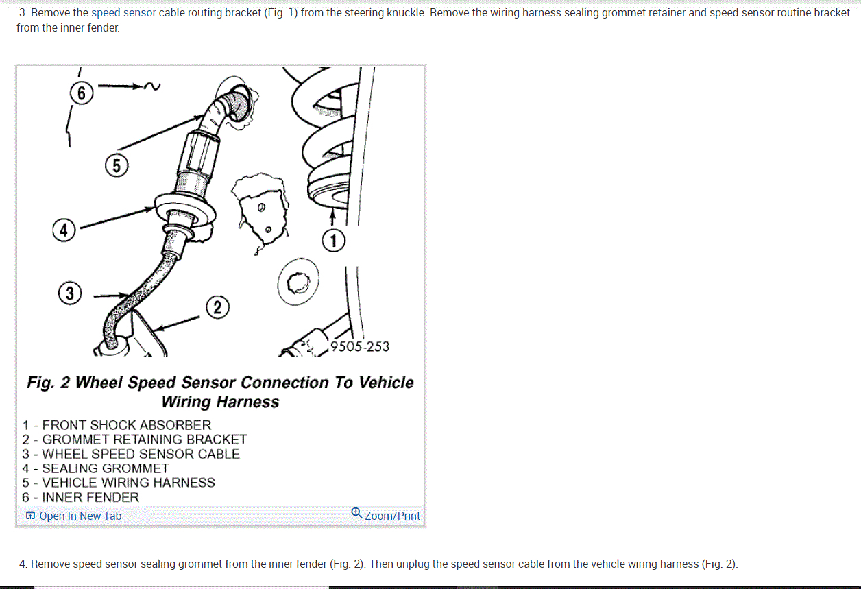

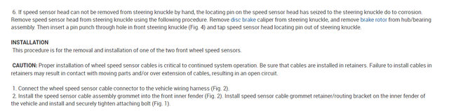

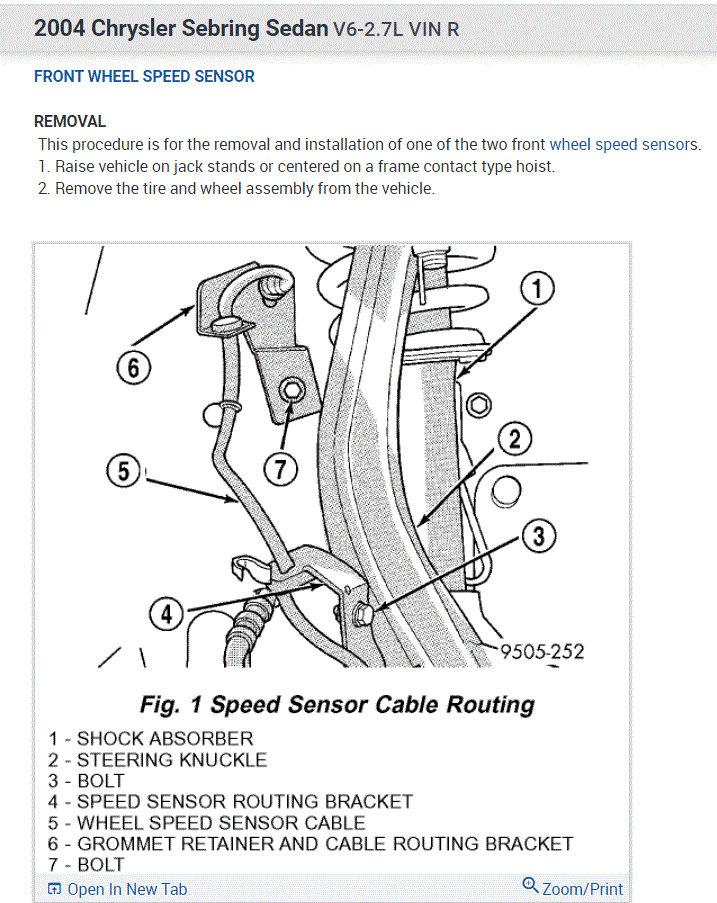

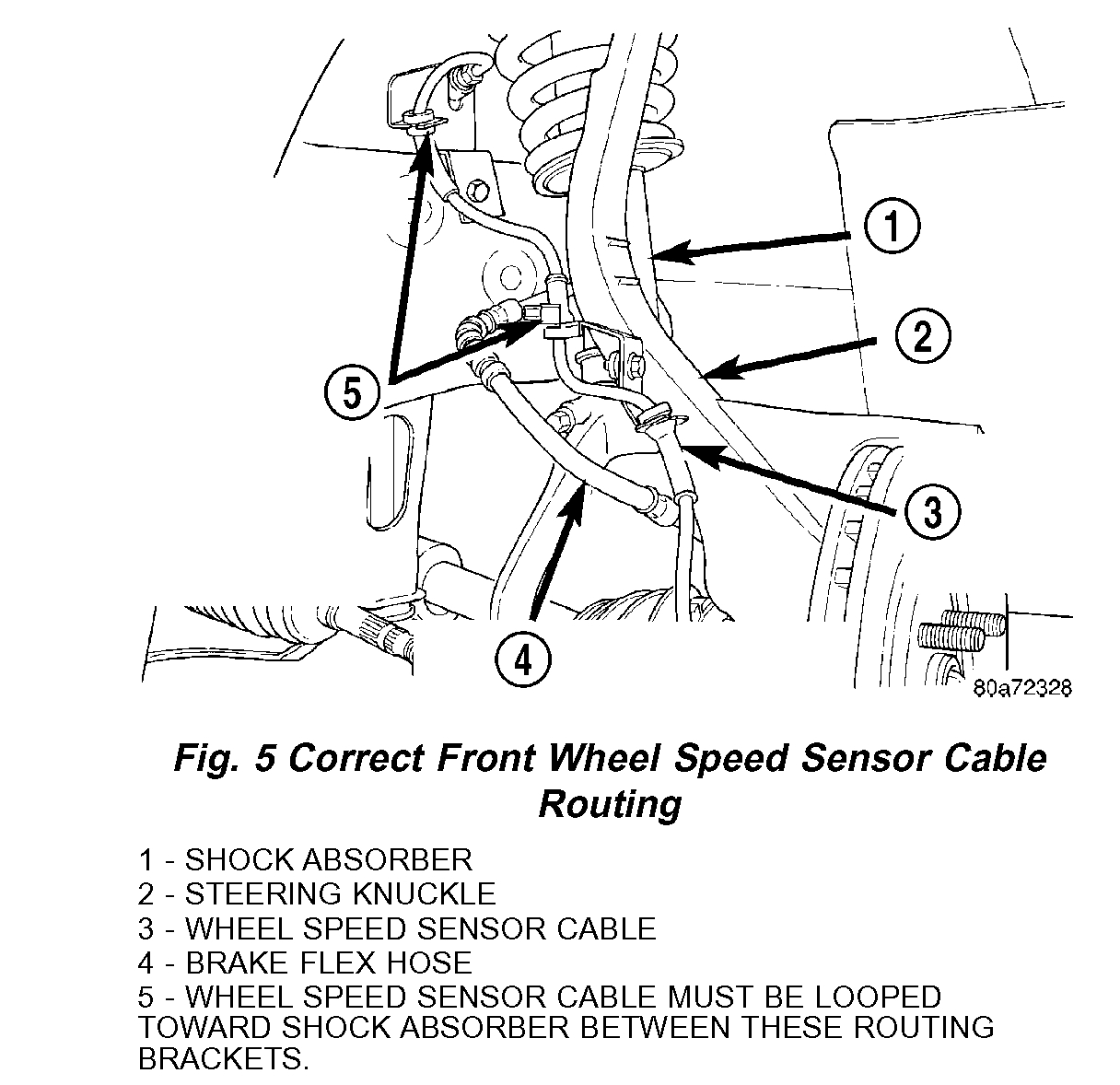

Replacing a front wheel speed sensor isn't too difficult. Make sure the replacement part you get has a lifetime warranty. That way, if it fails you won't have to pay again.
To get you started, here is a link that shows how to perform the procedure in general. You can use this as a guide. Plus, it will make the shop directions easier to understand.
https://www.2carpros.com/articles/how-to-replace-an-abs-wheel-speed-sensor

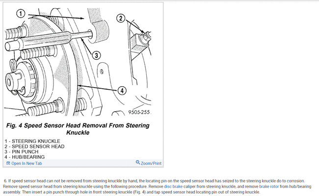

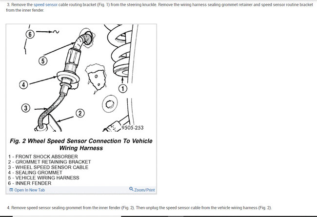

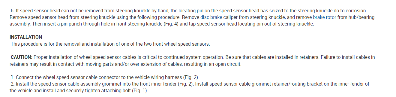

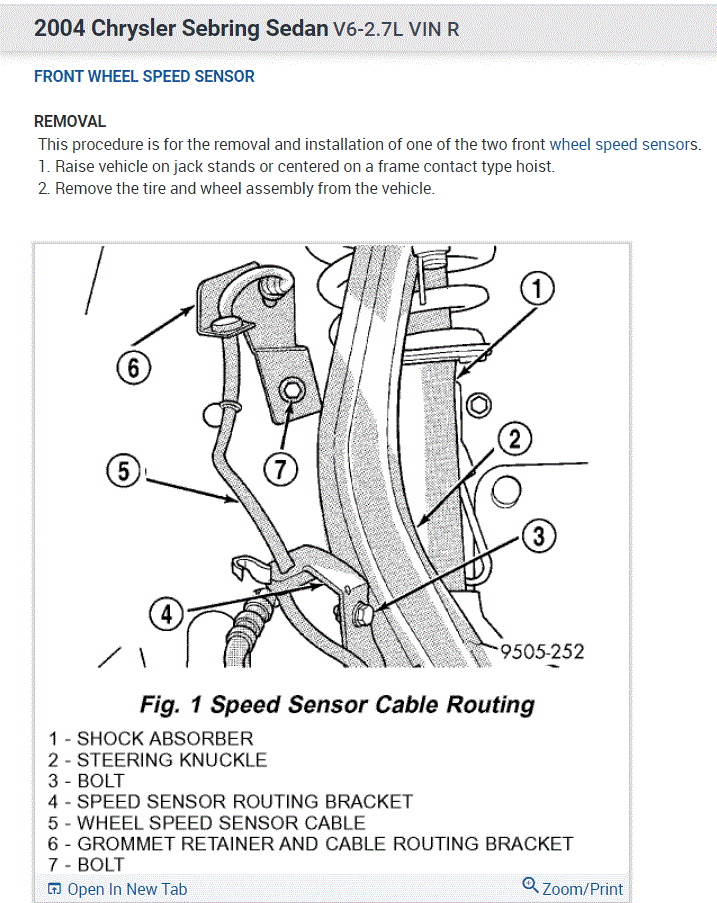

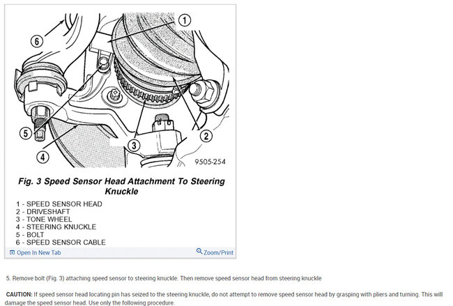

If you look at the attachments, they include the directions and pics specific to your vehicle. Follow these directions.
See pics below
