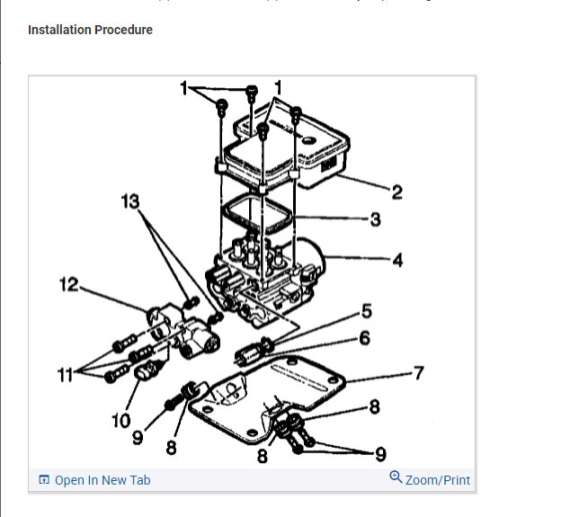

My brake pedal goes to the floor after I replaced the master cylinder and ABS pump. It's getting stiffer somewhat but still goes to the floor. Could the master cylinder be bad too, or could the brake booster be bad? I did not notice any leaks.

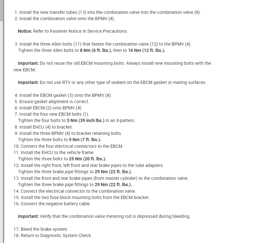

If you did and you replaced the ABS as well, then you need to perform the bleed procedure on this as well.
https://www.2carpros.com/articles/how-to-replace-a-abs-controller
I am attaching the info below but when you are bleeding the brakes after this replacement, you need to make sure the metering rod is depressed in order to bleed it properly.
Please run through this and let us know what you find. Thanks
