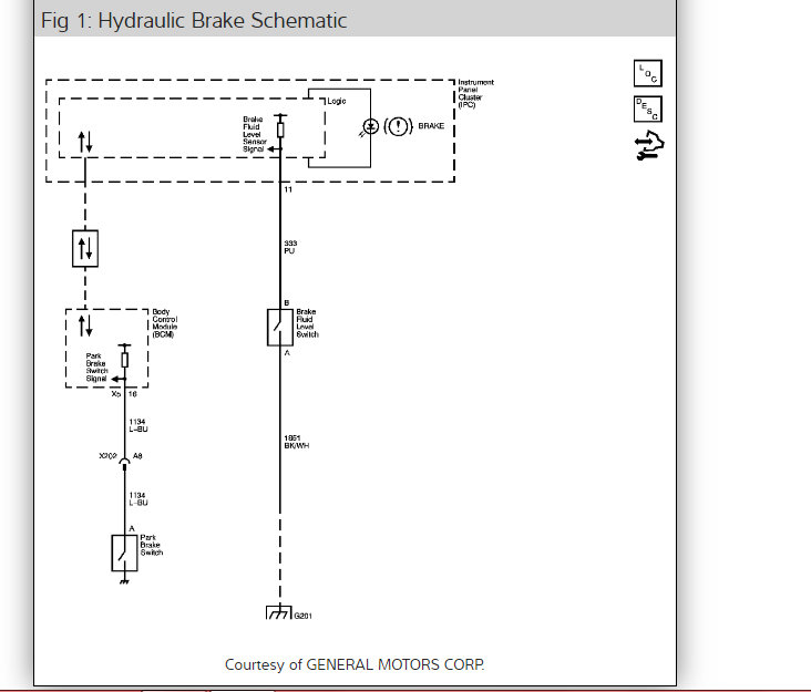

GREG SCHULZ
No check ABS comes on on dash. No fuse issues. I’m at a total loss. Thought it was master brake cylinder but I just replaced it a year ago.
Feb 22, 2021 at 8:37 AM (Merged)
  • 110,244 POSTS
Welcome to 2CarPros.
If there are no leaks or fluid loss, it has to be the master cylinder has failed again. Take a look through this link:

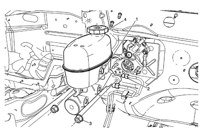

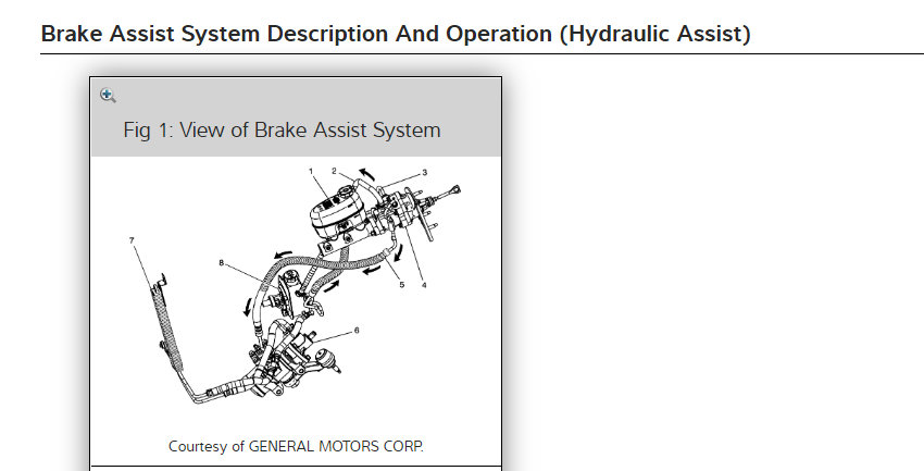

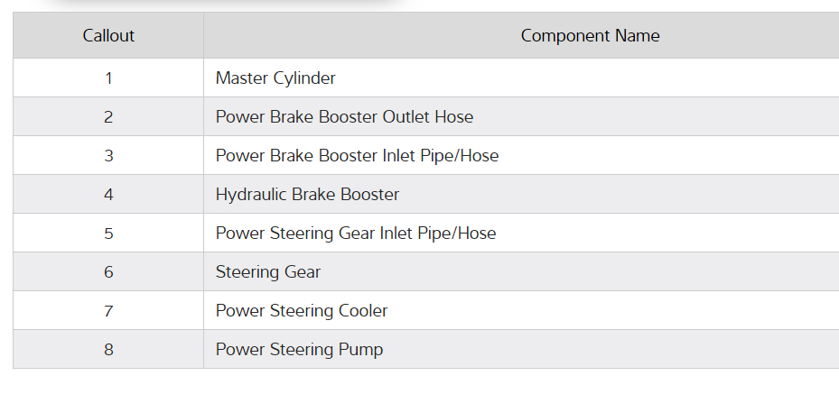

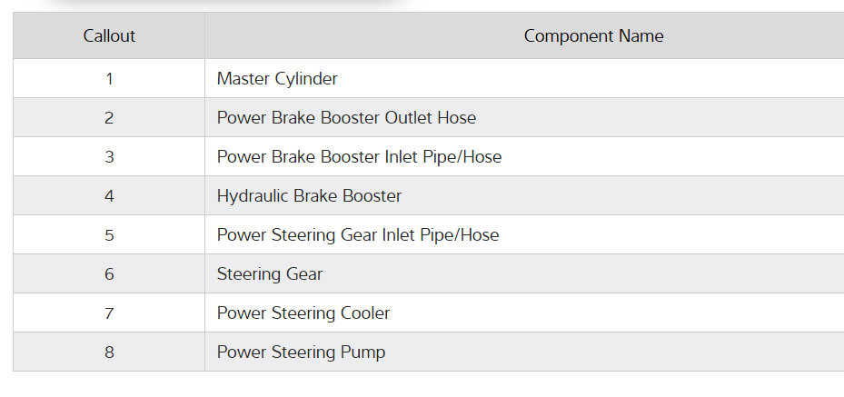

I attached an exploded view of the MC for you to see. Honestly, if there are no leaks and the fluid remains full, this is my first suspect.
Let me know if you have questions or need help.

  • 110,244 POSTS
It went to the floor? In my mind I can't see how that would happen. Not saying it couldn't.

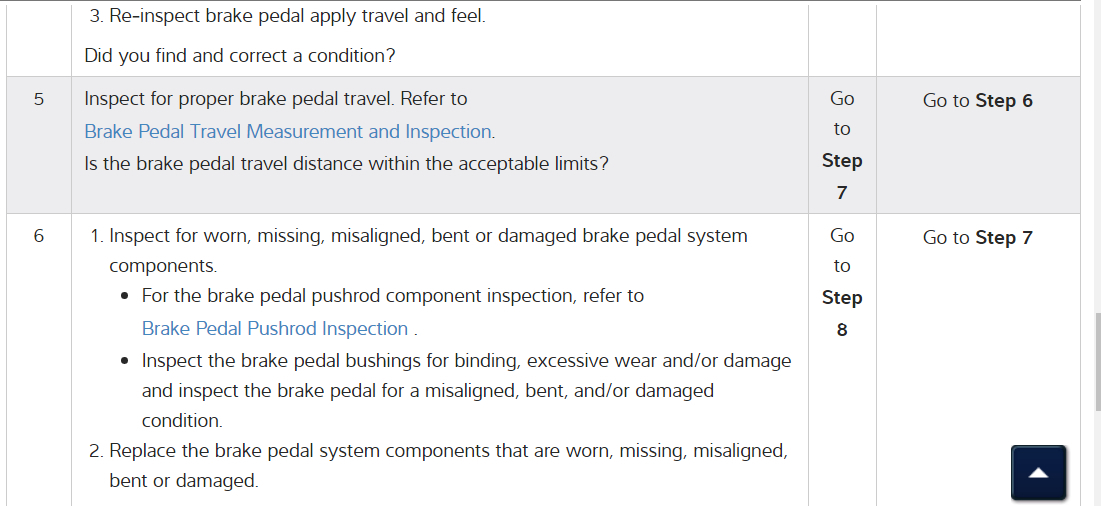

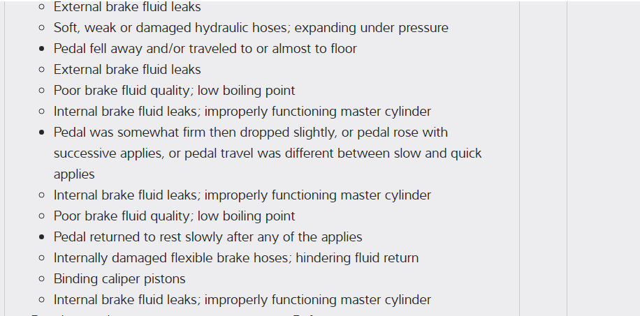

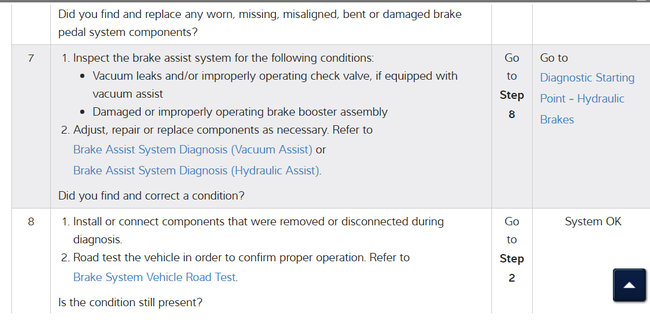

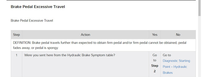

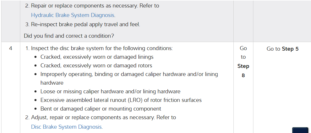

I have also included a factory troubleshooting guide for you down below as well. Please go through these guides and get back to us with what you are able to find out.

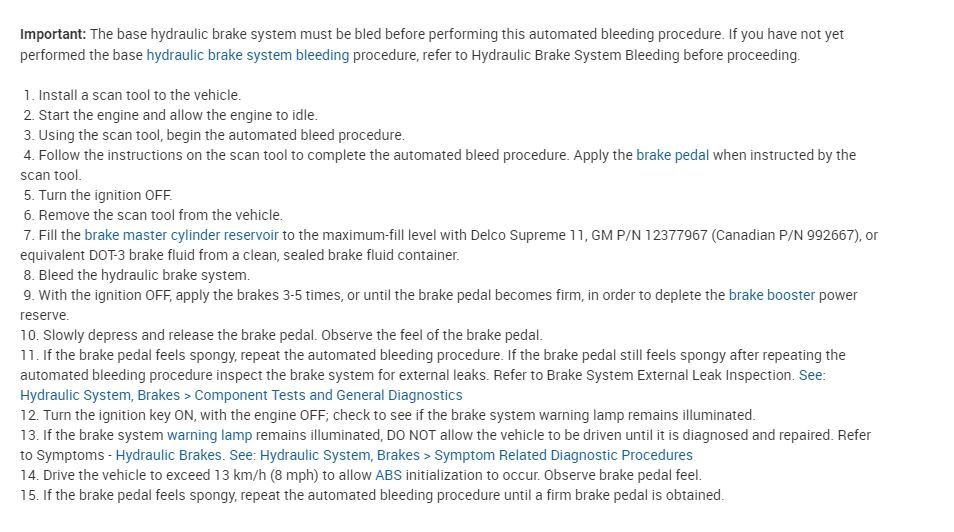

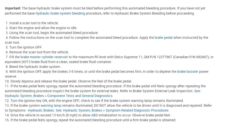

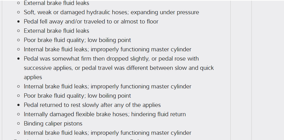

If it is new, then the only thing I can think of is the ABS needs to be bled. It requires a scan tool. Take a look through this and let me know if you have the tools to do it. Note that a standard bleed procedure is required before doing this. You have already done that.
If this doesn't help, I have a feeling you got a bad master cylinder.
If your truck has the vehicle stability enhancement, let me know. There is a different procedure.

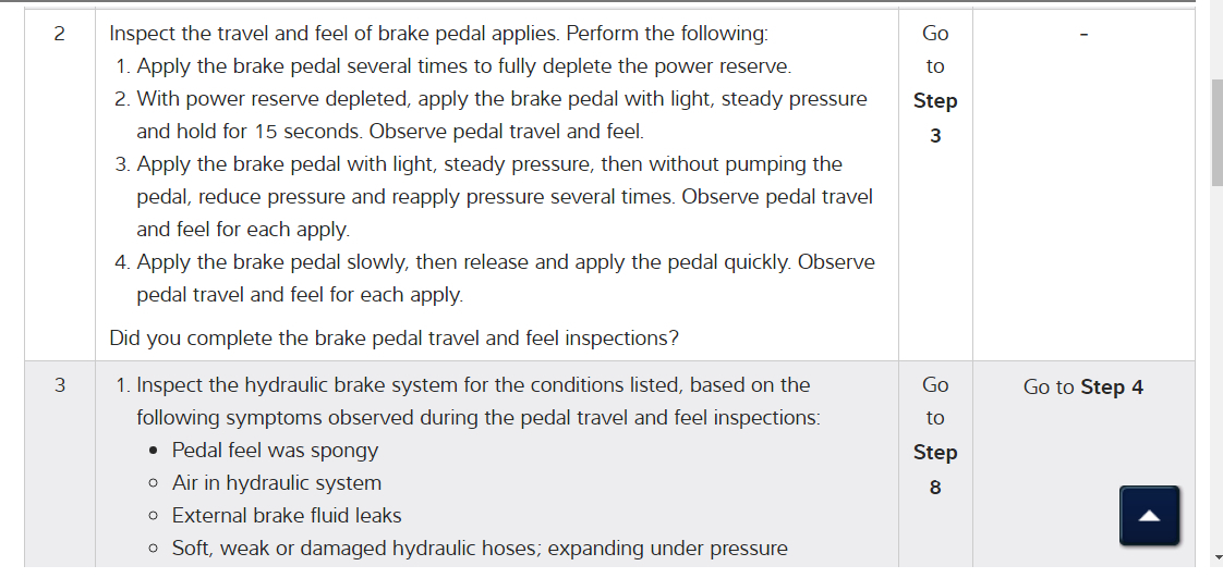

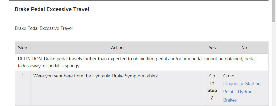

2007 Chevy Truck Silverado 1500 2WD V6-4.3L
(W/O JL4)
Vehicle Brakes and Traction Control Hydraulic System Brake Bleeding Service and Repair Procedures Antilock Brake System Automated Bleed Procedure (W/O JL4)
(W/O JL4)
Antilock Brake System Automated Bleed Procedure (Without JL4)
Notice: When adding fluid to the brake master cylinder reservoir, use only Delco Supreme 11(R), GM P/N 12377967 (Canadian P/N 992667), or equivalent DOT-3 brake fluid from a clean, sealed brake fluid container. The use of any type of fluid other than the recommended type of brake fluid, may cause contamination which could result in damage to the internal rubber seals and/or rubber linings of hydraulic brake system components.
Notice: Refer to Brake Fluid Effects on Paint and Electrical Components Notice.
Important: This procedure may be performed on all vehicles EXCEPT those equipped with option code JL4, Vehicle Stability Enhancement System (VSES).
Important: The base hydraulic brake system must be bled before performing this automated bleeding procedure. If you have not yet performed the base hydraulic brake system bleeding procedure, refer to Hydraulic Brake System Bleeding (Manual) Hydraulic Brake System Bleeding (Pressure) before proceeding.
1. Install a scan tool to the vehicle.
2. Start the engine and allow the engine to idle.
3. Depress the brake pedal firmly and maintain steady pressure on the pedal.
4. Using the scan tool, begin the automated bleed procedure.
5. Follow the instructions on the scan tool to complete the automated bleed procedure. Release the brake pedal between each test sequence.
6. Turn the ignition OFF.
7. Remove the scan tool from the vehicle.
8. Fill the brake master cylinder reservoir to the maximum-fill level with Delco Supreme 11(R), GM P/N 12377967 (Canadian P/N 992667), or equivalent DOT-3 brake fluid from a clean, sealed brake fluid container.
9. Bleed the hydraulic brake system. Refer to Hydraulic Brake System Bleeding (Manual) Hydraulic Brake System Bleeding (Pressure).
10. With the ignition OFF, apply the brakes 3-5 times, or until the brake pedal becomes firm, in order to deplete the brake booster power reserve.
11. Slowly depress and release the brake pedal. Observe the feel of the brake pedal.
12. If the brake pedal feels spongy, repeat the automated bleeding procedure. If the brake pedal still feels spongy after repeating the automated bleeding procedure inspect the brake system for external leaks. Refer to Brake System External Leak Inspection. See: Hydraulic System, Brakes > Component Tests and General Diagnostics
13. Turn the ignition key ON, with the engine OFF; check to see if the brake system warning lamp remains illuminated.
14. If the brake system warning lamp remains illuminated, DO NOT allow the vehicle to be driven until it is diagnosed and repaired. Refer to Symptoms - Hydraulic Brakes. See: Hydraulic System, Brakes > Symptom Related Diagnostic Procedures > Symptoms - Hydraulic Brakes
15. Drive the vehicle to exceed 13 km/h (8 mph) to allow ABS initialization to occur. Observe brake pedal feel.
16. If the brake pedal feels spongy, repeat the automated bleeding procedure until a firm brake pedal is obtained.

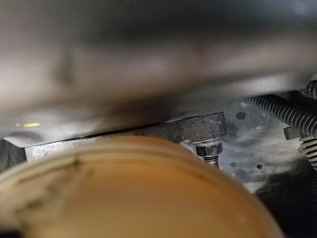

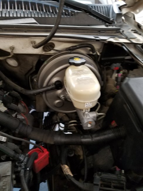

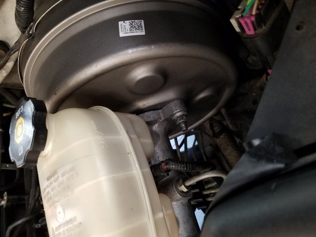

MDBIRD1991
I found that the master cylinder was leaking fluid into the brake booster, I replaced both the master cylinder and brake booster, and have bled the brakes. When the vehicle is not running, the brake system feels to operate normally. However, once I start the engine, the brake pedal easily pushes straight to the floor, and you can hear a hissing near the brake booster/master cylinder area, as if the booster is just sucking in air.

If you did not use a scanner (brake shop/dealer) to open up the ABS system valves for bleeding, you probably still have air in the system.
This would make the pedal be low. With the pedal being way down the booster will hiss.

MDBIRD1991
Thank you for the assist. It ended up being that the new master cylinder that I had installed was faulty. I replaced the master cylinder again, and bled the brakes, which resolved the issue, I haven't had any issue since. The link you gave me, turned me on to testing the new master cylinder that I had previously installed, and it failed. Thank you once again.
Feb 22, 2021 at 8:38 AM (Merged)

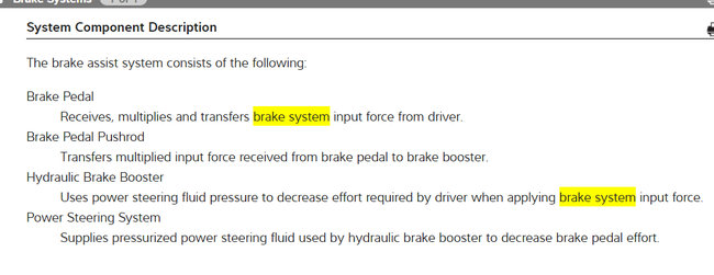

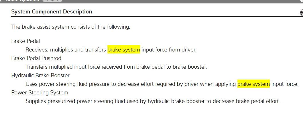

The brakes can be pushed to the floor and it does not stop the vehicle. Dashboard display reads "check brake system". There is pressure when the vehicle is off. The truck has brake fluid. There was not any squeaking prior to this.
CARADIODOC
  • 34,383 POSTS
If you are not losing any brake fluid from the reservoir, a defective master cylinder is the likely suspect. It is normal and acceptable for the fluid level to not be at the top. That is simply a sign the brakes need to be inspected in the near future for normal wear. Do not add any brake fluid as long as the level is above the "Min" mark.
If the fluid level is going lower as you pump the brake pedal, there is an external leak that must be diagnosed and repaired. You will see a wet spot or puddle someplace underneath the truck. Also, be aware that on any vehicle more than about a year old, running the brake pedal all the way to the floor, regardless of the cause, will often damage the master cylinder due to the crud and corrosion that build up in it over time. It is not unusual to need a replacement master cylinder in addition to the original repair.

Good afternoon.
Did you use the procedure with a scan tool to bleed the system?
ABS Automated Bleed Procedure:
Notice: When adding fluid to the brake master cylinder reservoir, use only Delco Supreme II , GM P/N 12377967 (Canadian P/N 992667), or equivalent DOT-3 brake fluid from a clean, sealed brake fluid container. The use of any type of fluid other than the recommended type of brake fluid, may cause contamination which could result in damage to the internal rubber seals and/or rubber linings of hydraulic brake system components.
Notice: Refer to Brake Fluid Effects on Paint and Electrical Components Notice in Service Precautions.
Important: The base hydraulic brake system must be bled before performing this automated bleeding procedure. If you have not yet performed the base hydraulic brake system bleeding procedure, refer to Hydraulic Brake System Bleeding (Manual).
8. Fill the brake master cylinder reservoir to the maximum-fill level with Delco Supreme II GM P/N 12377967 (Canadian P/N 992667) or equivalent DOT-3 brake fluid from a clean, sealed brake fluid container.
9. Bleed the hydraulic brake system. Refer to Hydraulic Brake System Bleeding (Manual).
15. Drive the vehicle to exceed 13 kph (8 mph) to allow ABS initialization to occur. Observe brake pedal feel.

You may have to do it several times. Tthen also do the manual bleed as well.
If you still have no pedal, you may need a pressure bleeder. You will have to force the air out of the system with pressure. You can rent one at a parts store.
