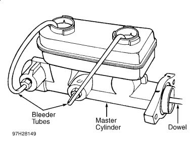

Master Cylinder (Bench Bleeding) 1. Bench bleed master cylinder before installation. Place master cylinder in soft-jaw vise. Install bleeder tubes in both outlets of master cylinder. See Fig. 1 . 2. Fill master cylinder with clean brake fluid. Ensure ends of bleeder tubes are submerged in brake fluid. 3. Using a wood dowel, apply and release master cylinder until no air bubbles exist in brake fluid flow. Leave bleeder tubes installed on master cylinder during installation. Install master cylinder. Remove bleeder tubes, and connect brakelines. Bleed brake system if necessary.
