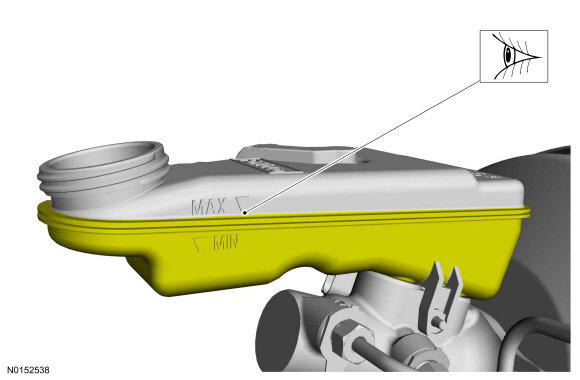

NOTE: Make sure the area around the master cylinder cap is clean and free of foreign material.
Pic 1
Fill the reservoir with clean, specified brake fluid. Refer to Specifications in this section.

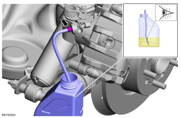

NOTE: Master cylinder pressure bleeder adapter tools are available from various manufacturers of pressure bleeding equipment. Follow the instructions of the manufacturer when installing the adapter.
Install the bleeder adapter to the brake master cylinder reservoir and attach the bleeder tank hose to the fitting on the adapter.
NOTE: Make sure the bleeder tank contains enough specified brake fluid to complete the bleeding operation. Refer to Specifications in this section.
Open the valve on the bleeder tank.
Apply 207-345 kPa (30-50 psi) to the brake system.

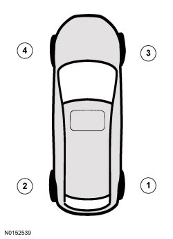

With the vehicle in NEUTRAL, position it on a hoist. Section 100-02 .
Bleeding steps must be followed in the order indicated in the graphic.

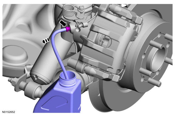

Loosen the bleeder screw 180° and leave open until clear bubble free brake fluid flows and then tighten the bleeder screw.

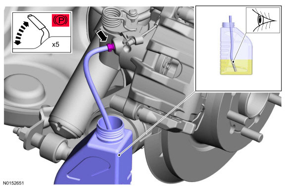

Vehicles with rear integral parking brake calipers
NOTE: Due to the complexity of the fluid path within the rear integral parking brake calipers, it is necessary to press and release the parking brake during the bleed procedure.
Apply and release the parking brake 5 times. Loosen the rear bleeder screw. Leave open until clear, bubble-free brake fluid flows, then tighten the rear bleeder screw.
Repeat until clear, bubble-free fluid comes out.

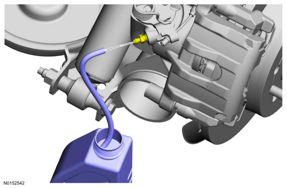

Tighten the bleeder screw to specification. Refer to Specifications in this section.
Remove the fluid container and hose.
