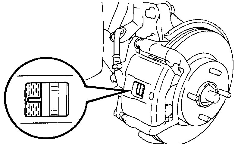

FRONT
Picture 1
BRAKE PAD REPLACEMENT
1. Remove front wheel.
Remove the wheel and temporarily fasten the disc with the hub nuts.

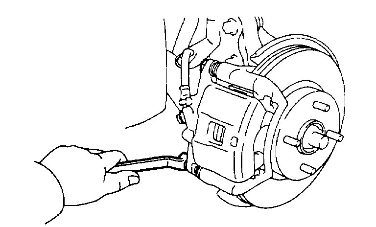

Picture 2
2. Inspect pad lining thickness.
Check the pad thickness through the caliper inspection hole and replace the pads if they are not within the specification.
Minimum thickness: 1.0 mm (0.039 inch)

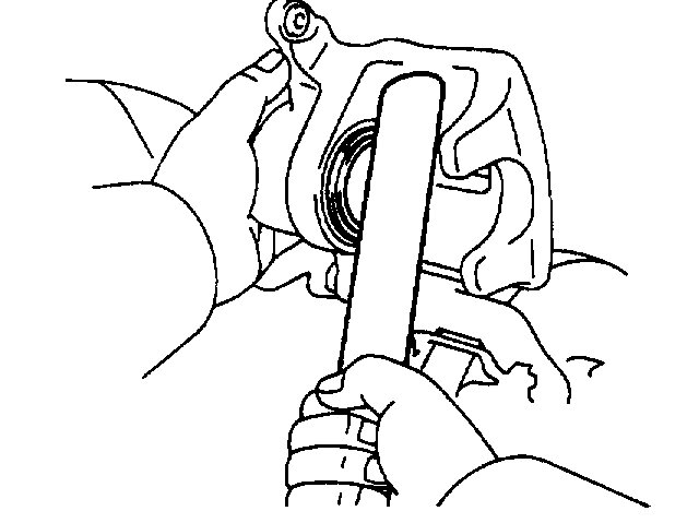

Picture 3
3. Lift up caliper.
a. Remove the bottom side installation bolt.
b. Lift up the caliper and suspend it securely.
HINT: Do not disconnect the flexible hose from the caliper.
4. Remove these parts:
a. 2 brake pads
b. 4 anti-squeal shims
c. 2 pad support plates
d. Pad wear indicator plate.
NOTICE: The support plates can be used again provided that they have sufficient rebound, no deformation, cracks or wear, and have had all rust, dirt and foreign particles cleaned off.
5. Check disc thickness and runout.
Disc Thickness:
- Standard: 22.0 mm (0.866 inch)
- Minimum: 20.0 mm (0.787 inch)
Disc Runout, Max: 0.05 mm (0.0020 inch)

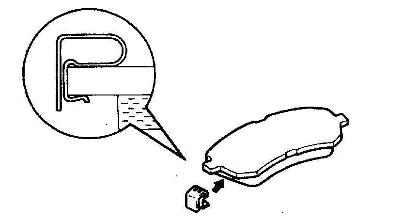

6. Install pad support plates.
Install the 2 pad support plates.
7. Install new pads.
NOTICE:
- When replacing worn pads, the anti-squeal shims must be replaced together with the pads.
- Do not allow oil or grease to get on the rubbing face of the pad.
Picture 4
a. Install a pad wear indicator plate on the inner pad.
b. Apply disc brake grease to both sides of the inner anti-squeal shims.
c. Install the anti-squeal shims to each pad.
d. Install inner pad with pad wear indicator plate facing upward.
e. Install outer pad.

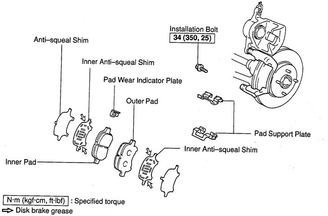

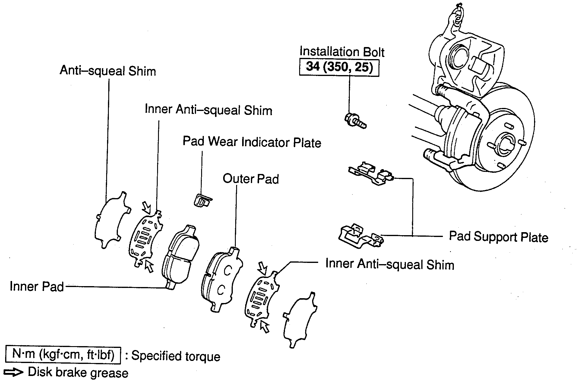

Picture 5
8. Install caliper.
a. Draw out a small amount of brake fluid from the reservoir.
b. Press in the piston with a hammer handle or an equivalent.
HINT: If the piston is difficult to push in, loosen the bleeder plug and push in the piston while letting some brake fluid escape.
c. Install the caliper.
d. Install the installation bolt.
Torque: 34 Nm (25 ft.lb)
9. Install front wheel.
10. Check that fluid level is at Max line.
