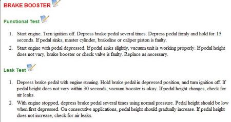

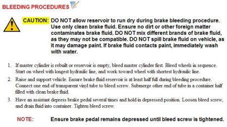

the front brakes on my car on both sides lock up I changed the pads and bled the lines and it still locks up what's going on here?

calipers maybe freezing up causing brakes to lock up

TAKE pads off- try to push in the caliper piston - if they dont push in at all, they are frozen-
you will either need a caliper piston pusher, or take a pair of large pilers/channel locks to squeeze in pistons.
the pistons, (they are round and push on the pad)
should push in pretty easily. Even if they do push in, but are very hard, then they are starting to freeze up.
