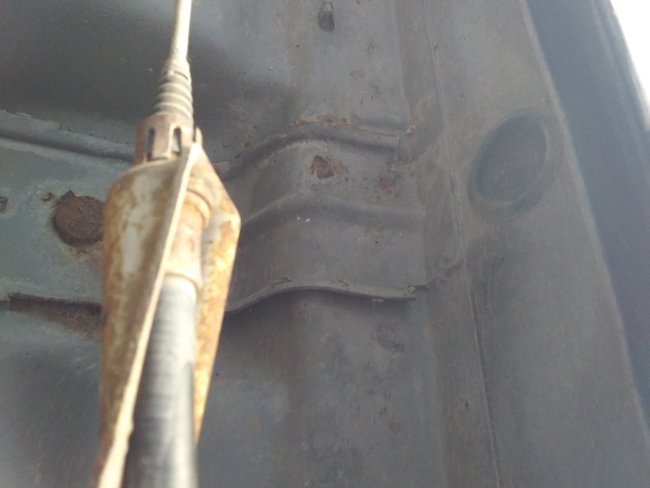

I have a leaking brake line that looks to be connected to my emergency cable line. if this is a correct assessment, who would carry such a line and how difficult would it be to change?

Can you post a photo? Brake fluid is never involved with the parking brake. It is possible the parking brake cable and one of the brake hydraulic lines are tied together, but that would be only to physically hold them up and away from hot exhaust parts and rotating parts.

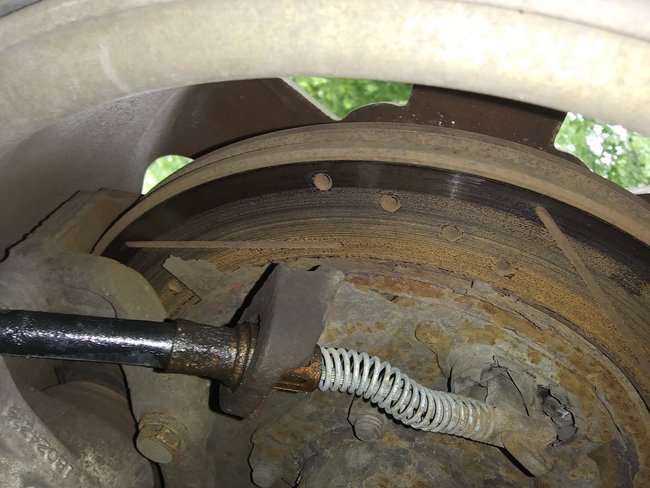

One end is indeed connected to my e-brake, as is the other end. I am including photos of both ends.

Yup, those are the parking brake cable, but there's no brake fluid in them. If that is wetness on the left in the first photo, it has to be dripping down from above, or running sideways from somewhere else.

Okay, guys, live and learn! Found three brake lines directly across from the e brake, have not a clue at this time which is leaking, but by the looks of I, it may be the one closest to the rocker panel. I will keep you posted, as it's going to take a bit to figure it out how to do this without screwing up the other two lines. fingers crossed!! Thanks for your help and support!
