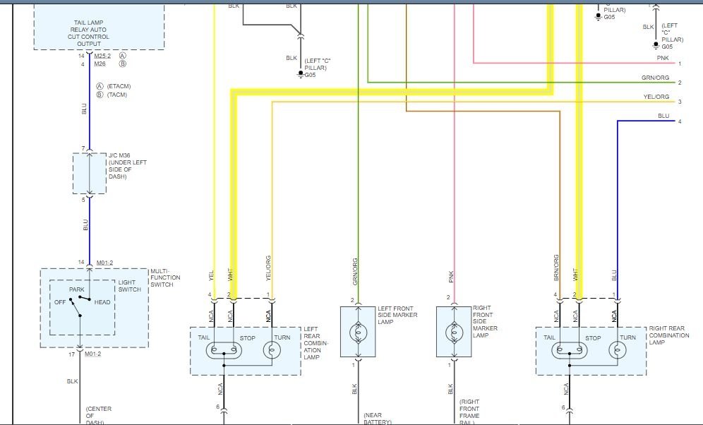

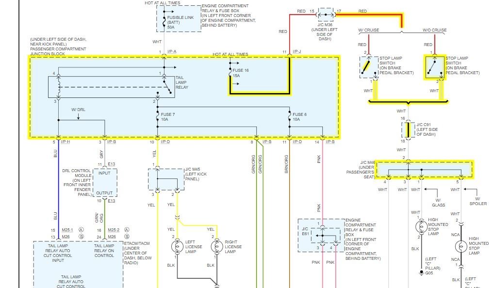

Good morning,
Let us back up. You need to work the problem, not bypass.
Do you have voltage at the stoplight switch? I attached a diagram for you that shows the source of power and the flow.
Let us start with basic checks.
