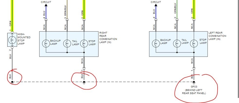

So I replace the brake light switch, both light bulbs in the back and the fuse are good.. once I take out both bulbs in the back the middle light works, but when I put the bulbs back in it stops working.

It sounds like the ground is bad. The grounds for all three lights is common. However, there are splices in them. What I suggest first it to inspect the ground specific to the rear brake lights. I attached a pic. The pic shows the ,main ground for them.
Check that for continuity, make sure it isn't loose or damaged, and check for corrosion.
Let me know what you find. I suspect, the added load of the two additional bulbs is causing the ground to fail. They all get power from the same source, so this is my first suspect.

Okay sir, I check them and they are all good. still not working.
