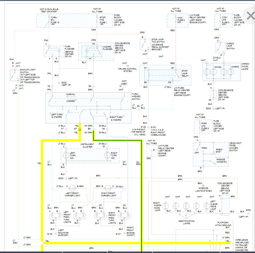

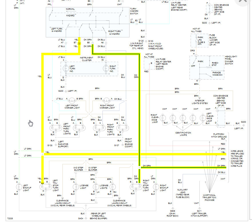

I suspect the turn/hazard switch is shorted which is why the fuses are blowing and the lights are not working.
Take a look at this wiring diagram. If you have not power at the bulb, I would jump back to the switch and test power coming out. If none, you can test the power coming in but I am sure you will have it there. If so, replace the switch.

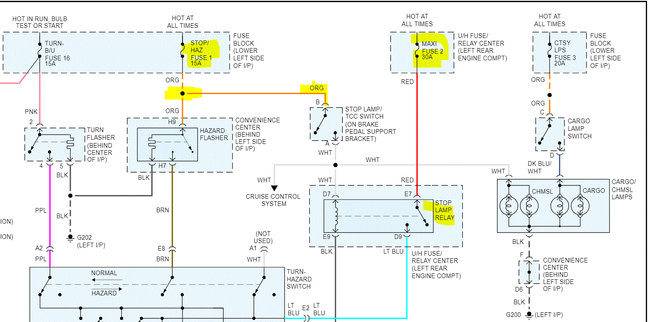

There are two fuses that can cause issues. (See the attached pic) If both fuses are good, confirm there is power to the fuse and out.
There is a splice in the hazard/brake light wiring. If there is power out from the fuse, check at the switch to confirm there is power to the orange wire. If there is, press the brakes and see if there is power out.
Do this and let me know what you find.

I have no power to the switch. I have replaced the tripped/blown 30amp fuse - it did not blow again - and still no power to the switch. I replaced the brake light relay and still no power. I found what I think is the I/P fuse "box", but there are no fuses in it. there is a Hazard relay that I replaced - did determine that there is no power to any of the terminals for the relay. Noticed a bunch of after market alterations under the dash. Loose wires that went through the firewall and then literally went nowhere. Not sure what is going on with this I/P fuse box.
I assume (here I go again!) that the main problem has to have originated with the wiring associated with the blown 30 amp fuse. The wires all look fine that are coming out of the wiring harness under the dash all the way to the brake light switch. The problem must be closer to the fuse panel. It is so daunting trying to find any particular wire in that mess of wiring harness that I bypassed everything. I hooked a wire to the "Auxiliary A" post at the fuse panel - with a corresponding 30amp fuse - passed it through the fire wall and spliced it into the cut orange wire. Behold!! I have brake lights.

First, that was an excellent way to test if power was the problem. I looked at the schematic again and noted that there only appears to be one power wire to the switch, so you should be fine. Also, since that fuse only seems to power the switch, you should remove it. If it blew once, chances are it will again.
As far as the replacement, just make sure nothing can short or easily become damaged. Also, make sure the wire you used is of a heavy enough gauge to handle a 30 amp fuse. You don't want anything too light which will melt down before the fuse blows. Since the wire needs to be approximately 5 feet, I would recommend no lighter than an 8 gauge wire. That is the norm for up to approximately 15' length at 30 amps. I would be happier if you used a heavier 6 gauge, but that's your call.
The red wire from the fuse must have a break in it at some point. If you were to remove the fuse and check continuity, I suspect you would find there is an issue.
