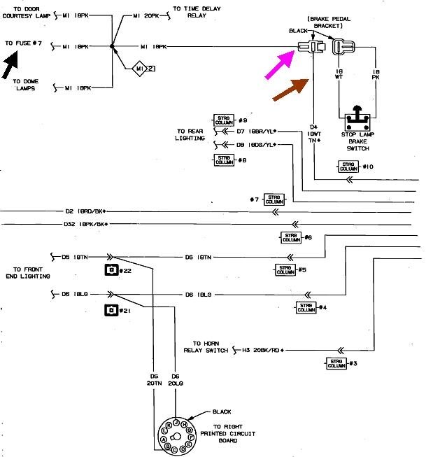

Have a Ram Van with cruise control and no brake lights. The turn tail and hazards all work. glass fuses in glove box all seem good. Just replaced the brake light switch (which has six wires) with a brand new unit and still nothing. bulbs appear good. I'm by myself so i can't easily check for voltage at the bulb socket. looking for more ideas on what it could be. Thanks

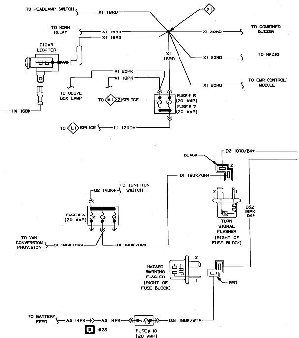

Given the signals work, the best suspect when the brake light on just one side doesn't work is the signal switch. When both brake lights don't work, the better suspect is in what both sides have in common. That still includes the signal switch, but chances are we're going to find the problem is before that. The easiest place to start is right at the new brake light switch shown in the third diagram. Check for 12 volts on the pink wire. That should be there all the time. If it's missing, check for 12 volts on both sides of fuse # 7. Also check if the dome lights work. If they do, fuse # 7 has to be okay.
Next, check for 12 volts on the white / tan wire at the brake light switch when the brake pedal is pressed. If you have it there, check on both sides of the connector at the base of the steering column. That wire is listed as the tenth wire from one end, and it will be white with a tan stripe on one side, and white on the steering column side. If you have it on just one side, one of those mating terminals is stretched, or they overheated and are blackened.

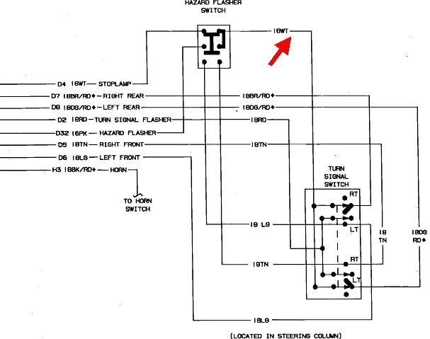

If you have 12 volts all the way to both sides of the connector, the next place is the hazard flasher switch. You'll need to remove the steering wheel to do testing beyond the connector. Check for voltage on the white wire shown with the red arrow in the fourth diagram. If it's missing, the hazard flasher switch is defective. If you have it there, you should also have 12 volts on the dark green / red wire, (left side), and on the brown / red wire, (for the right side).
Beyond those points, the signals share the same circuits, so if the signals work, there's no need to look further back for the brake light problem. You will have found the 12 volts for the brake light circuit missing by this time, then we'll know what it will take for a solution.

CARADIODOC Thank you!! That information was extremely helpful! I ended up checking the switch and after all that it ended up being fuse 7. It is supposed to be a 20A fuse but there was an 8A in there that was popped but not visible to the naked eye. I checked them twice but the third time I checked with a multi-meter and lo and behold it was bad. I had to look up a fuse box diagram to figure out what amp is was supposed to be. My Haynes manual decided that information is not important (there is some good information in there but is heavily lacking and very vague since the manual is meant for 71-2002 vans). I ordered a legit shop maintenance manual for my exact model for any further issues.
