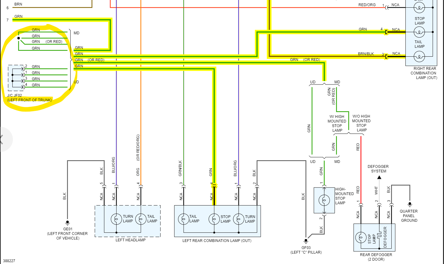

Hello, yes, we can get the wiring diagrams for you. Is this the Elantra Coupe, or GT sub-model? And is it just the Brake lamps on both sides not working? And did this start happening after changing the bulbs? What was the reason for changing the bulbs out if they were working?

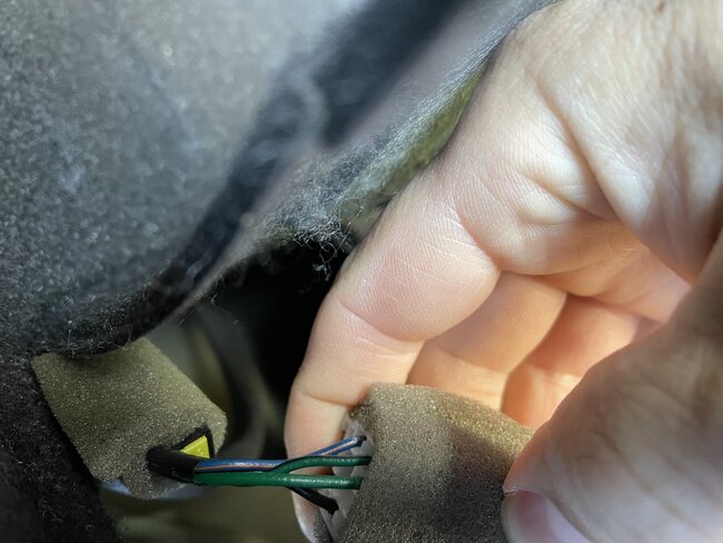

Since your 3rd Brake lamp works, your issue is going to be in this connector or from the connector down the circuit to the brake lamps. This connector is located on the left (driver side) in front of the trunk. The Brake Lamp signal comes into this connector then branches out to all the brake lamps from there. It can't be a Ground issue because the turn signal, third brake lamp, and taillights all share a Ground, unless you have the setup in the third diagram which is the OEM manufactures diagram where it shows a defrost associated with the third brake lamp in which it has its own ground. Thats the only difference.

I was able to unplug the connector and use a test light I had the blinker going and I had the brake pressed and as soon as I touched the male with test light it was blinking the same with the brake so it looks like I will need a new wiring plug. Would you agree? All my lights went out including the third light, so I replaced all of my lights because they were all blown out.

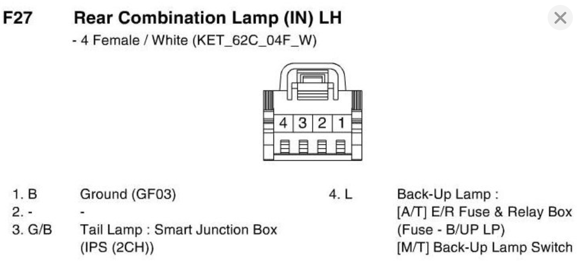

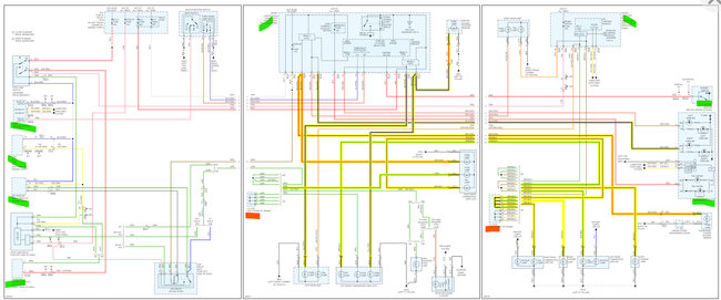

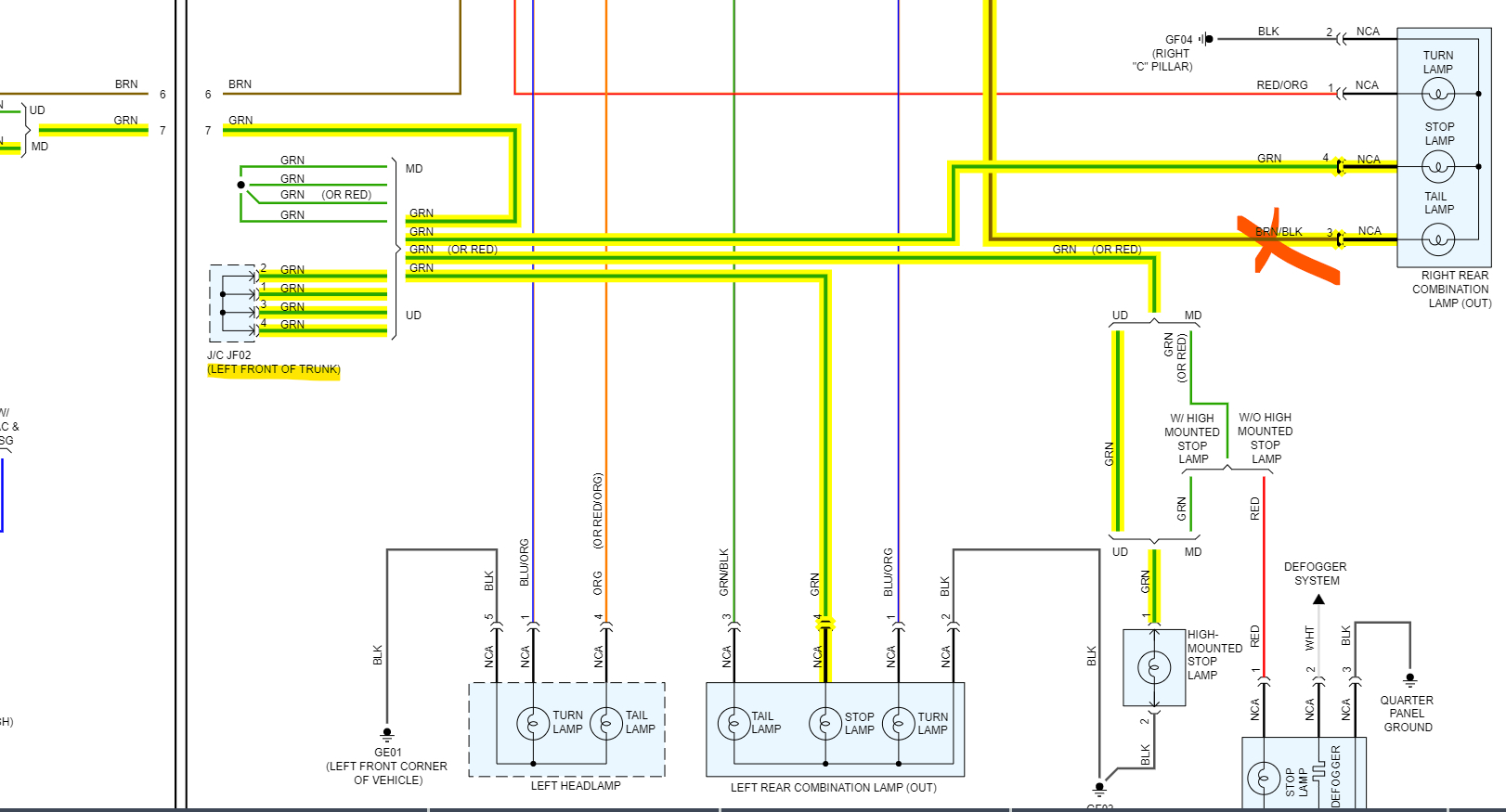

Do you mean that all the bulbs in the rear of the vehicle went out all at the same time? And just so I understand you correctly, you had the Jf02 connector unplugged, were you using the test light in series with the connector, or did you have the test light hooked to a body ground location, and just touching the pins one by one? This Joint connector has 5 pins that are linked together for the brake lights, 1 of those pins is the input and the other 4 are the output pins. But it also does the same for the 4 tail, 2 license plates with 1 feed wire. But it doesn't appear that the Turn signals come through this connector, if you notice pins 11 to 15 says c-can(high), those are computer network data wires. And Im sorry for the delay, but this is a complicated set up. I don't think you need to replace that joint connector unless it is full of corrosion. If the pins are clean. then we have something else going on here. It doesn't look like you should have any Turn signals at those pins. Unless it's feeding back through one of the shared ground connections.
From the Joint connection diagram can you tell me what pins are giving you a turn signal flash? And also explain a bit about the bulbs burning out, did they all burn out at once and when you replaced them, did you look at the bulb and could see the actual filament burnt inside the bulb? I know it's a lot to ask. But if they all stopped working at the same time, that points to some other type of failure.

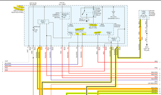

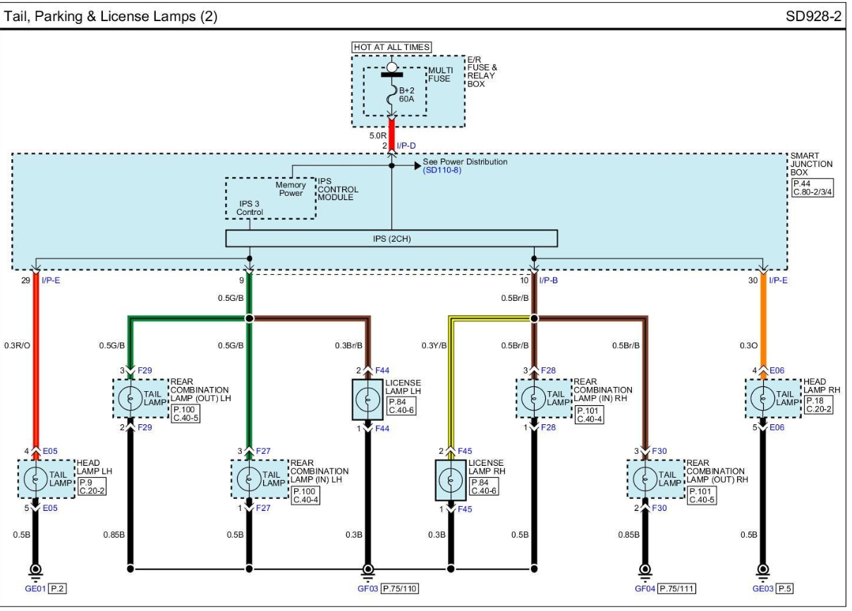

On another diagram I'm looking at the Turn Signals come from the Smart Junction Box (2nd diagram) on the driver side dash. And they don't go through that connector.
Another thing is that the Body Control Module, the Powertrain control module, the Instrument Cluster, the AC control module, Electronic Steering module, and a couple of these Smart Junction boxes are all part of the exterior lighting system and communicate together on the can-c network bus.
So, if all the lights quit together at the same time, I don't think it was just a matter of bulbs burning out all at once.
The 3rd diagram shows just the exterior lighting system and every green mark is a module(computer) and the reddish mark is that connector.
I'm going to go through and look for any Technical Bulletins on this as well.

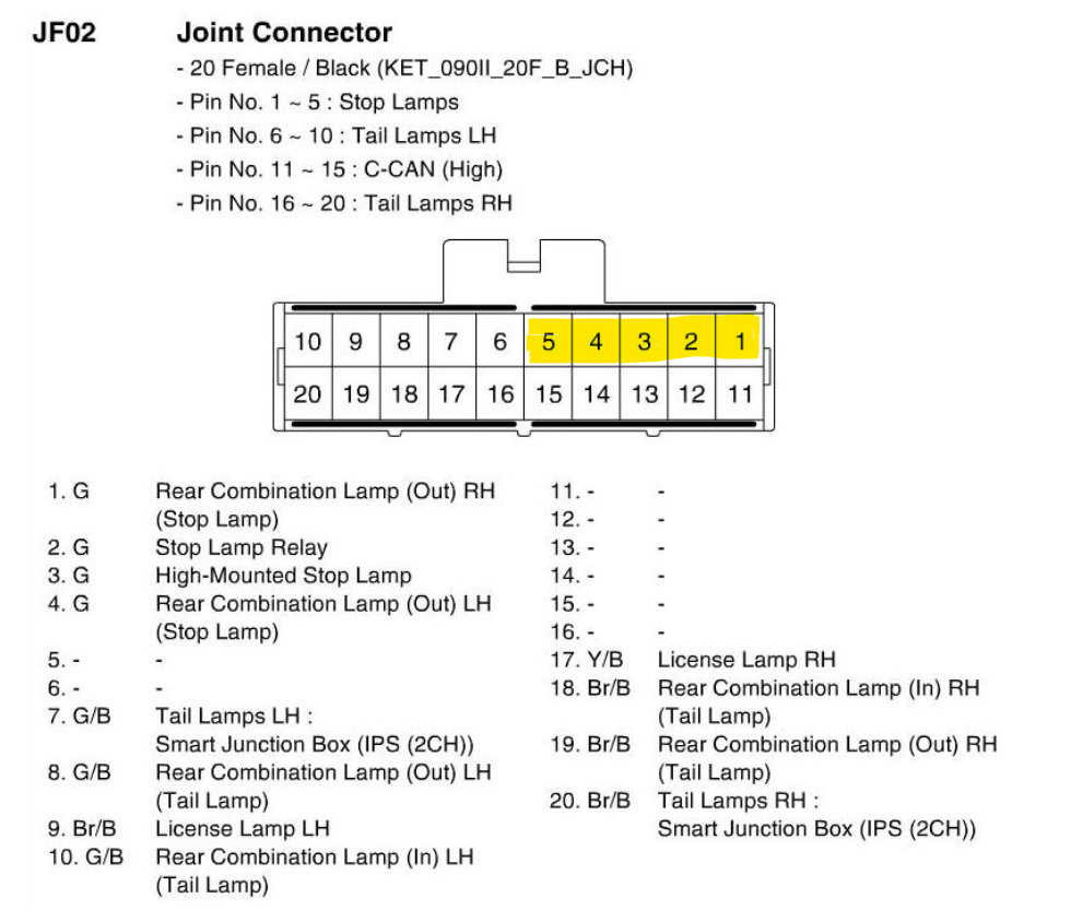

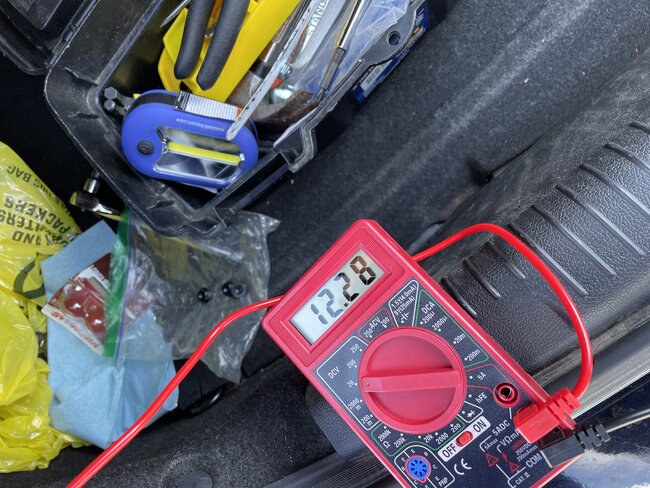

With the JF02 connector the feed from the Brake lamp relay will be pin 2. So, with the connector plugged in if you were to back probe the connector to check for voltage getting to the connector and then through it, you should have battery power 12v on pins 1 to 5 with the brake pedal depressed. With the tail/marker lights on you should have 12v on pins 6 to 10 for the left side and then also pins 16 to 20 for the right side. Pins 11 to 15 is the c-can bus and that will have a bias voltage of 2.5v. If using a multimeter, you might catch the can bus wires jumping up to 3.5v extremely briefly if at all because of how fast the data packets travel on the network.
But if you back probe the connector plugged in and you're getting the correct voltage readings on all the wires, then we will know that voltage is at least reaching that point. And using a multimeter the best thing to do is do a voltage drop test from the connector to the brake light bulb socket and see if there's a loss of voltage anywhere from the connector to the brake light assembly. Checking when the lights are on is the proper way to check because the circuit will be loaded at that point and carrying current. I'm going to try to find out what the data wires are for in that connector. I believe c-can is medium speed used for body and chassis controls.
But check the plug connected and see what you have there. Use a multimeter if you have one. If not, you only need a basic meter that can read dc volts up to 20v. You can get a meter cheap, about twenty dollars or less.

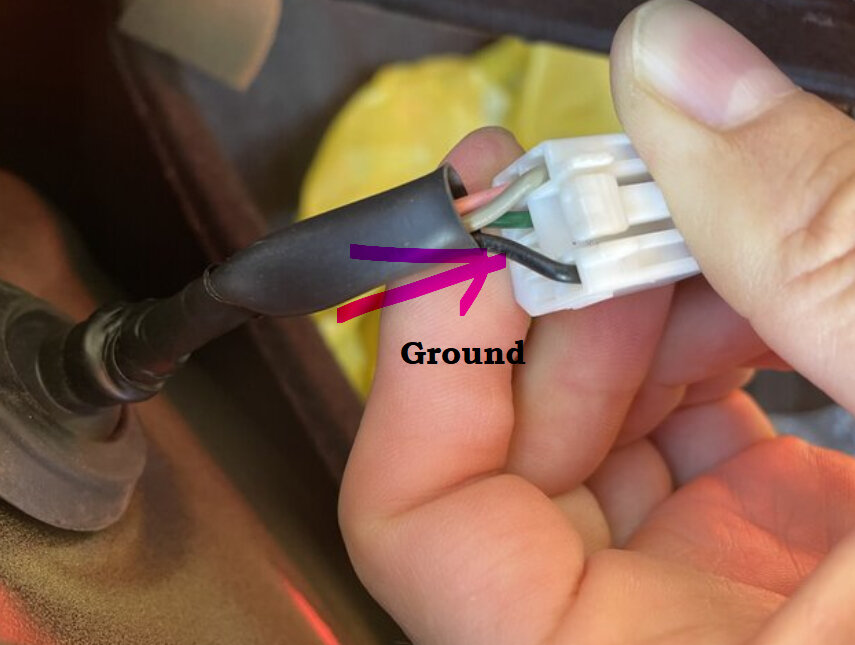

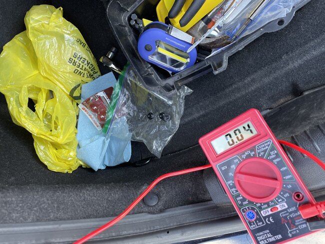

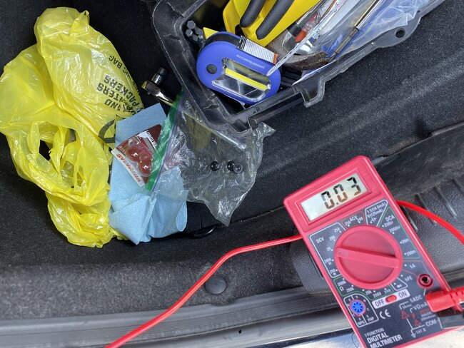

I was able to take a reading on the connector and on the three-color wires I got at least 12v but the black wire there was only .03v
On the socket in the middle, I got a reading of 12v but on the side where the black wire goes I got a reading of .03. The lights were on, and the brake was on too.

It looks like all the black wires are Grounds, so you would read about 0.3v on an active ground wire. So out of the 20 wires in this connector can you tell me which pin numbers had 12v? There are a few wires at the joint connector that are Brown with a Black stripe which might be had to see, and some wiring diagrams are not exactly correct, but all the grounds on this car are black wires. Are you getting any voltage reading at the bulb sockets themselves in the rear of the vehicle? And is everything out in the rear except the third brake light?

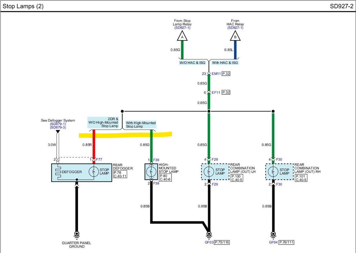

Looking at this diagram, the jf02 actually has the wires numbered, you can 2, 1,3,4. Those are the pins on that connector, and these are strictly the Brake light circuits. Granted the wire might not be green, it says they can be Red too. But these pins should all have 12v. and the pin 5 might be a ground (black wire), since it's not listed at the connector right there. It looks like pin 3 is your third brake light too, the high mounted lamp. Ignore the wire that has a red X on it, the program highlighted that by itself for some reason.

I got 12 v in the socket, lights work so does the turn signals.

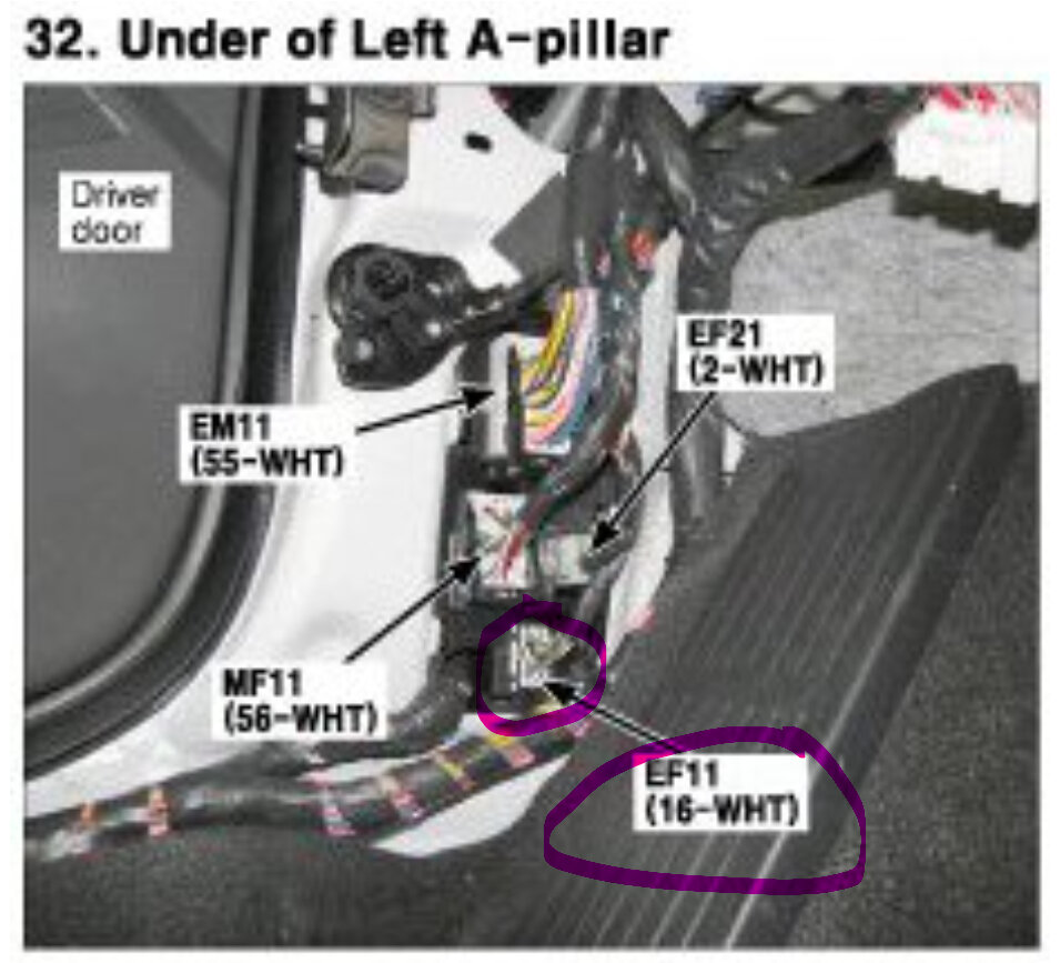

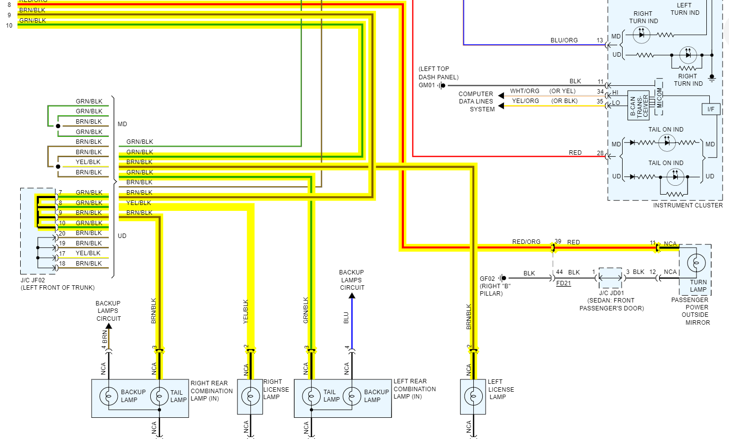

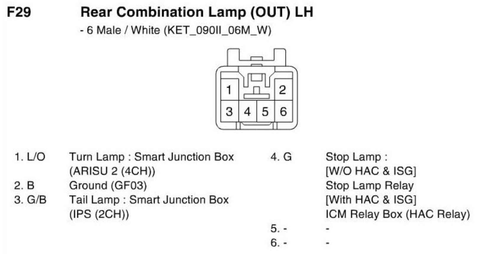

The only location it is giving me for this connector is Left front of trunk, so its somewhere on the driver side front of the trunk. There is no other location information for it. If it's not up top in the trunk ceiling, then it's going to be behind some paneling in the trunk. Can you think of anything else you may have moved when replacing the turn signals, nothing to do with the sockets, it looks like the brake lamps are double filament as well. This vehicle is not an Elantra Coupe or GT model, is it? You mentioned the connector for the bulbs as well, the brake blinking with the turn signal. Let's try just applying the brakes and that's all, turn off all the other lights and let's go from there, that way we can at least determine that there isn't another circuit taking current away from the brake lamp circuit.

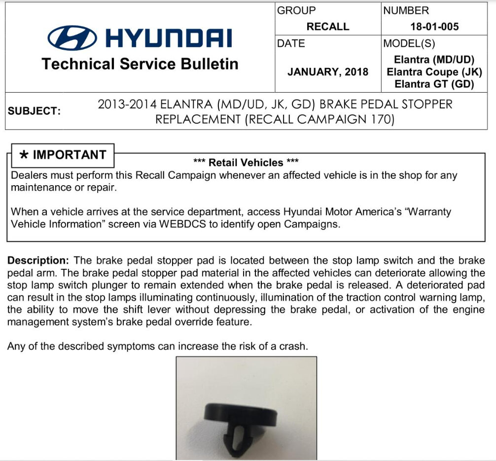

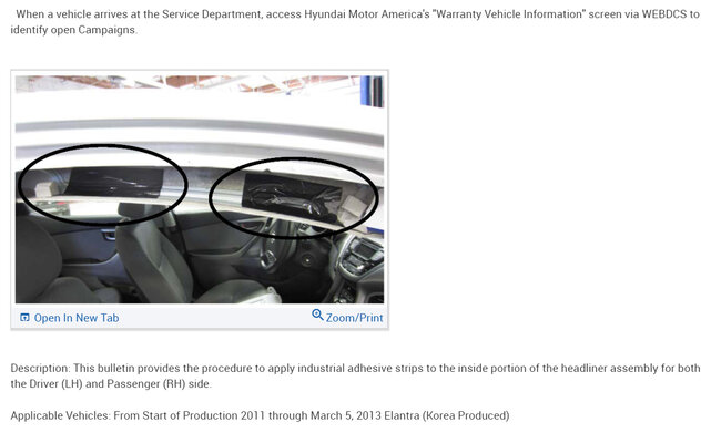

There is a recall for a Brake pedal stopper that I came across, just so you have that info.
They also have the connector for the rear assembly, one labelled in and one out. These are just for the driver side rear, the inner tail lamp and outer tail lamp. I guess there really is a lot of bulbs in the rear of this vehicle.

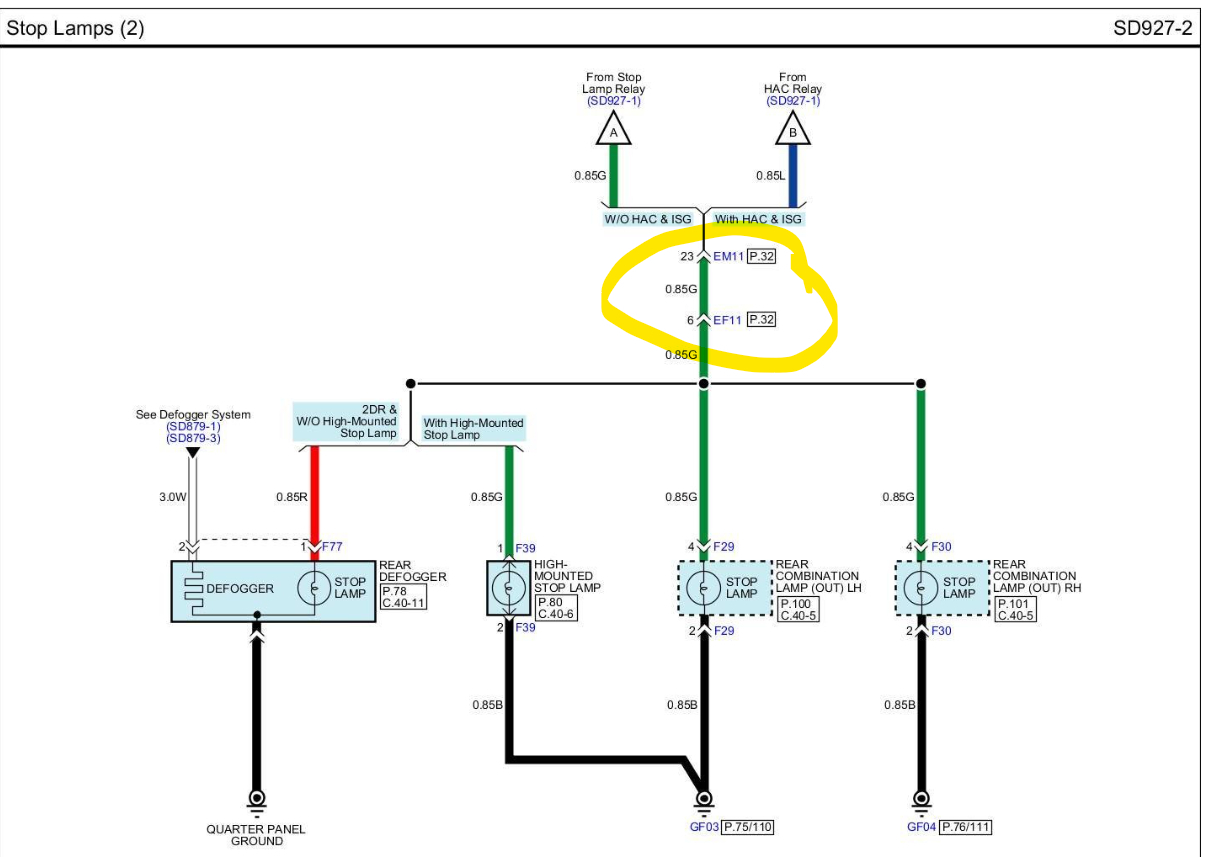

In the 5th diagram which is the brake lamp circuit only, I was trying to find this splice where the left, right and center brake lamps branch off, but all I can find is this connector EF11 (6th diagram) which happens to be way up front down where your left foot would be under pillar A, you can see the driver's door in the picture. But since this happened right when you changed bulbs, I think it has more to do with that, for some reason. It can't be anything to do with the brake lamp relay because your third brake lamp works. So, it has to be down stream of all that.

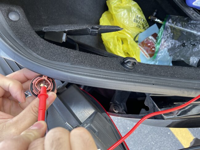

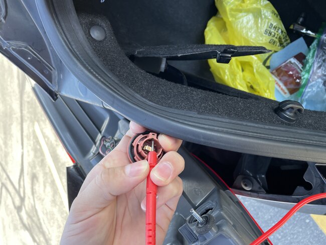

This is really confusing because that same light bulb lights up when I use the turn signal, but the other part of the bulb won’t light up for the brake and it has the same wire going into the socket which has 12v going in.

Yes, I feel your pain, it's a bit confusing to me too. Can you swap the bulb for a different one and see if maybe it's a bad bulb, if it's not that then the socket is either not making contact inside, or there is something else going on with the harness plug or socket.
Maybe the bulb is not within spec, and not wide enough or long enough, what kind of bulb is it? Was it cheap? I assume you bought a set of two bulbs in one package.

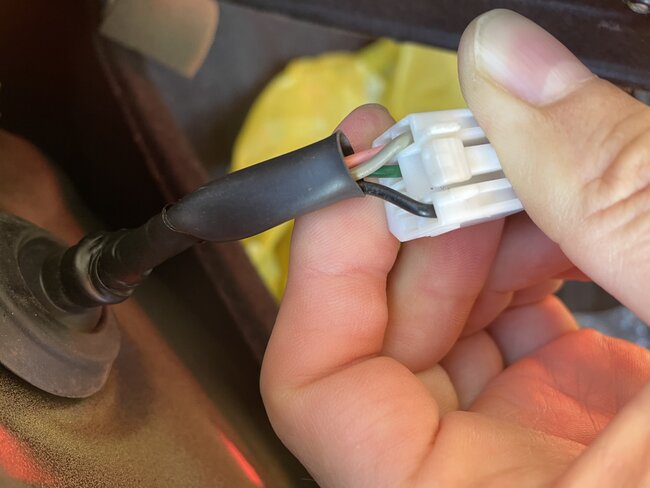

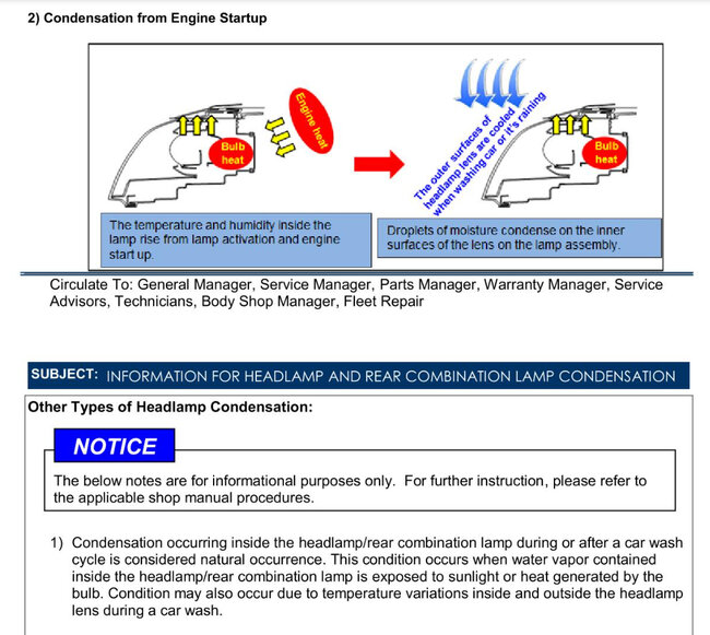

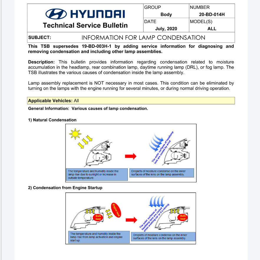

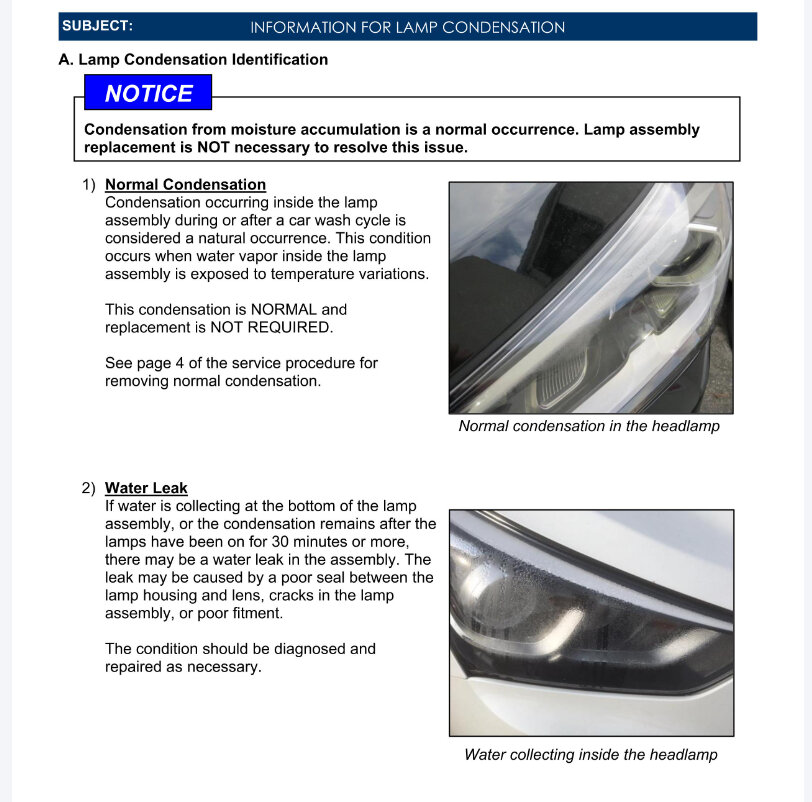

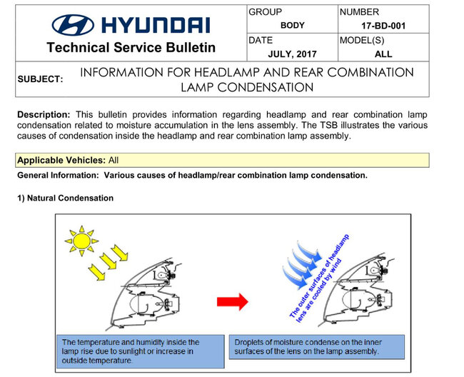

Yeah, you can buy the socket with a pigtail (connector) at an auto parts store. You're sure it's not the bulbs though? Do the brake lamp sockets light your test light?
Also, do you notice any condensation on the inside of the lamp assembly?

Okay. I didn’t really see any condensation buildup, maybe a little grime, but I cleaned it as clean as I could get it on both sides. Is there a spray I can use inside the socket to get it better.

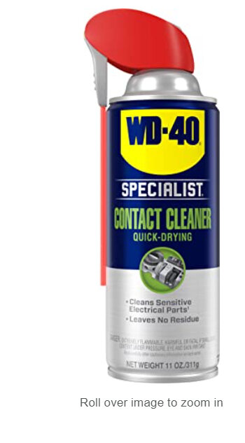

AL514
  • 5,617 POSTS
You can try some electronics terminal spray, i use it for corroded connectors, places where you see either white or green corrosion. Thats an indication of moisture getting into the connection. Deoxit is supposed to be the best, but they have a bunch of different kinds at AutoZone or advanced auto type places, wd-40 also makes a good terminal spray. Thats what I've been using. Spray the connectors and pins, let it dry out good.
Did you see any corrosion inside the harness connector?

I'm happy to report that I finally got brake lights working. I cleaned the connector and the socket several times. I don’t know which one was the actual problem, but it’s fixed. Thanks for the guidance.

AL514
  • 5,617 POSTS
Really. Well, that was definitely the strange one for the month.. Glad you got it straightened out, I would keep an eye out on the whole lamp assembly, if you notice any moisture on the inside of the housing after it rains, then that will need to be addressed. Or you will keep running into the same issues over and over. There are a couple of Technical Service Bulletins I came across having to do with condensation inside lamp assemblies Ill post below. Along with 3 Recalls, the 1st one is that pad for the brake pedal, and I don't think the other 2 pertain to your vehicle unless you live in California (second diagram) and the other is for a Korea Built vehicle (diagrams 3 and 4). Diagrams 5 and 6, and then 7 and 8 are the TSBs for condensation in the lamp assemblies. Just wanted you to have that information.
