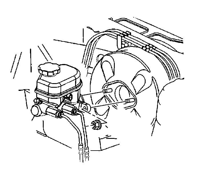

Here are the directions for replacing the master cylinder specific to your vehicle. The attached picture correlates with the directions.

pic 1
4. Remove the 2 master cylinder mounting nuts.
5. Remove the master cylinder.
6. Remove the reservoir from the master cylinder if it is to be reused on a replacement master cylinder.
Installation Procedure
1. Install the brake master cylinder reservoir to the master cylinder if it was removed previously.
2. Bench bleed the master cylinder.
pic 1
3. Install the master cylinder to the vacuum brake booster.
Notice: Refer to Fastener Notice.
4. Install the 2 brake master cylinder mounting nuts.
Tighten the 2 brake master cylinder mounting nuts to 25 N.m (18 lb ft).
5. Remove the plugs from the brake pipes.
6. Install the brake pipes to the master cylinder.
Tighten the brake pipe fittings at the master cylinder to 38 N.m (28 lb ft).
7. Connect the electrical connector to the brake fluid level sensor.
8. Bleed the hydraulic brake system.

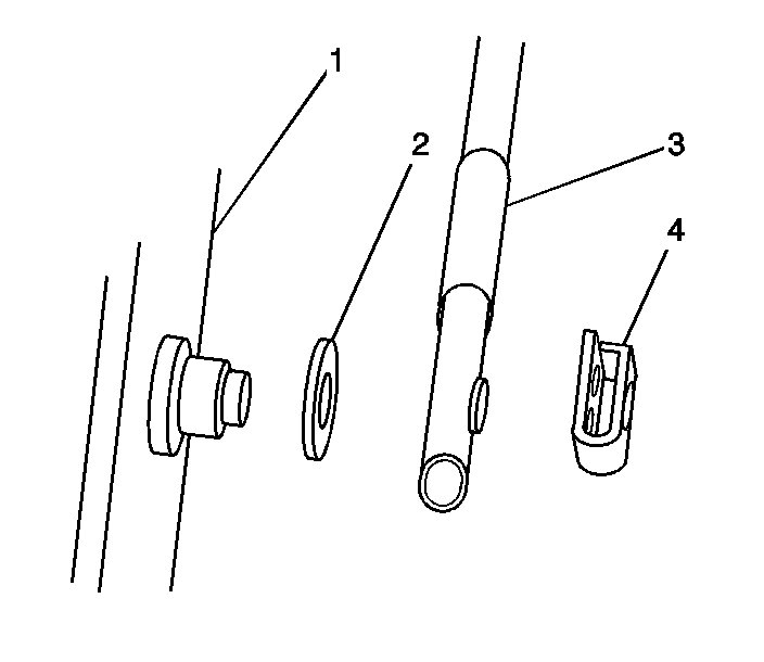

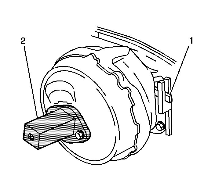

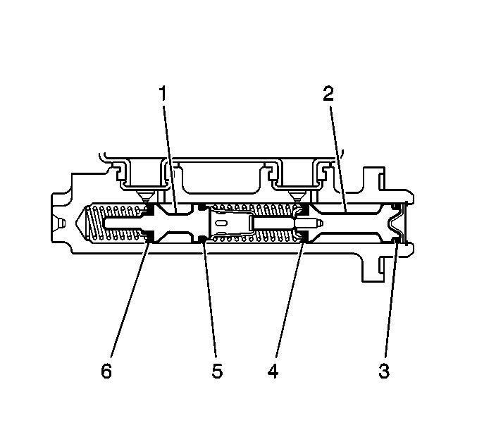

Welcome to 2CarPros. That isn't good, brake fluid loves to eat paint. First thing would be to flush the areas where the brake fluid is going with water real well. Next will be to replace the master cylinder and brake booster. The rear seal (item 3 in image 1) has failed on it and the fluid is leaking into the brake booster. From there it is leaking out the tube that allows air into the booster to provide brake assist with the engine vacuum. The brake fluid will damage the booster diaphragm and valving so replacement is a better option. Replacing the master cylinder isn't hard, You use a suction tool to draw out as much fluid as possible, then remove the electrical connections and then the brake lines. Cap the lines to help keep the fluid clean. Next remove the two nuts that secure the master cylinder to the booster. Remove the master cylinder. For the booster you need to remove the closeout panel under the dash. Then release the clip and remove the brake push rod from the brake pedal (image 2). Now you unbolt the coolant surge tank and move it out of the way. Then you need to look in the back of the booster for the release tab (image 3) This pushes in toward the firewall. With it pressed rotate the booster counterclockwise. It will release from the mount. Now simply pull it free. I would place a few towels under it to catch any fluid that will leak out. Finally you push in on the foam at the rear of the booster to find the clip that holds the brake rod in place (image 4). Remove the rod and set it aside. To install the new booster you reverse the process. I would clean up any brake fluid as soon as you get to it.
