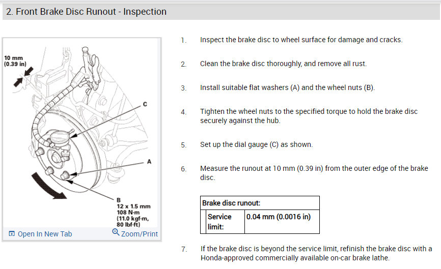

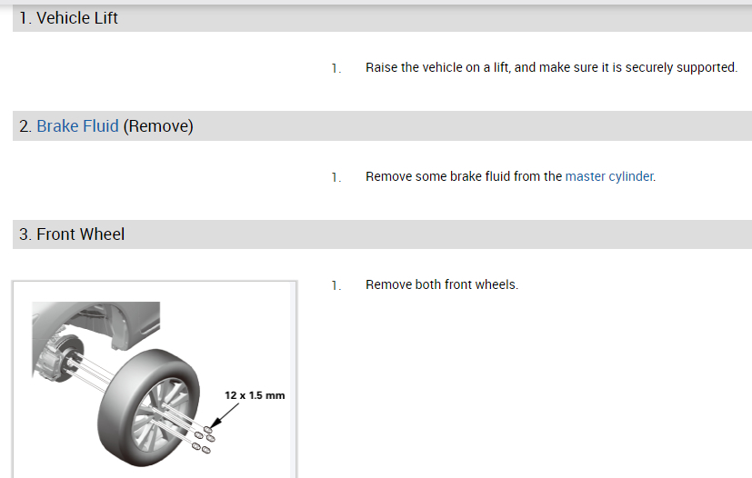

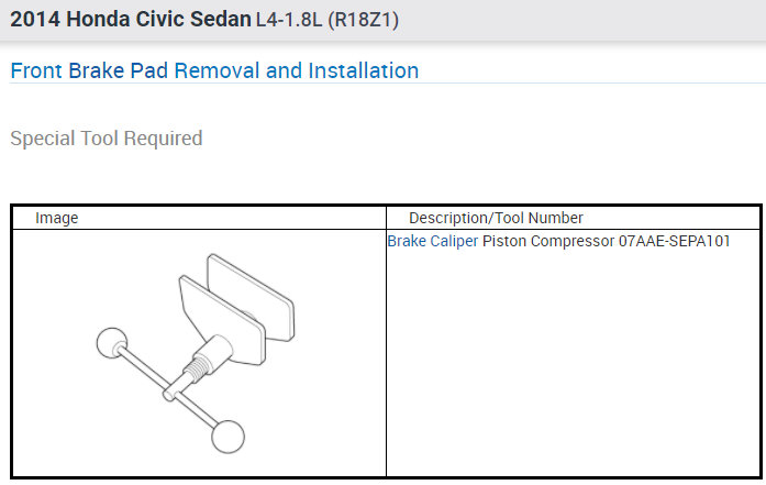

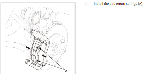

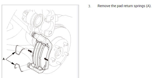

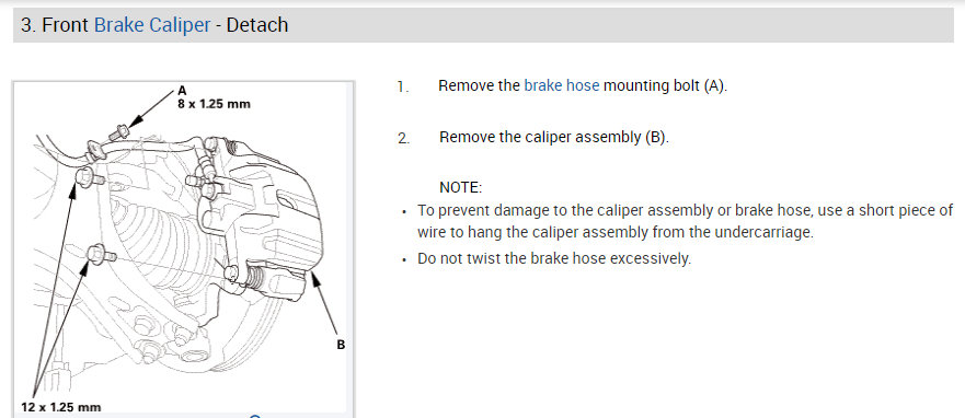

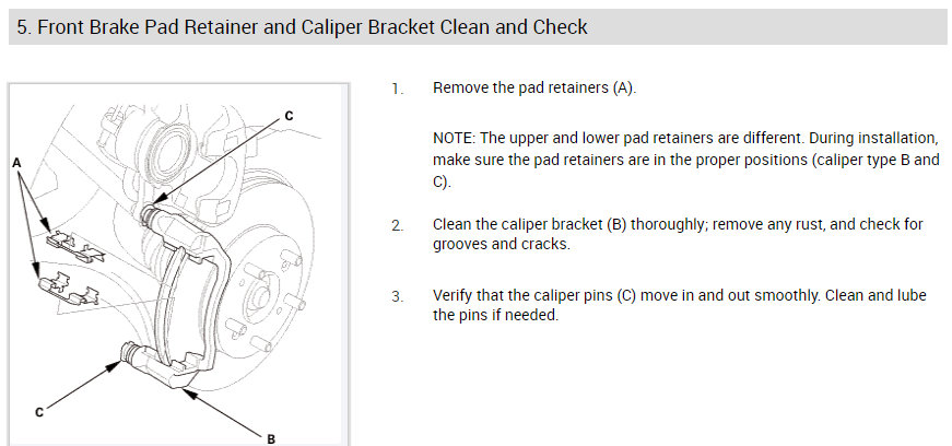

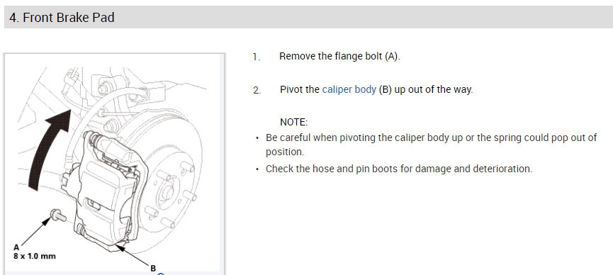

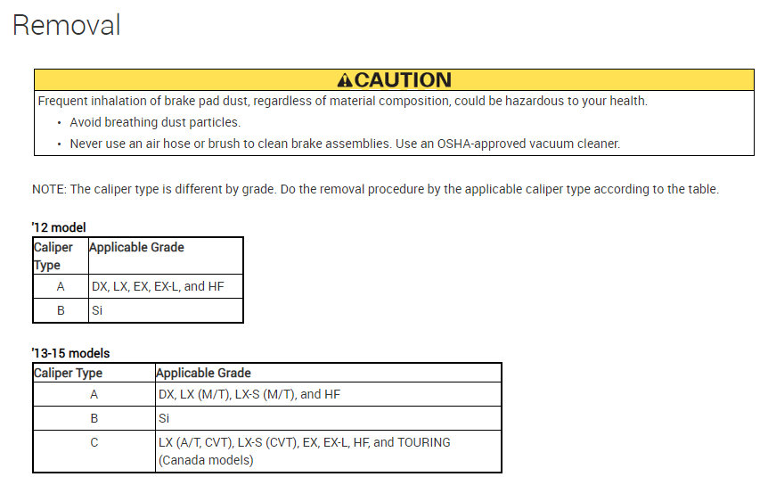

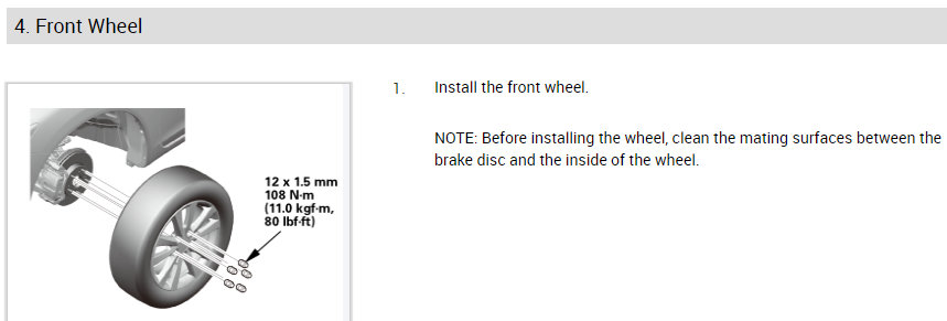

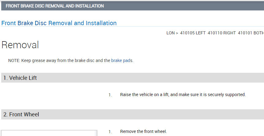

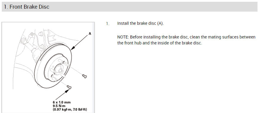

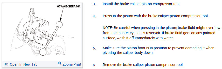

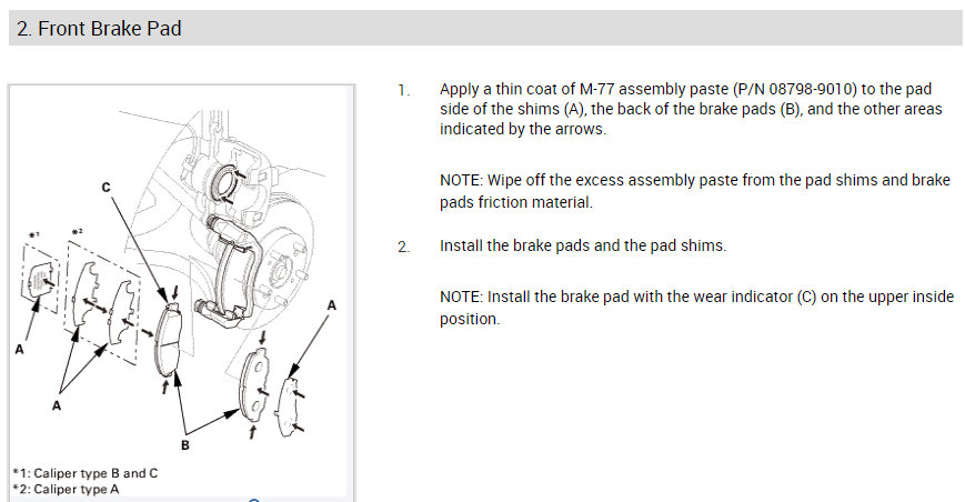

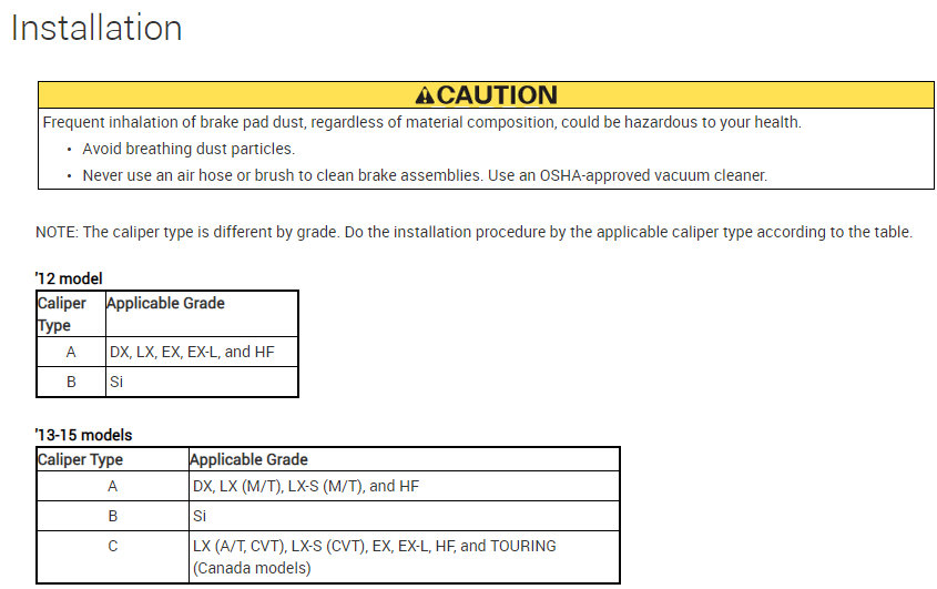

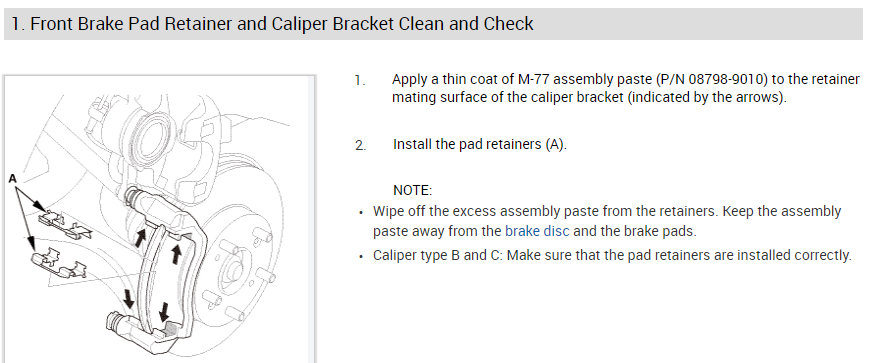

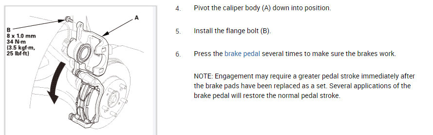

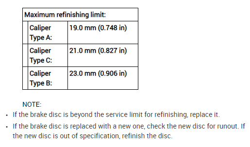

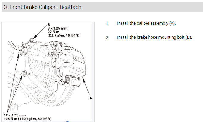

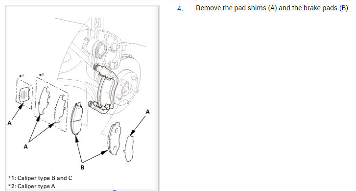

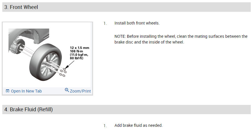

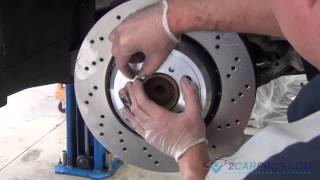

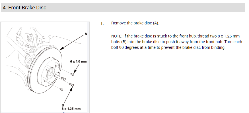

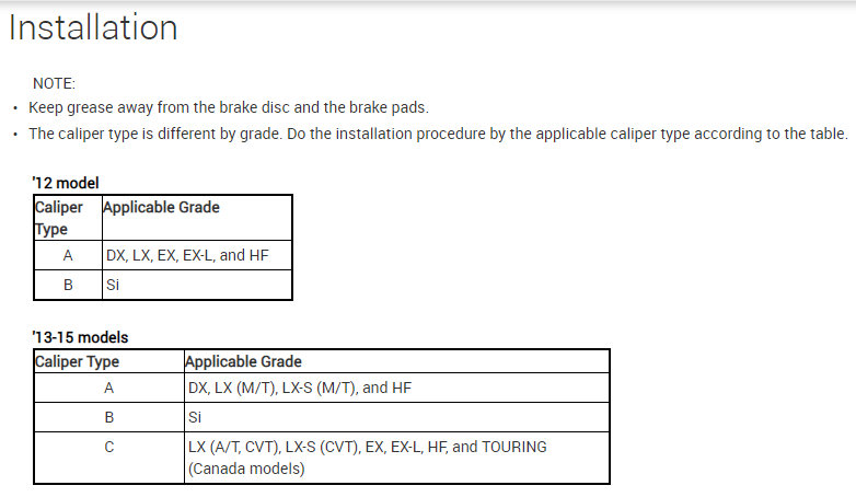

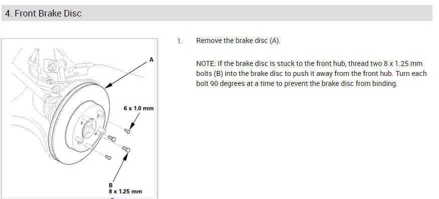

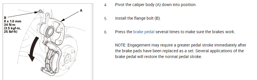

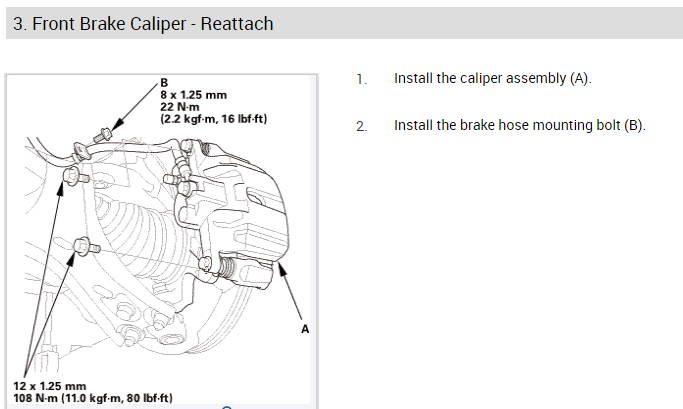

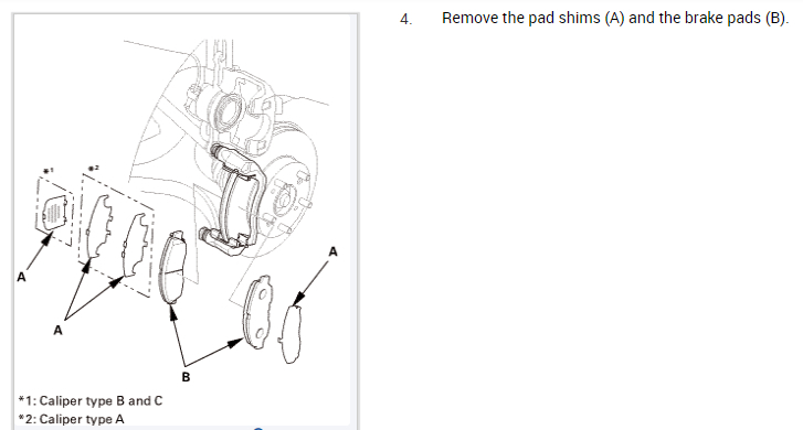

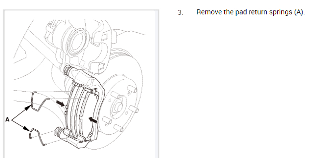

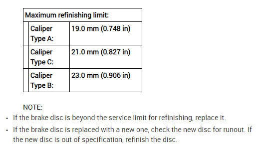

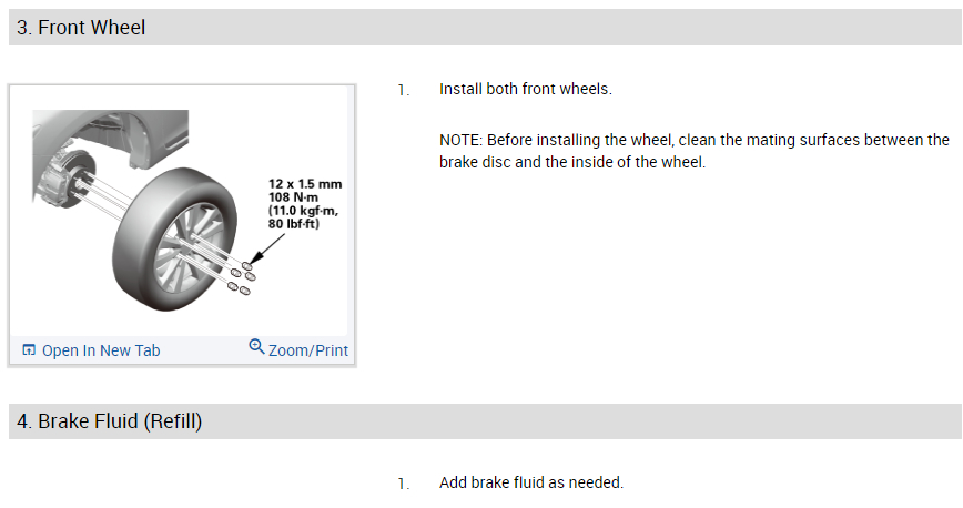

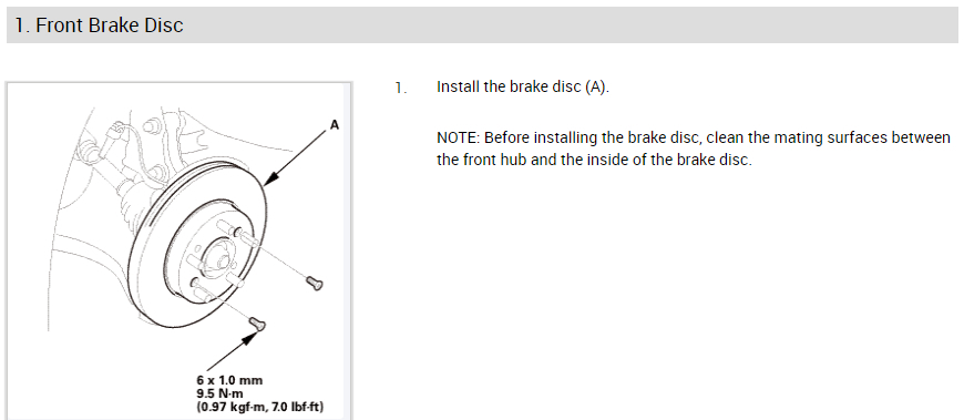

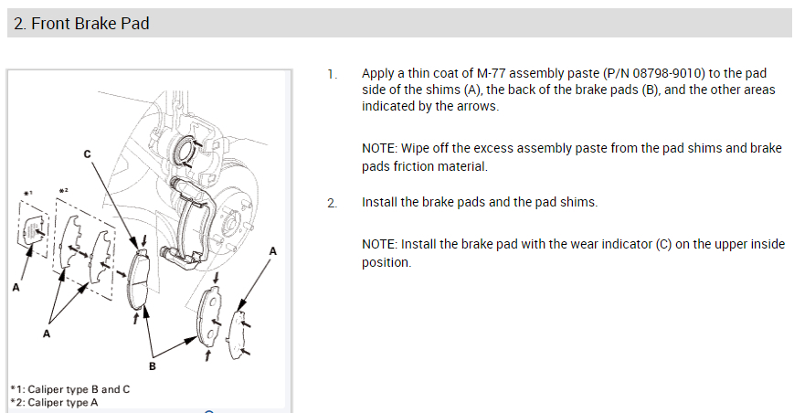

Hi. We are having the brake disc and pads changes on our car (14 plate Honda Civic 50,000 miles). the garage have said I need new brakes I wanted to save some cash can you help me please?
Aug 19, 2016 at 9:32 PM
DANNY L
  • 5,648 POSTS
Hello, I'm Danny.
Here is the information you requested. This is a tutorial showing what is involved on how to change front brake pads and brake rotors:
https://youtu.be/-HDVldGwHTU
and
https://youtu.be/_HrWXRdD2ug
I've attached picture steps below on how to change the front brake pads and rotors on your car. Hope this helps and thanks for using 2CarPros
Feb 19, 2021 at 10:25 AM
Suggested Repair
Replace the front brake pads and rotors using the expert's step-by-step pictures and video tutorials, which can reduce labor cost compared with the garage quote.
