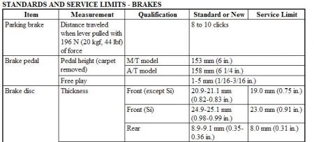

am the first owner of my car. I just took it in for its 2nd B1 service since taking delivery of it on november 4, 2007. I am told that the front wheel brake rotors and pads needs to be replaced, because they are 98% worn out.
my question is: is it just the brake pads that are worn out or the rotors too. I am a female. I do not drive my car hard.
I am told that the cost to repair the rotors and pads will be about $500.00. I understand that the pads may need to be replaced, but do not know enough to know if the rotors need to be replaced as well. So this is my question. Can the pads be replaced without replacing the rotors as well?
I'm taking the car in for servicing tormorrow and would appreciate your answer.
thank you
Dec 28, 2009 at 10:14 AM
MHPAUTOS
  • 31,937 POSTS
HI there, Brake rotors must be replaced when they reach there min thickness, see the table for you car, if the rotors are still above this min thickness there is no reason to replace them, often workshops will just say they need doing as this is extra that they can charge. Mark (mhpautos)
