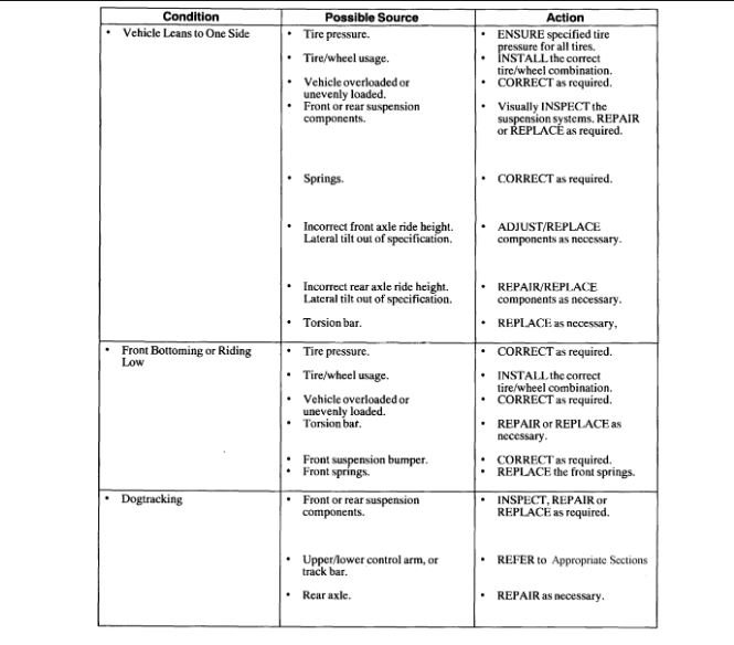

When I hit bumps my front end seems very bouncy at times.
Oct 8, 2018 at 2:54 AM
PATENTED_REPAIR_PRO
  • 1,853 POSTS
Have the shock absorbers or struts replaced.
The repair manual says these have shock absorbers and they keep the springs from just bouncing continuously.
