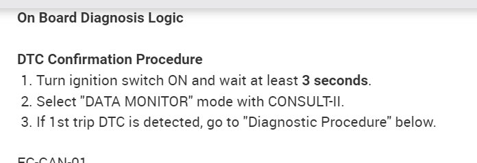

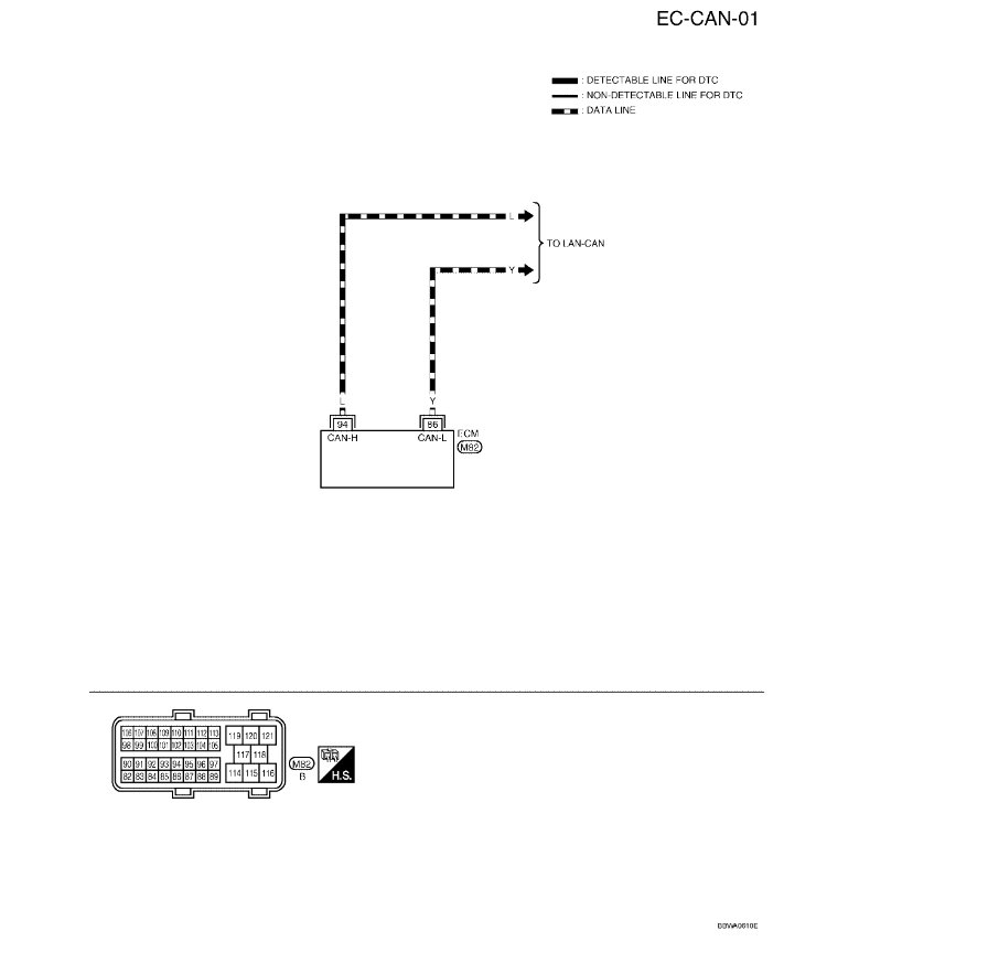

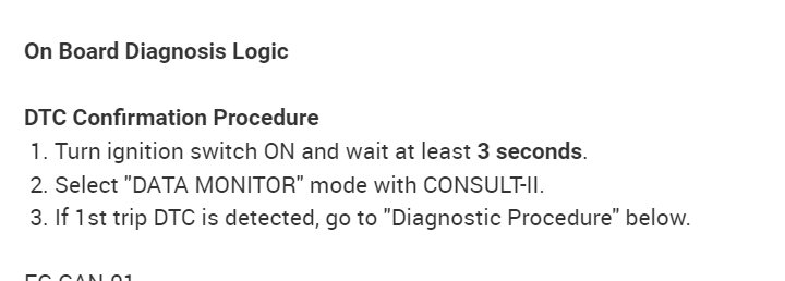

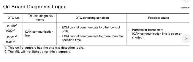

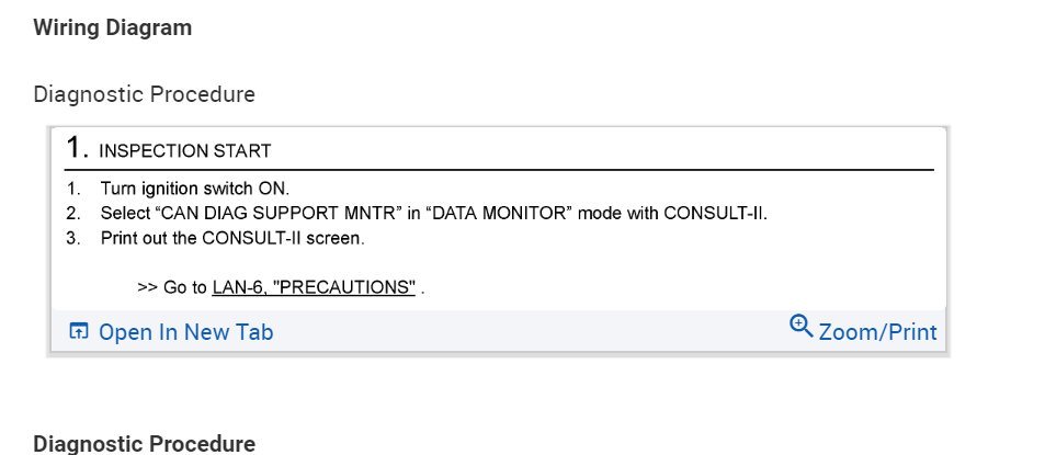

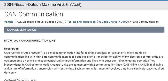

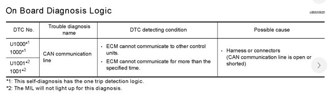

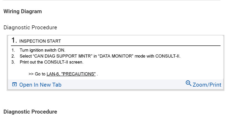

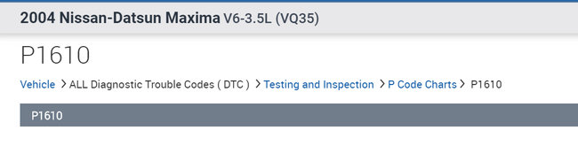

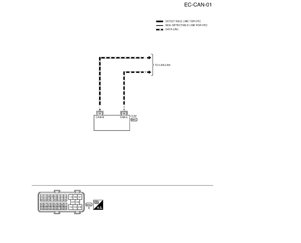

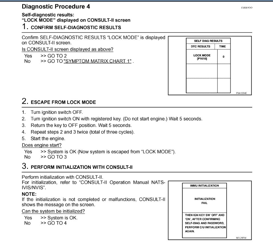

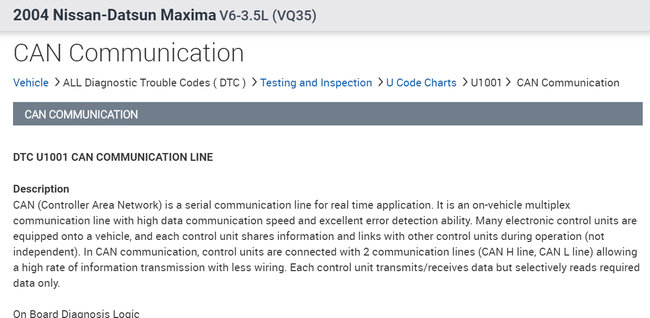

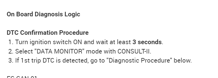

I hate to hear when someone gets taken advantage of like that, and I am sorry. I have good news and bad news for you. Good news is that DTC U1000 and U1001 ar DTCs concerning Connecting Area Networks (CAN) system, and this might to blame for your ignition key not working. The bad news is you need the dealership scan tool to diagnose and fix the problem. Anyway I have included all the information I have on the three DTCs in the diagrams down below. Please go through them and keep us informed on how things are progressing, and please, if we can help in any other way, do not hesitate to ask.

For key issues like this a locksmith can be much cheaper than a dealer when it comes to programming them into the system. The codes you have can all be caused by a dead battery as well. The fix on some Nissans is to clean the ground connections as they can corrode and cause them. The P1610 is a lockout code from repeated starting attempts with a failed key, the U codes can both be caused by a dead battery not waking the PCM.
What I would do first is clean the battery connections at both ends. Now put a good fully charged battery into the car. Now try your key. If the security light is still flashing with the key in then it is likely the key has been forgotten and will need to be programmed back into the system.
