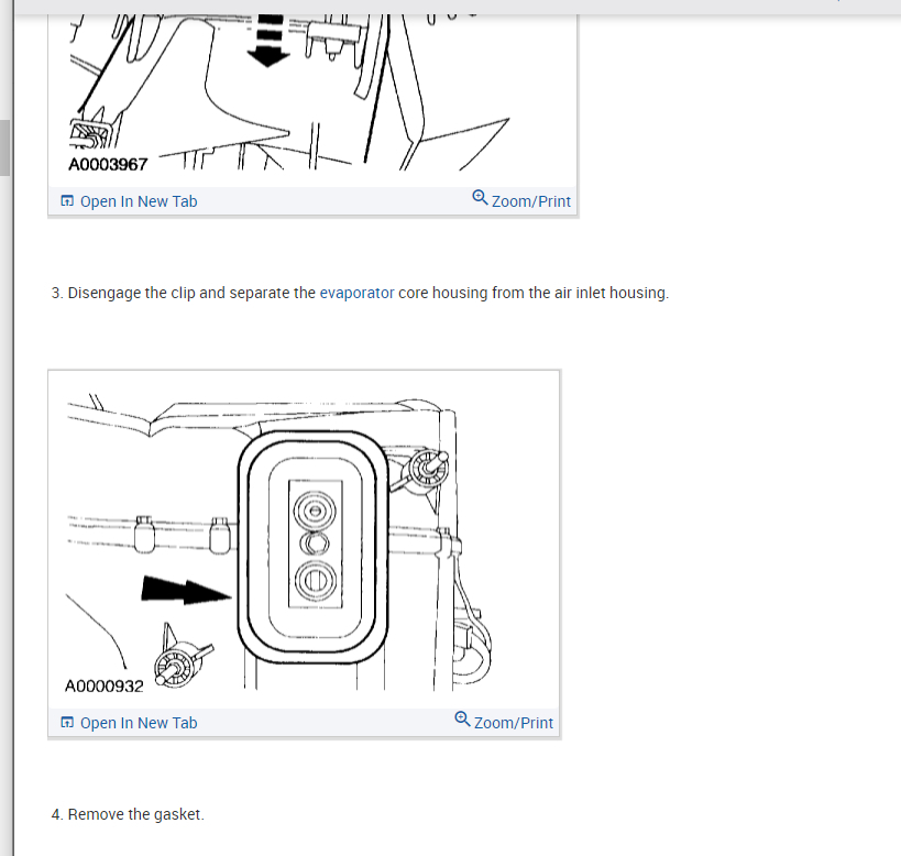

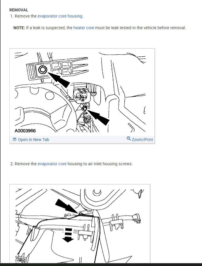

BMRFIXIT
  • 19,053 POSTS
need to test the heater hoses. They are slightly hidden so I attached the process from the manual below to access them.
with engine running and at operating temp heater fan motor on high open hood and check heater hoses by the firewall
if both hot you have a blend door issue CHECK FOR CODES
if one warm or hot and other not heater core need to be flushed
isolate heater core and flush
let me know

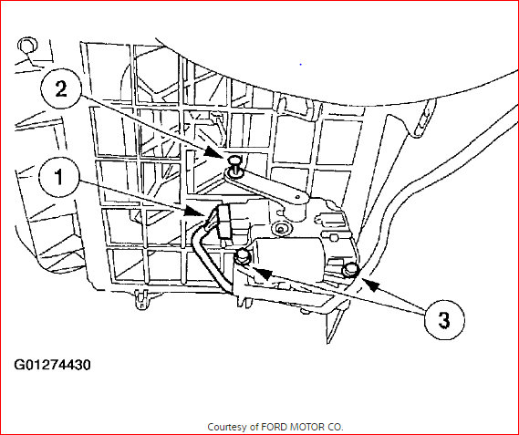

DANNY L
  • 5,648 POSTS
Hello, I am Danny.
The code you have mentioned B1242 is affecting the "re-circulation door actuator circuit failure". The test needing to be performed is to check for incorrect/erratic direction of airflow from outlets. Basically by the actuator not working, it is not allowing a blend door to open/close and allow air to move where it is supposed to be directed. I can attach testing info but it is 19 pages. The actuator is located on the HVAC assembly behind the right side of the dashboard. This requires a fair amount of disassembly/tools for checking. I attached a picture of the actuator and hope this helps. Let me know if more information is needed or any other questions.
Danny

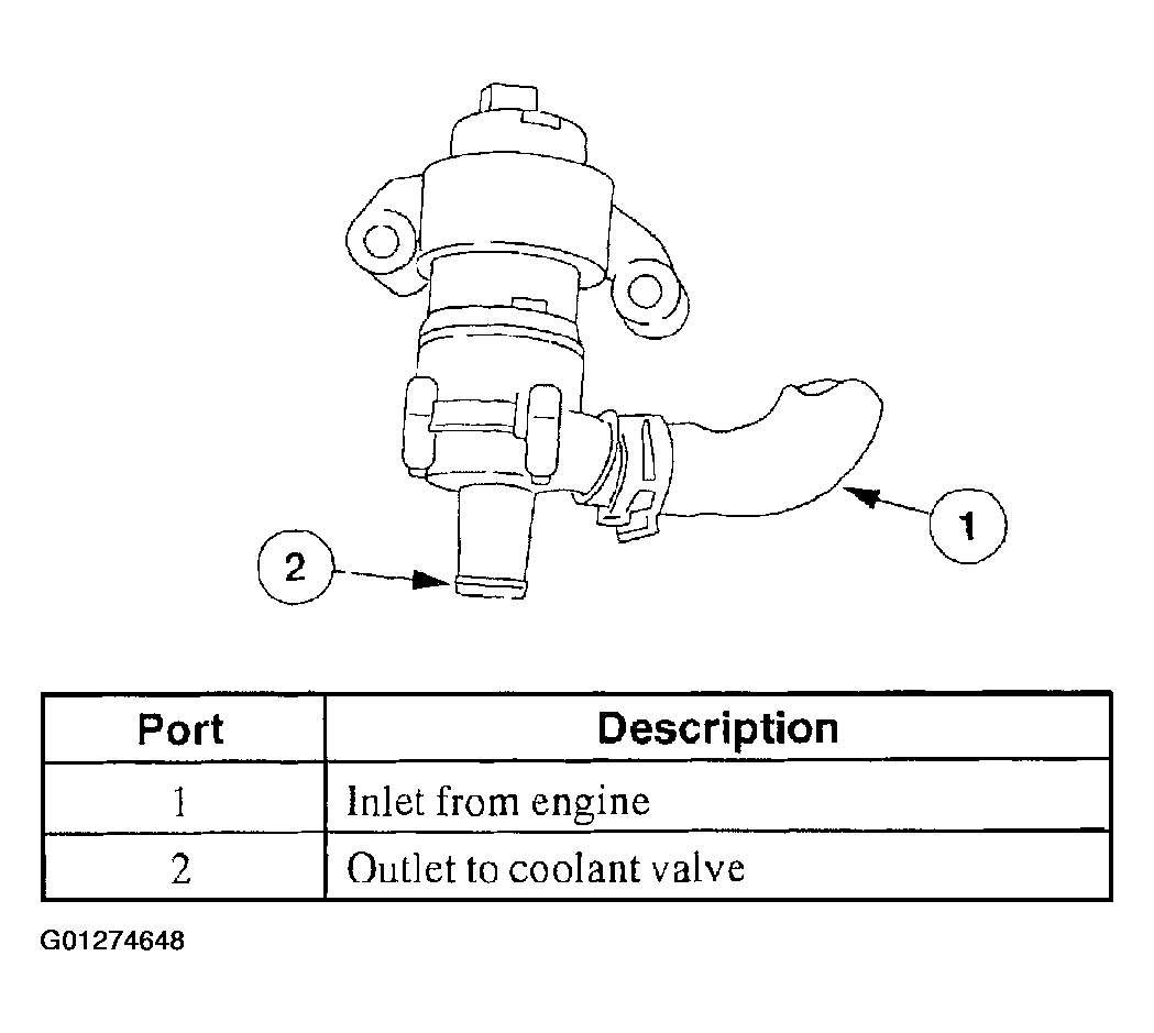

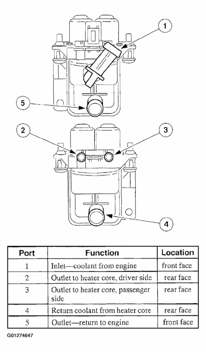

BLAQ77
I found out that it was the cylinoids. I swaped it out with a new one. I had to get all the air out the system for it to work. The part cost $291.29. It took about 3 hours to do.

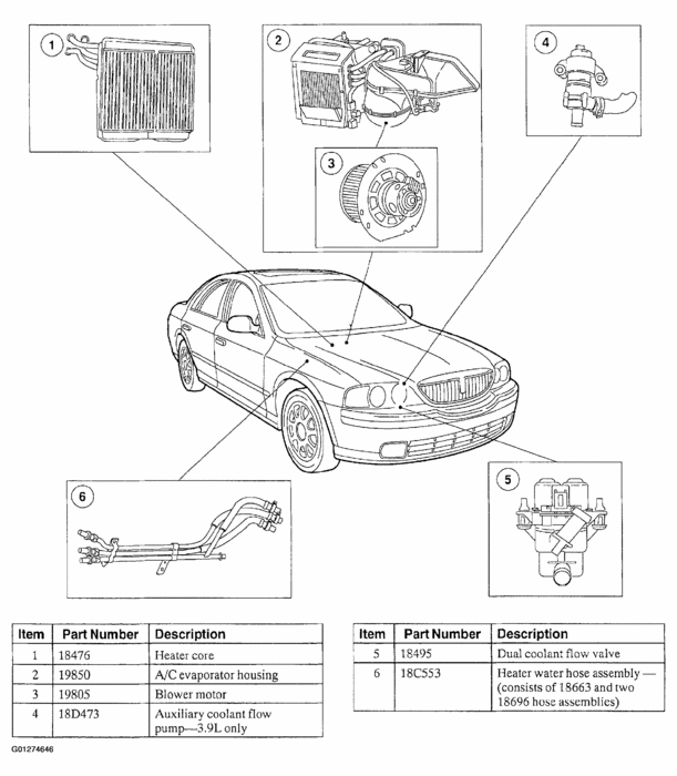

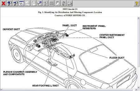

03LS
'03 lincoln ls 40k miles v8. ac works fine, but no heat. Blower works but the air comes out the temp of the vent and never gets warm. It worked fine then suddenly stopped. Any diy suggestions? Thank you in advance
Oct 25, 2020 at 4:52 AM (Merged)
  • 75,992 POSTS
Check your coolant level in the radiator-top it off also the resevoir bottle. Could also be a problem with components below
https://images.2carpros.com/forum/automotive_pictures/12900_2003_lincoln_LS_HVAC_system_1.jpg

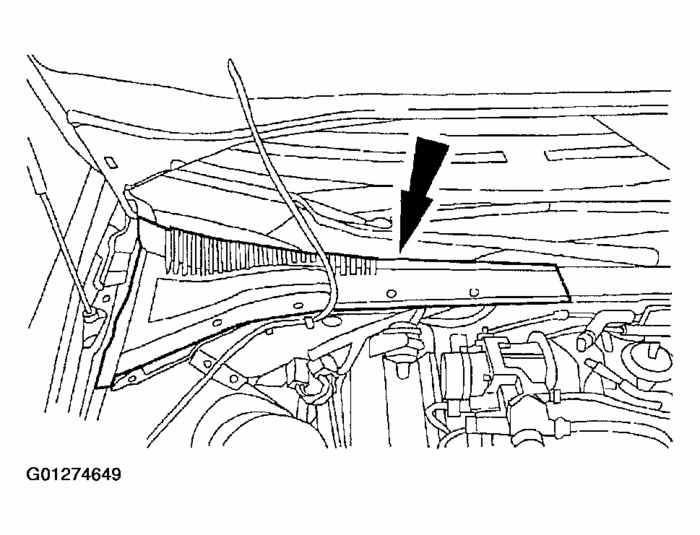

JASCO927
I had this same exact problem with my 2000 LS, after cleaning out the heater core, topping off the coolant, changing the thermostat and replacing the dual climate control unit, the problem was the heater control valve/solenoid located on the front right corner of the car. Hope this helps.
