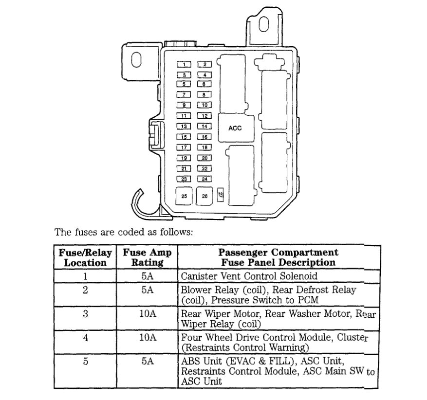

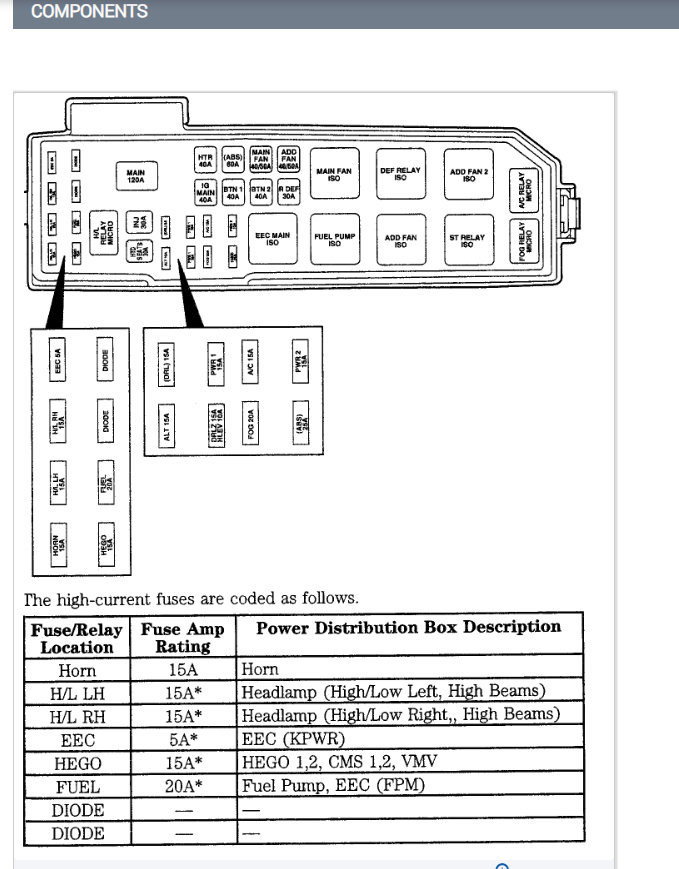

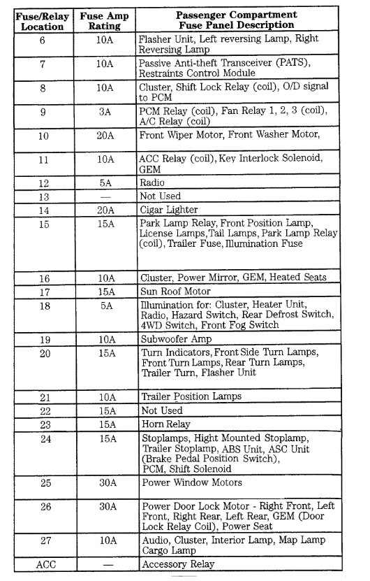

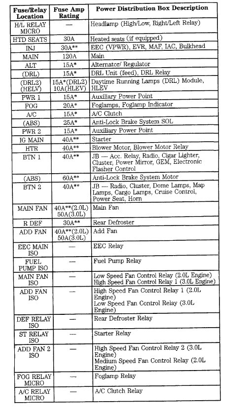

We can get this fixed for you, with the key on please check for power at fuse #16 on the left side of the dash and fuse #12, #13, and #15 in the under-hood fuse panel. This guide can help:

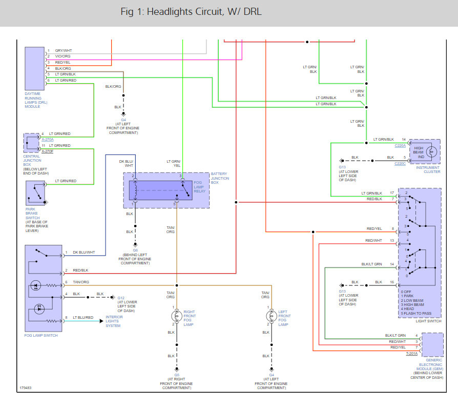

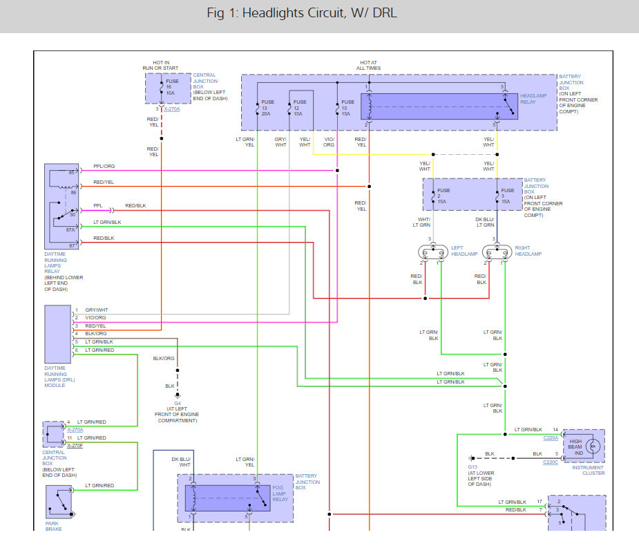

If they are okay there is a headlight control relay, I would swap out in the under-hood fuse panel as well, here are the headlight wiring diagrams so you can see how they work. If okay there is a Daytime Running light relay which must work as well, it is located on the lower left side of the dash. Check out the images (below). Let us know what happens and please upload pictures or videos of the problem.
