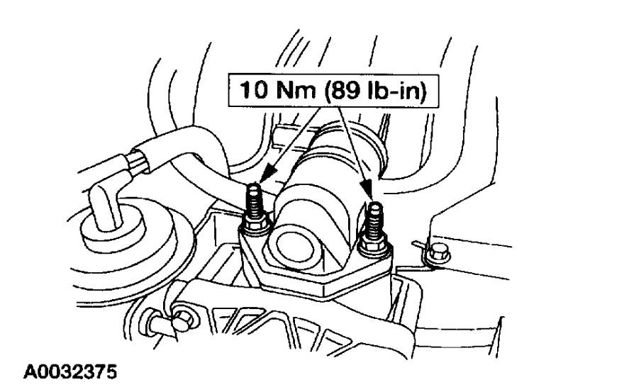

Replacing it, it is. I keep hoping someone will tell me something simple like “you have old change in your cup holder,” but no. the last in-line 6 I had was carbureted so the idle valve was on the filter box. If I know my Fords I’m going to guess this will be a pain in the neck to get to.
Apr 18, 2019 at 8:00 AM
You stated you cleaned it? Did you not have it off?
I attached a picture for you. Remove the top cover and it is right there.
