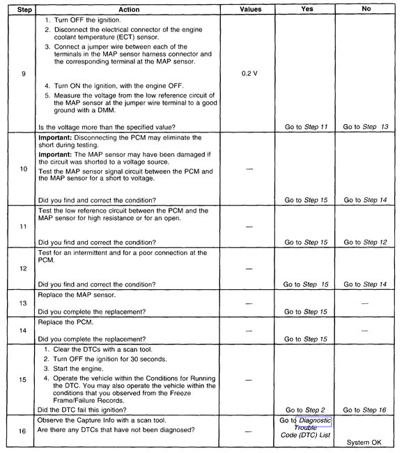

Thank you for the information. I'm left shaking my head. Reason why I asked about that was my car randomly shuts off at idle in park, at stop light and while driving down the road. I wiggled harness under the hood, no change. Whatever is causing car to shut off at same time it causes map codes to come up and no mil light. Po108 and po1106. When this issue happens the rpm needle falls down because something is shutting off then it cuts back on. And at times motor stops turning but rpm needle stays around 2,000, 2,500 or 3,100 for just barely a few seconds. So during this time various actuators slash components are still working. I popped the hood and saw and heard. Weird. Doesn't last for long . Did this before I replaced computer and map. But these codes were before I replaced comp.102,108,102 history,108 history,300, 620 history,1106. Things run just a little smoother but still cuts off and sometimes the rpm needle plays hang time, plus the only code that comes up now is po108. Any ideas?
Anything similar from other grand am owners? By the way when I start the car the service engine light goes out before service vehicle. Does that mean anything? Sigh. thanks again

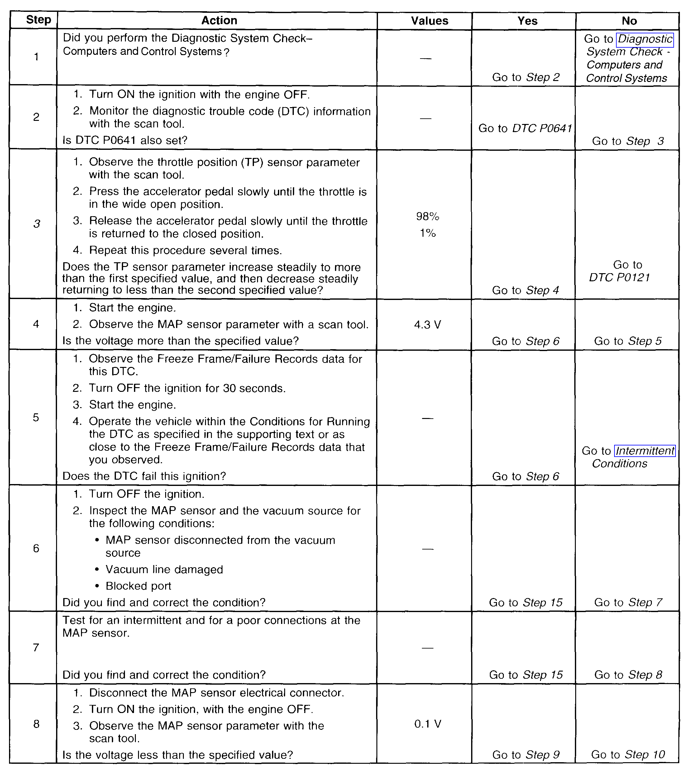

The code is related to the map sensor. Have you checked voltages to it?
Don't laugh, but this could even be related to a faulty coolant temp sensor (ECT). Do you have a live data scanner? If you do, check to confirm the ECT is close to the temp you feel the coolant would be. Also, the throttle angle sensor can be an issue as well.
As far as the MAP, again, you need a live data scanner. For the code to be set, the PCM detects that the MAP sensor voltage is more than 4.3 volts for 3 seconds. So the voltage needs to be checked.
Also, the computer is designed to identify the failure in the event it happens more than once. If the diagnostic reports a failure on the second consecutive ignition cycle, the control module records the operating conditions at the time of the failure. The control module writes the operating conditions to the Freeze Frame and updates the Failure Records. So again, if you have a scanner, I would suggest looking at freeze frame information to help identify where the failure begins.
I don't know if you have the scanner to do these checks, so let me know. Also, I attached a flow chart to help diagnose this code. See pics 1 and 2.
If there is something you can't see on the chart, let me know. I will watch for your reply.
