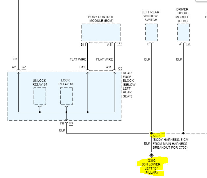

I'm Having a problem with the BMC, I'm trying to find the ground going to the BMC but can't find any wiring Diagram for this. would you know where I could get one?
Thanks
Dec 7, 2022 at 1:06 PM
  • 110,194 POSTS

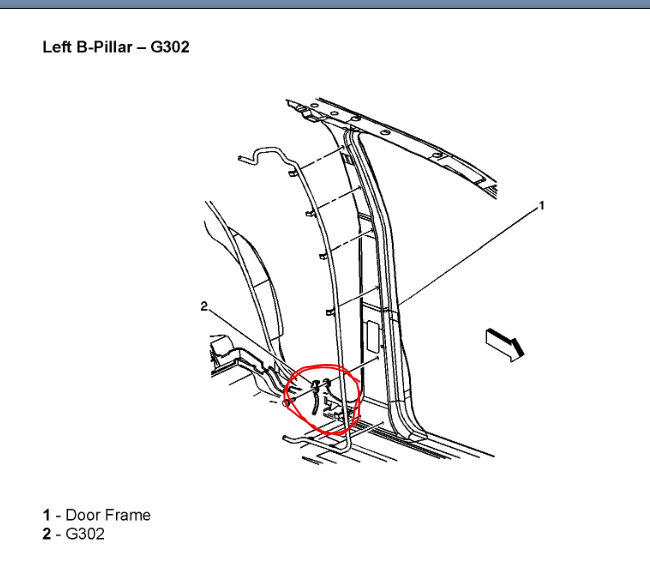

I attached the ground schematic below for the BCM. Its ground is G302 located on the left side bottom of the B pillar. I can tell you the ground supply has a few different splices in it that can fail, so once you locate the ground, confirm there is continuity in the wire from end to end.
Take a look below. If you need anything further regarding the BCM wiring schematics, let me know. Also, pic 2 shows the G302 location.
See pic below.
