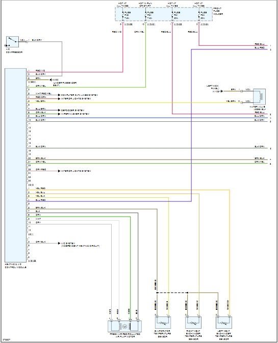

I have BMW x5 3.0I 2002 81,400 miles no prior maintenance. The blower continues to run with the engine off. Pulling a 50 amp fuse labeled blower is the only way to stop the blower and prevent the battery from running down. Would be very thankful for any help. H Tanner
Sep 4, 2007 at 7:04 PM
DOCHAGERTY
  • 9,606 POSTS

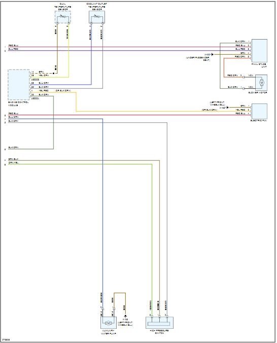

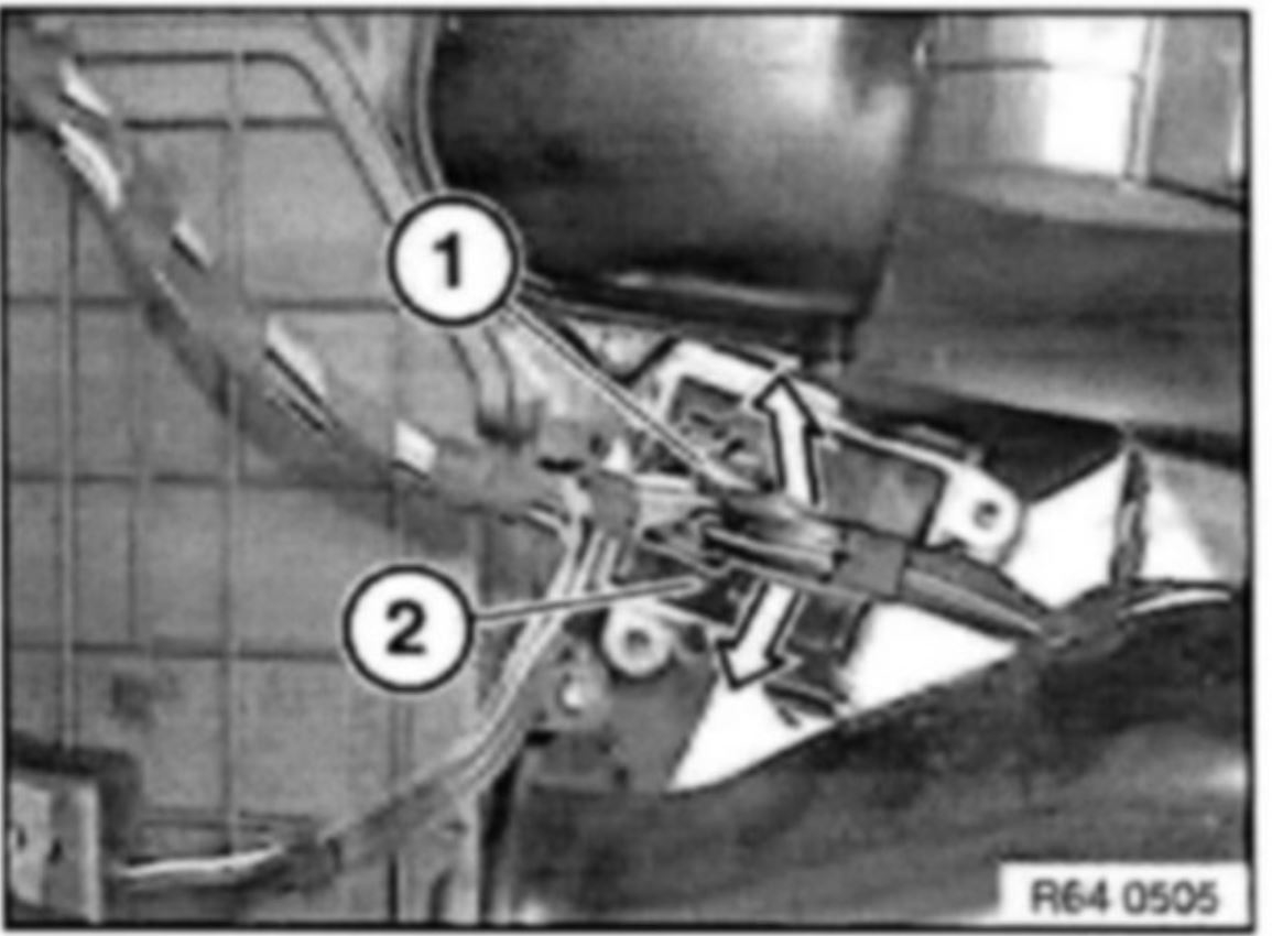

Your problem is the final stage that controls the fan needs to be replaced. It is located just behind and below the glove box behind the upper carpet trim. Just remove the carpet trim and you can see it, the connector is a black 5-pin, you'll see its real easy. The final stage may be available online somewhere. The dealer will have these as a stock item, they fail all the time. The wiring diagrams for your blower system are attached below as well as the only pic I could find of the final stage units location

it is below and behind the glovebox.
first remove the plastic cover just above the passenger foot well area by pulling it out(it pops out, no tools required) then remove the screw that holds the carpet in place and the carpet pulls out to the rear.
the final stage is behind a piece of open cell foam(if the foam is still there) remove the torx screws and install the final stage. you kind of have to "stand on your head" to see the final stage. if you have already purchased a replacement you will be able to visualize its installation.
its pretty straight forward, give yourself half an hour.

I have a 2001 BMW X5, 4.4i with 60,000 miles. I recently replaced the alternator. Two days later, I got into the car and started the engine...all was normal except that my environmental control panel indicated the AC was blowing FULL but there was no air from the vents. The compressor was working, and the rear fan was working and cooling. I removed two 7.5 amp AC fuses and they were good. The 50A main blower fuse is good. There is one interesting factor.. I pulled one of the 7.5A ac fuses with engine running to verify it was correct fuse (compressor stopped) and when I replaced it the main fan started working. However, when I moved the car it stopped. It came back on once about 30 seconds later then stopped. Do you have any ideas about this issuue? Thanks JP
Jan 6, 2019 at 6:17 AM (Merged)
DOCHAGERTY
  • 9,606 POSTS
the problem you describe is the final stage unit for the a/c blower has failed.reinstall all the fuses and replace the final stage unit,it is located in the passenger footwell area on the right side of the "heater box" (the plastic housing that contains the heat exchangers)
