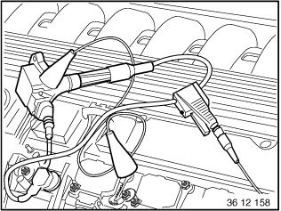

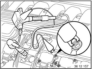

What you did shouldn't have hurt anything. As far as the inexpensive crank sensor, there is a good chance that is the issue. However, here are the directions for testing the secondary signal for the coil:

Special tools required:
12 7 030
Engine Test Step 10
Remove ignition coil. Clip Special Tool 12 7 030 on relevant ignition coil to be tested. Clip high tension clip around ignition lead.
pic 1
Connect earth lead of adapter to vehicle earth and ignition coil. Connect up diagnosis connector.
If trigger signal is not present (terminal 1), connect black clip of universal adapter cable to pin 1 of primary adapter cable.
pic 2
Produce a stationary signal by pressing key R on the tester.
Note:
Neighboring ignition leads could produce interference on the screen of the oscilloscope.
Refer to the fault memories of engine control units for additional troubleshooting.
Interrogate fault memory and its fault reports - refer to Electrical Troubleshooting Manual.

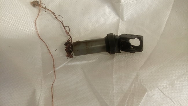

In the mean time I noticed that one of the connector in the E-Box which is in the left corner of the engine bay (Australian model) had the green stuff. I started the vehicle after cleaning and reconnecting the corroded connectors. This time I noticed smoke from the engine. I found No. 5 ignition coil melting. Disconnected the coil and removed it.I could pull out only a portion of the melted coil pack with the secondary winding stretched out. The other portion seems very tough to pull out.
No diagnostic codes but the transmission fault message appears on the car display.
Could you tell me why the coil got burnt. Please help

The only time I saw that happen was when the boot that goes over the spark plug was allowing power from the coil to arc which overheated it. Check the boot to see if there are any grey marks in it. Also, make sure there is no oil in to spark plug tube that can cause a short and failure.
Do me a favor. If you haven't gotten it out yet, take a pic so I can see what you are dealing with and upload it for me. Hopefully, I will be able to provide guidance.

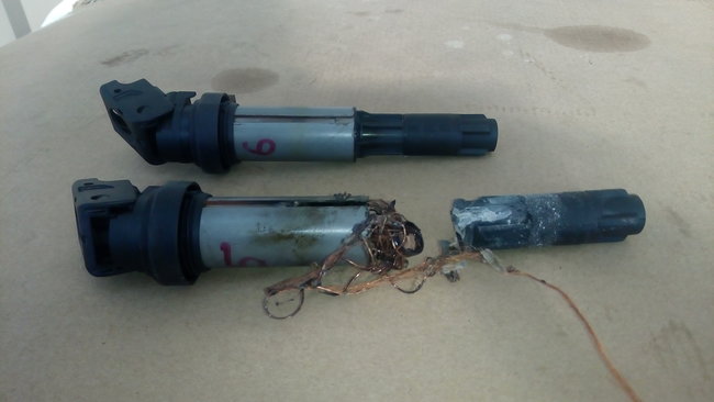

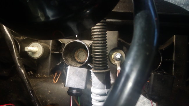

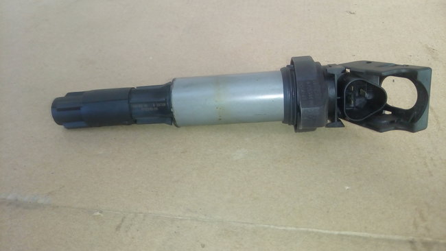

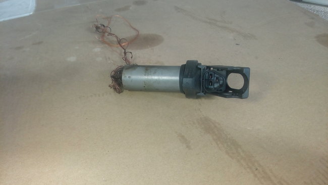

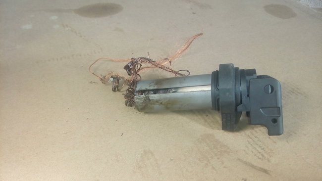

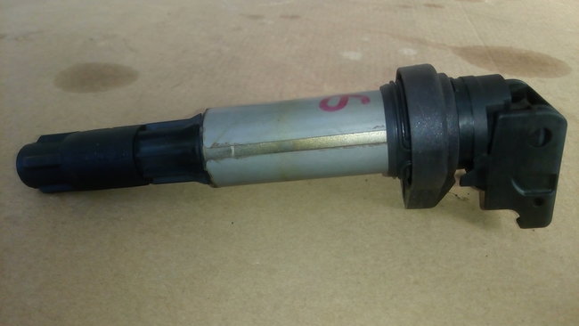

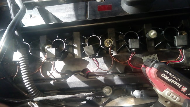

Thanks Joe. The pics are attached.
Pic 1,2,3 the burnt coil from cylinder 5.
Pic 4,5 Coil from cylinder 6 for comparison.
Pic 6 top view of the rocker cover area.
Pic 7 the spark plug well with the left portion of the coil in cylinder 5 .

Wow! That is certainly melted. Are you able to get long needle nose pliers down in there to remove it?
Once it is out, I need to know if there is oil down in the plug well and if you see any grey marks on the black rubber boot.

I couldn't remove the part of the coil pack which was stuck in the spark plug well using the long nose pliers as it was very stubborn. I removed the rocker cover then I was able to drill the filling of the coil pack, a cement like thing. Then I used the pliers to remove. I couldn't see any oil in the well.I also notice that the damage in the coil pack is half way in the middle. pics attached.

I looked at the pic. In all honesty, I suspect there was arcing where the rubber boot attached which caused it to overheat and melt down.
At this point, try replacing it and see if it happens again. I don't think it will.
