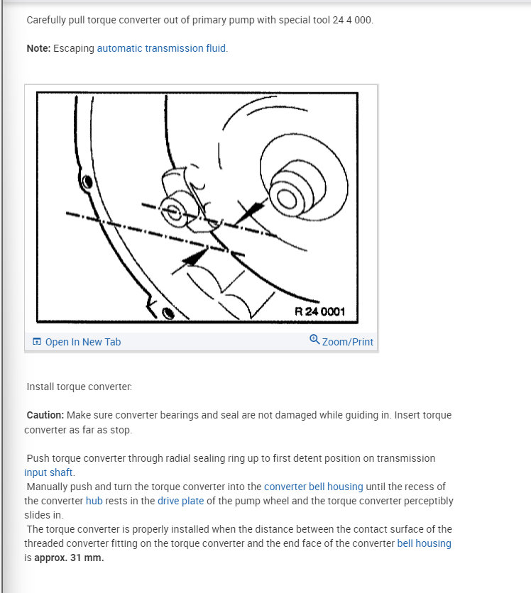

car revs, changes gear perfectly well and drives smoothly on plain ground but does not rev nor generate enough power to climb a hill or gradient at low speed. car does not have generate enough power to move from rest when the air condition system is switched on.

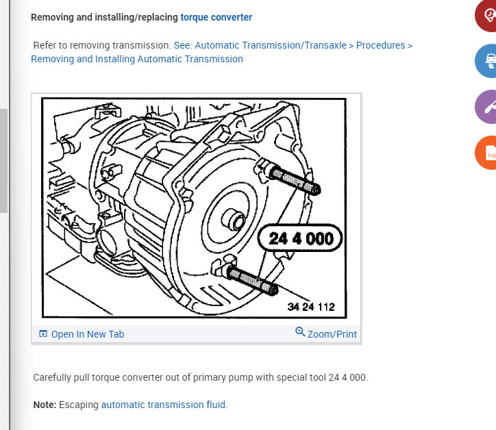

If the exhaust is not restricted, then I am pretty sure that this is a torque converter issue.
I have seen many times where the converter is not able to transfer the power from the engine to the transmission. Basically, the vehicle will be able to move as long as there are no hills or anything that the vehicle needs to overcome other than just the breakaway force of the tires. Basically, this feels like the engine has no power and is bogged down when trying to accelerate up a hill.
I am attaching the info below on installing a converter. Please let me know what questions you have and we can go from there.
