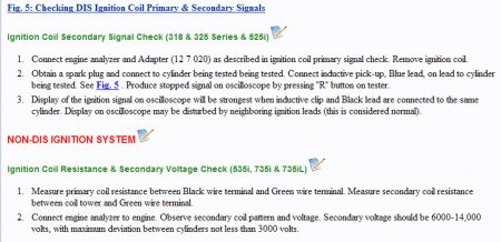

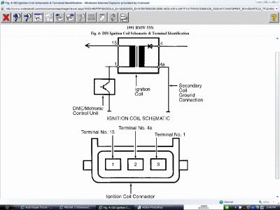

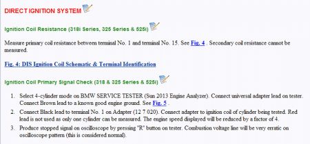

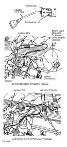

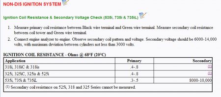

How to check ignition coils if good or bad :D
Saturday, October 20th, 2007 AT 4:38 PM
MERLIN2021
MECHANIC
17,250 POSTS
Unfortunatly if you have the DIS, or distributorless ignition system it's gonna be tough,
here are the guides...
