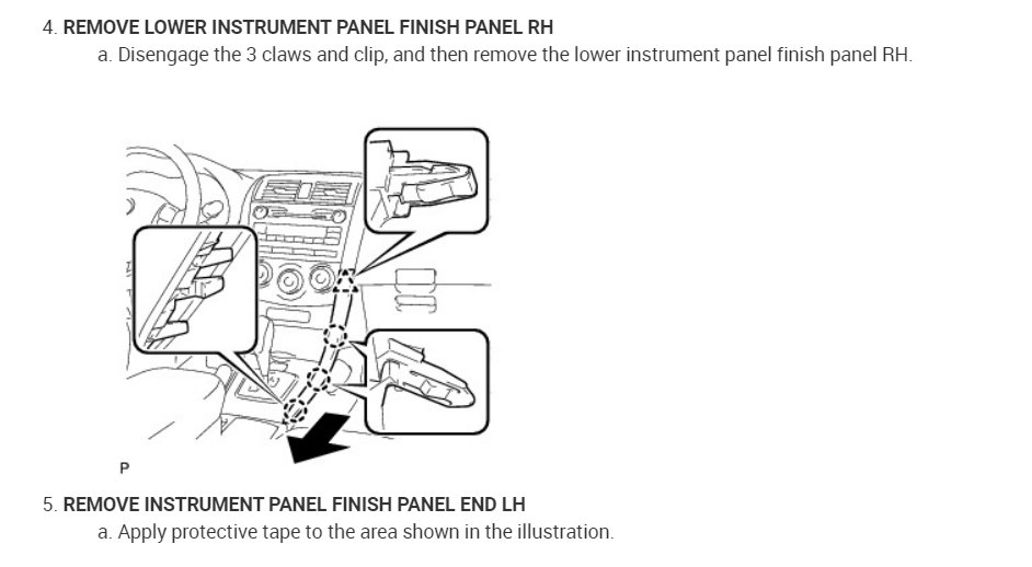

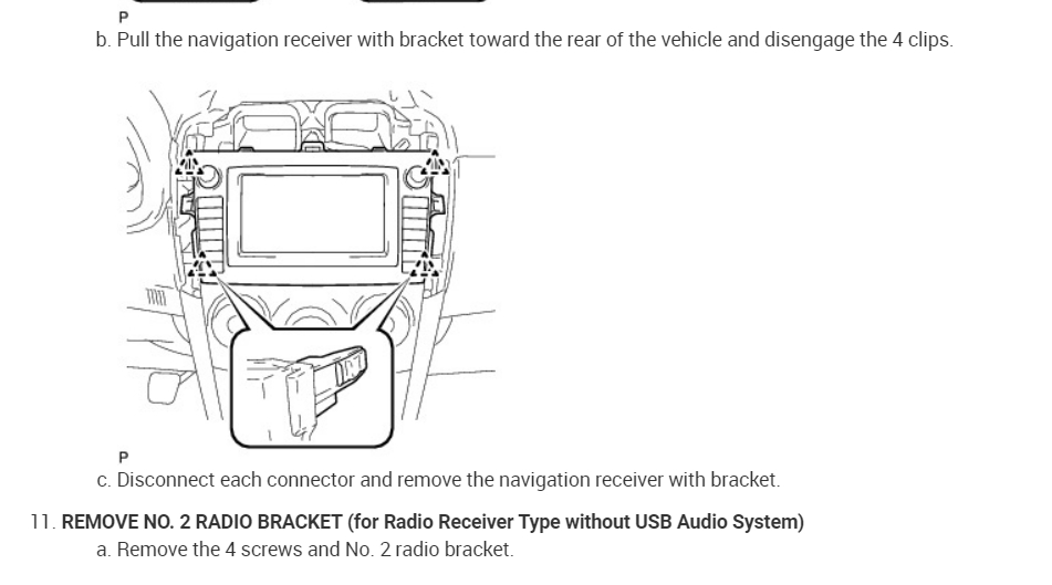

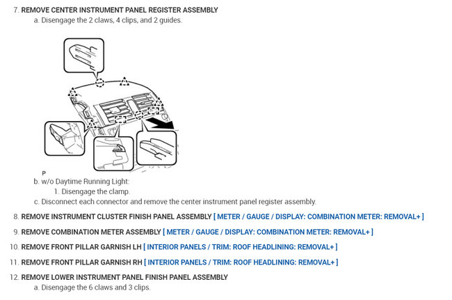

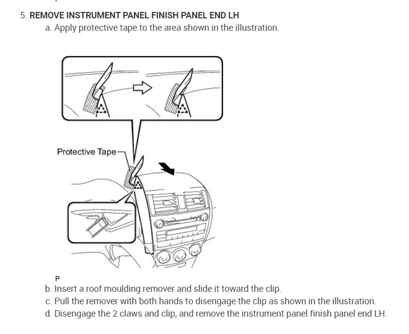

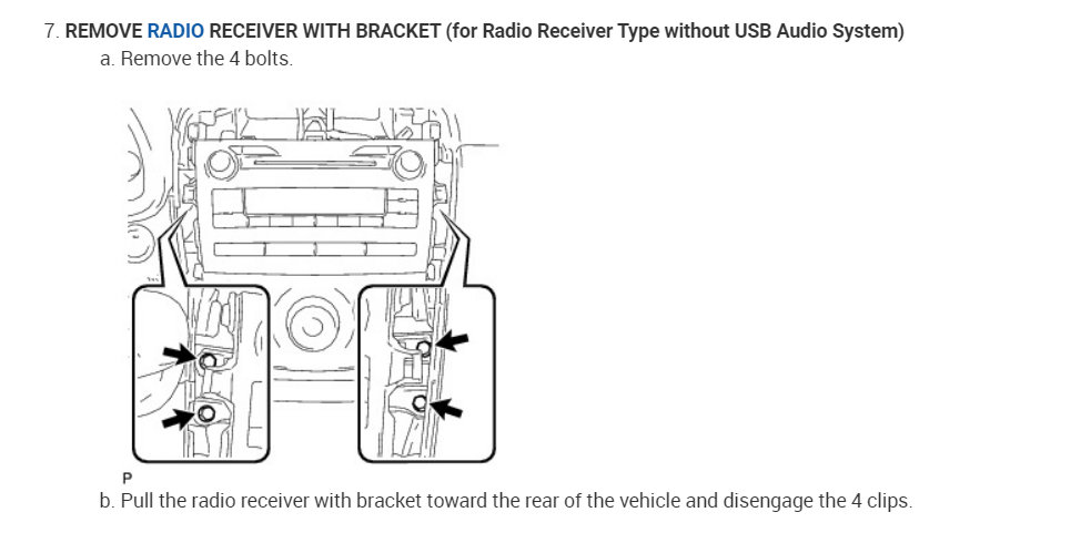

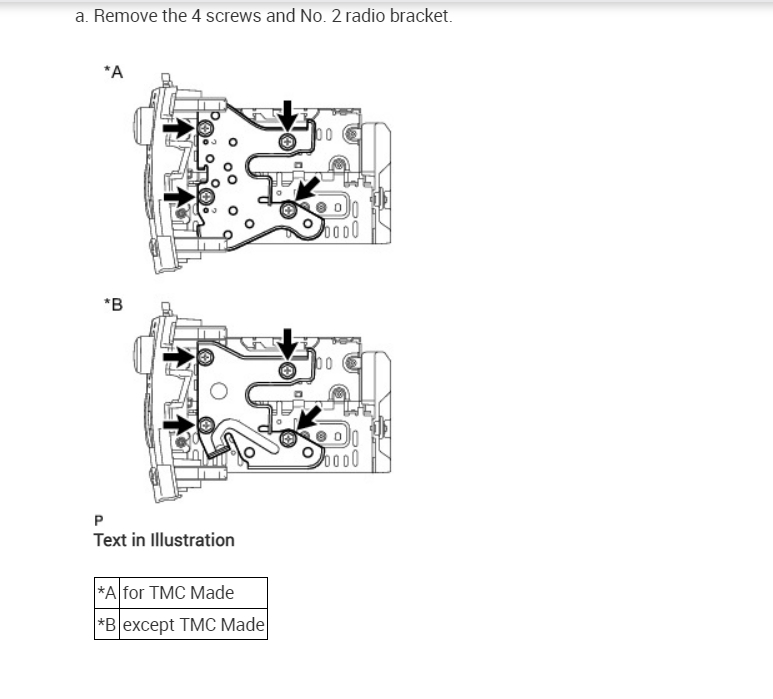

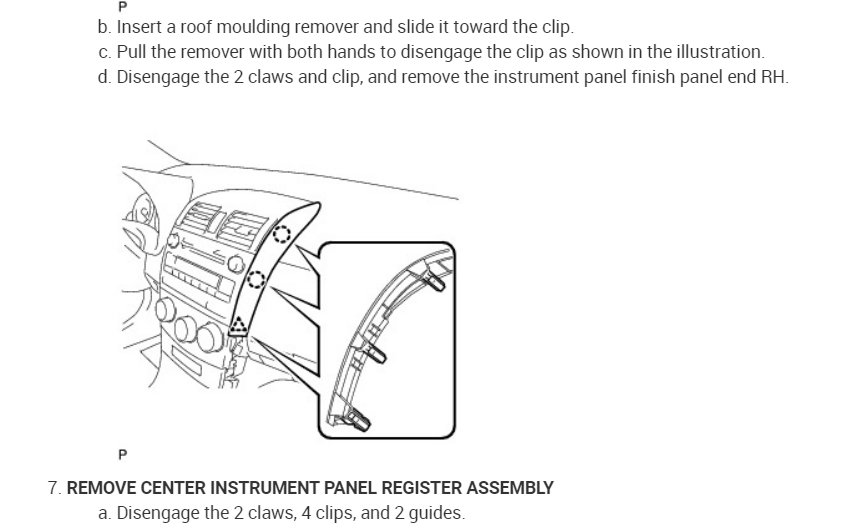

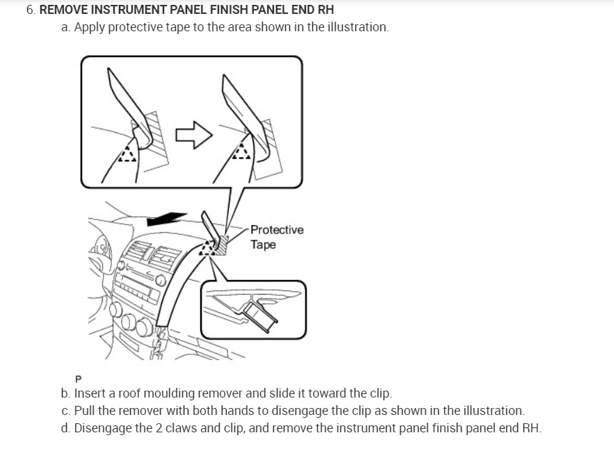

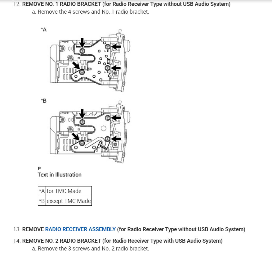

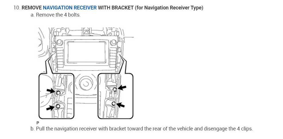

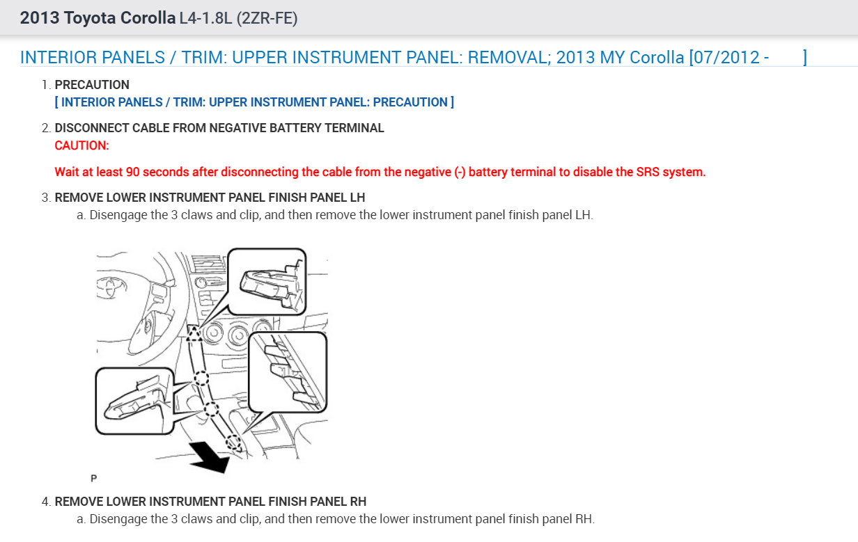

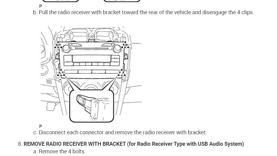

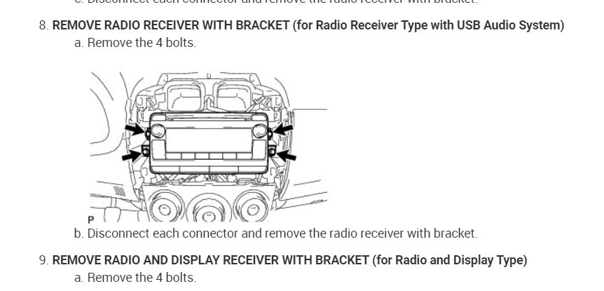

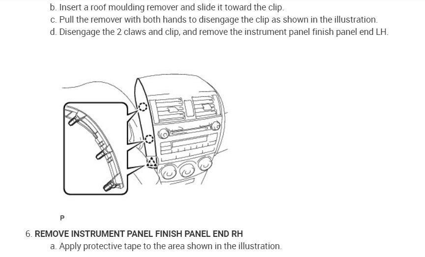

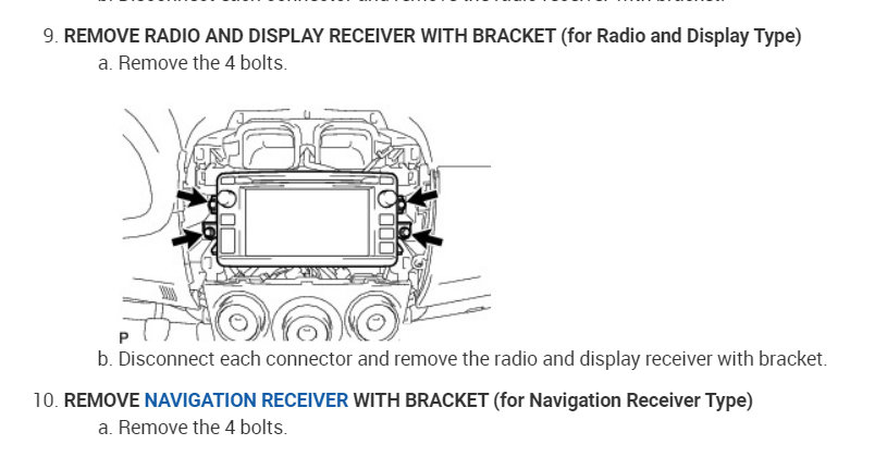

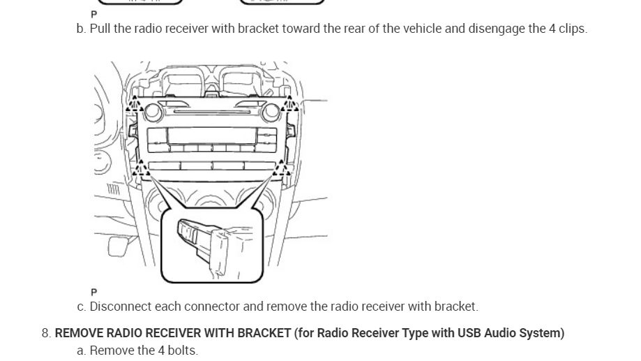

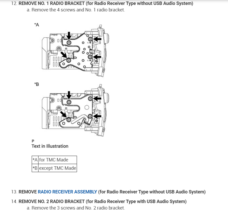

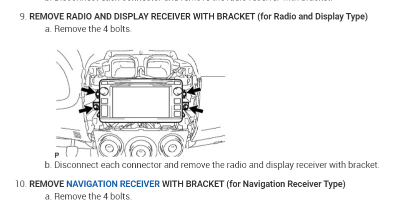

This can be one of two things I can think of. The first is one of the diodes inside of the alternator is starting to leak AC voltage which will cause the static you are hearing, so when you hear the fuzzy sound can you pull off the road and simply turn the engine off and leave the radio on to see if the fuzzy noise is gone. If not, the alternator is not the problem. Next is the player itself, there is an amplifier inside the radio that can degrade as it gets hot which causes the fuzzy sound, this means the radio will need to be replaced. Here are instructions on how to do so in the diagrams below so you can do it yourself or see what you are paying for if you have the job done or have an aftermarket unit installed. Check out the diagrams (below). Let us know what happens and please upload pictures or videos of the problem.

Is the second one about the player referring to JUST the radio, or Bluetooth as well? I mostly don’t play the radio (only Bluetooth) and that’s when it does the fuzzy and cutting out stuff.
Jul 7, 2022 at 3:43 PM
  • 54,837 POSTS
The Bluetooth still uses the radio amplifier to play the music, I checked out my post above and forgot to give you the guide on how to test the alternator diodes.
