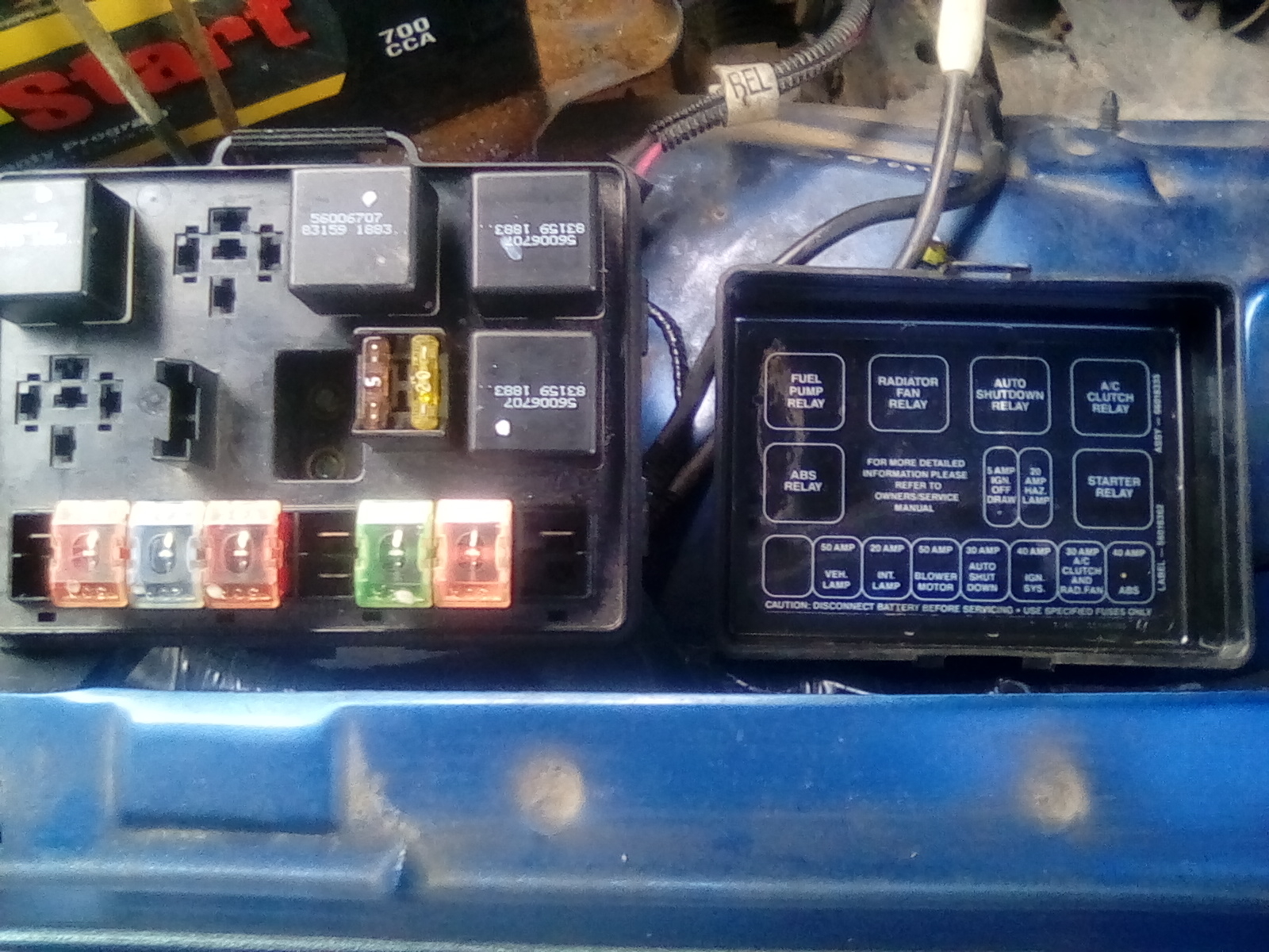

After I replaced the fuse i was able to run it in the driveway for about a week. I started looking at the wiring. Found one wire under the fuse box under the hood that had burnt through the rubber coating. I cleaned it off, wires seemed fine so I wrapped it in electrical tape. Started it up and she blew the fuse immediately. At $4.00 a pop I'll start being more cautious. I'm still going through wiring. Checking grounds. Asking questions.

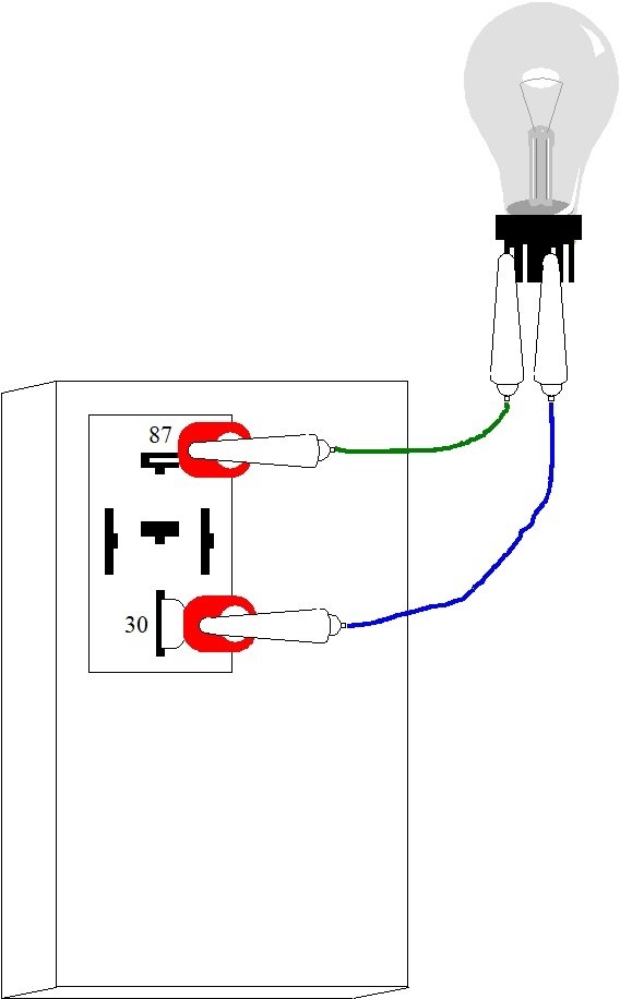

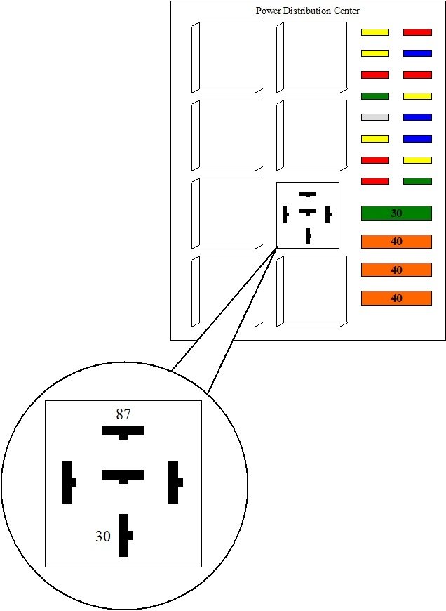

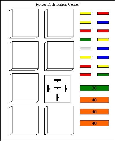

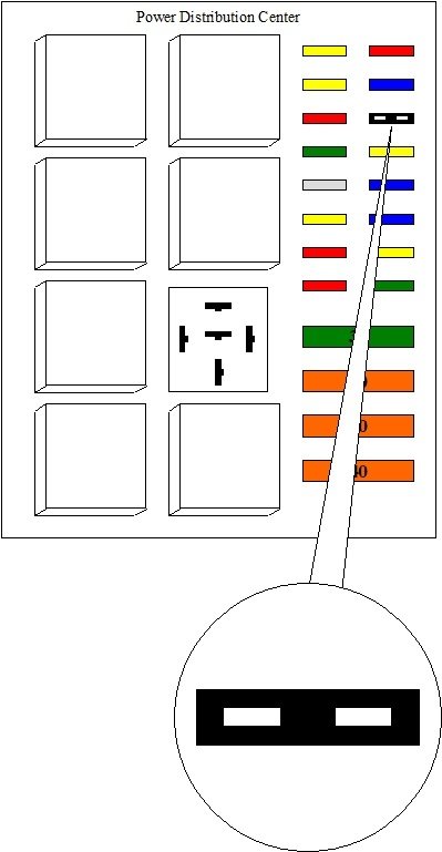

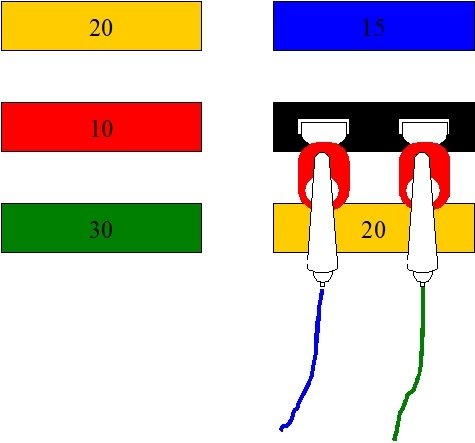

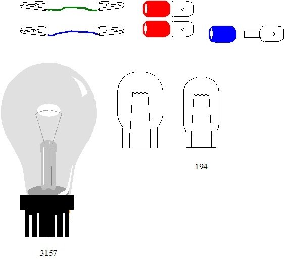

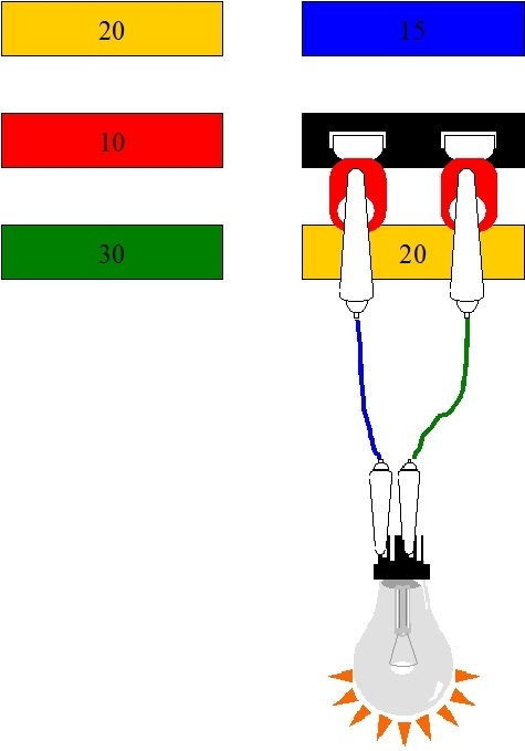

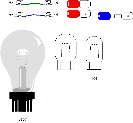

I put these drawings together to see if they will help. This pertains to bypassing the blowing fuse. Figure 1 shows a typical Power Distribution Center, (under-hood fuse box). One fuse has been pulled out. It is shown expanded in figure 2. Figure 3 shows the items you'll need. At the top are the small jumper wires. You can find these at Harbor Freight Tools or just about any hardware store. They typically come in a package of about a dozen for around three bucks. The terminals on the right are generic crimp-type replacement terminals. These can be found at the hardware stores and auto parts stores, but you have to buy a box of as many as 50. Instead, ask any mechanic. They often have a bunch running around loose in their tool boxes. If necessary, you can tug off the insulator at the end so the clip can be attached. That would be the blue terminal on the top right.
At the bottom left I showed my favorite bulb, a common 3157 brake light bulb. It's easy to connect the jumper wires to, but be aware it is going to limit current to one amp. Once the short is removed, the engine likely will not run because one amp isn't enough to run everything on that circuit. It will run one the fuse is installed.

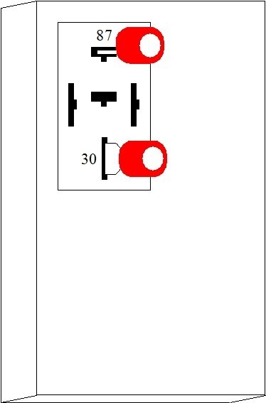

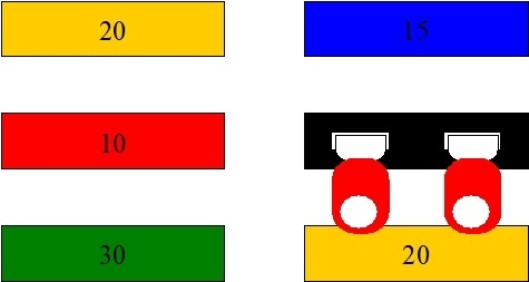

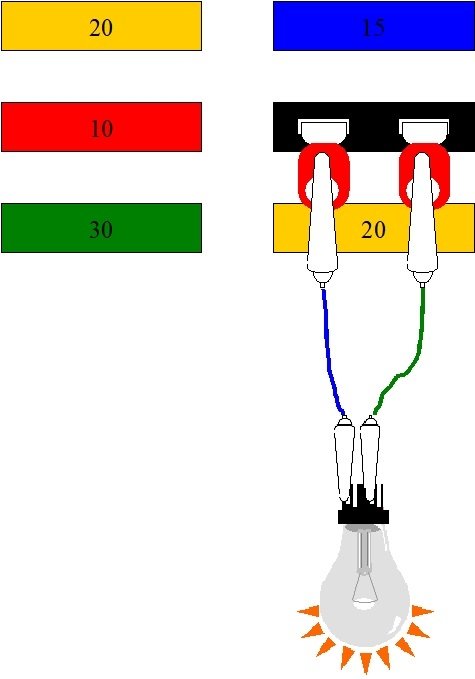

Connecting these parts takes all of a half minute. Plug the two spade terminals into the empty fuse socket as shown in the fourth drawing. Connect a clip lead, (jumper wire), to each one as shown, then the other ends to the light bulb.
If the short is constant, as soon as you connect the second jumper wire, the bulb will turn on full brightness and will get hot. Now you can move wire harness around and unplug things to see what makes the short go away. When the short is not in the circuit, the bulb will get dim or go out.
If the bulb is dim when you connect the last clip lead, the short is not there at that time. The same procedure applies. Move the wire harnesses around until the bulb flickers or flashes bright. When it does, whatever you're doing is related to the location of the short. No need to turn on the ignition switch, and no more wasted fuses.

Here's the procedure if you'd rather bypass the ASD relay. Either way the bulb will limit current to a safe value, one amp. The results will be the same but you must plug the bulb into the fuse socket or the relay socket, not both. If you plug it into the fuse socket, the rely must be in place. Or, if you plug the bulb into the relay socket, the fuse must be in its place.
The relay I drew is the common 1" cube relay used most often. Use terminals 30 and 87. If your ASD relay is the skinnier style, use the two larger terminals the arrows are pointing to in the fifth drawing.

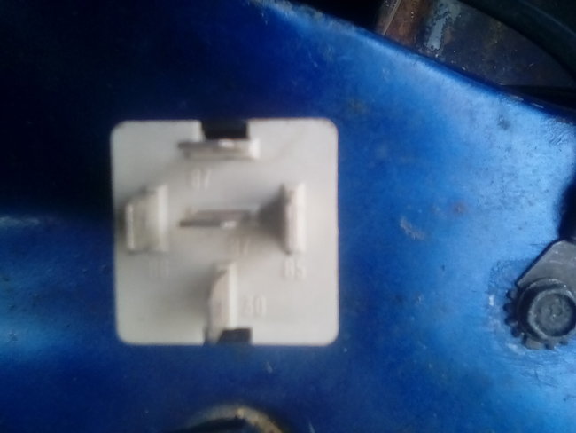

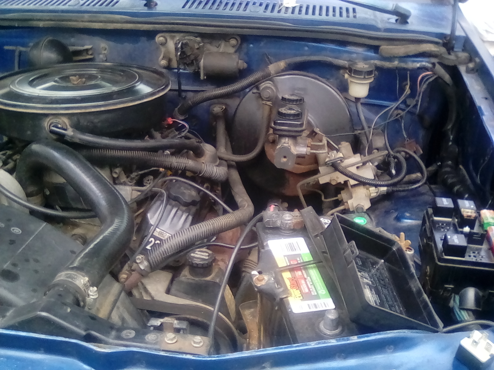

Did you get my reply from this morning? It's not showing up. New to site so not sure how site works. The relay has two terminals marked 87. The one in the middle is 87 also. Didn't realize I could send photos so easily. I'm a little tech challenged. The third photo of course is a long range look at my baby. Going for jumper wires. Thanks

I see you. That center terminal is "87A". It is not used in about 99 percent of applications. When the relay is not energized, as in turned off, terminals 87A and 30 are connected internally. When the relay is turned on, the internal movable contact flips to connect 87 and 30 together and send current to the circuit. At that time, the connection between 87A and 30 is broken. At the moment, I can't even think of a common circuit that uses terminal 87A. GM relays don't even have a corresponding terminal.
