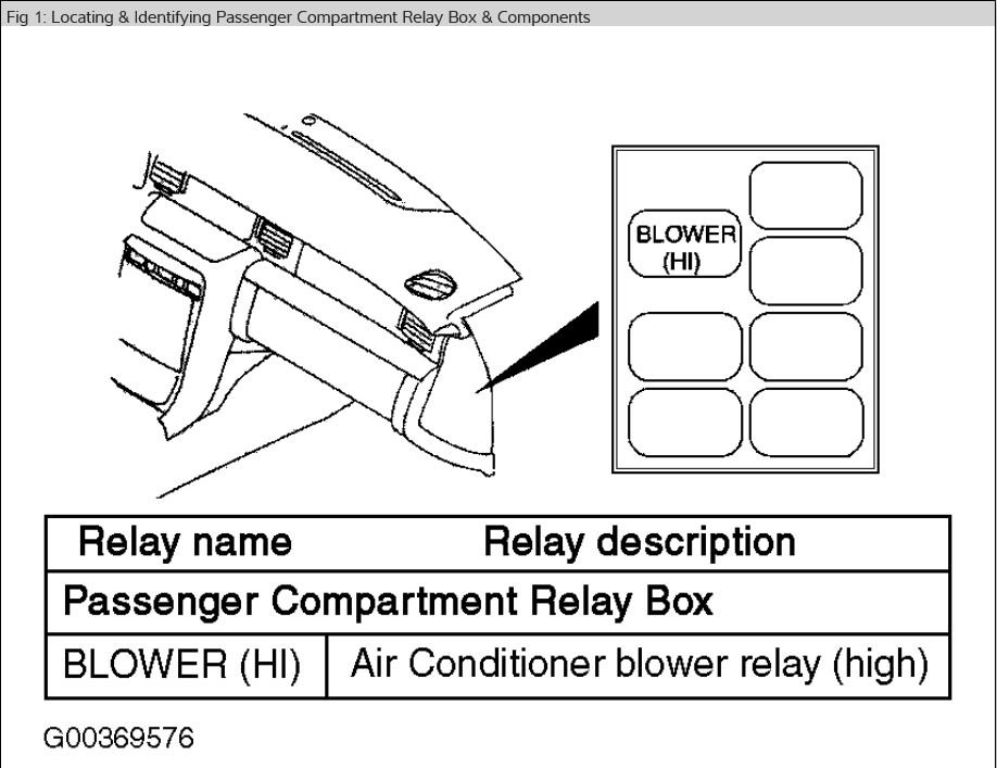

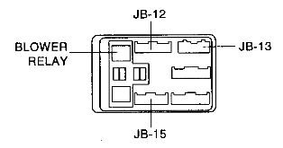

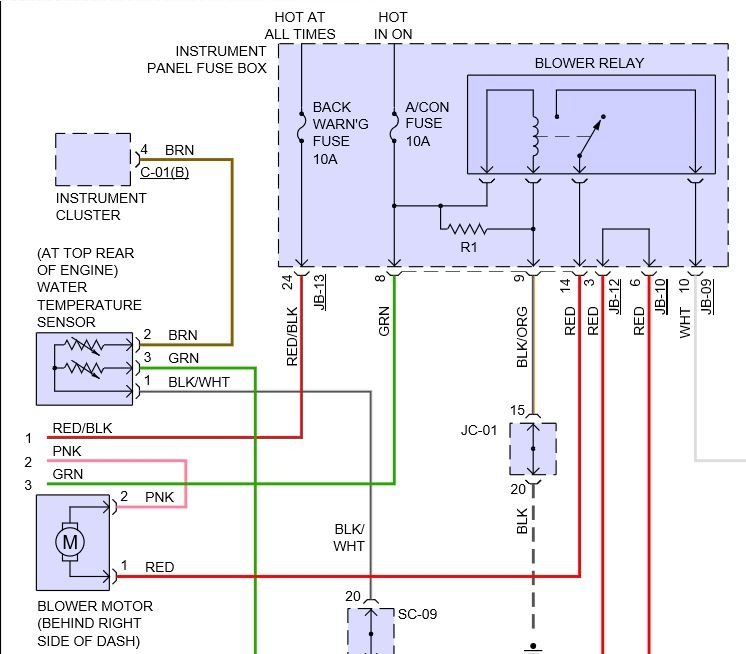

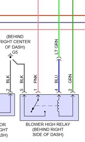

Blower only runs on high. How do I replace blower motor relay?
Aug 24, 2018 at 1:24 AM
PATENTED_REPAIR_PRO
  • 1,853 POSTS
It is located in the instrument panel fuse box, which is shown in this diagram. I see this also has a blower high relay located right side of dash.motor.

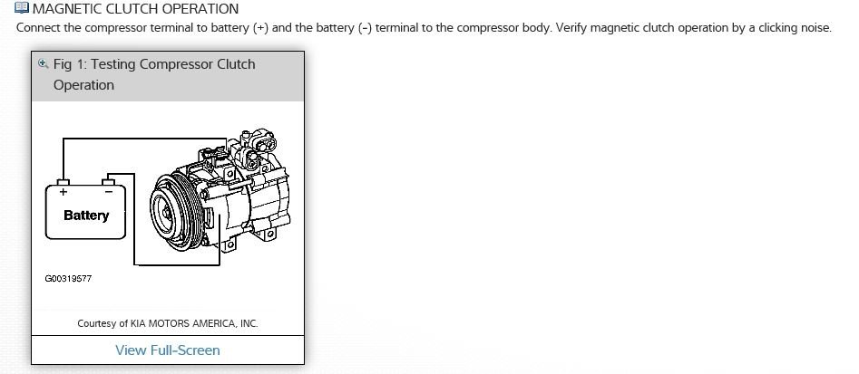

First of all, how did you go from wanting to replace a blower relay to a bad AC compressor? He might have just meant the AC compressor clutch was bad. If so, they can usually be replaced alone. Here is a simple test for that clutch.
