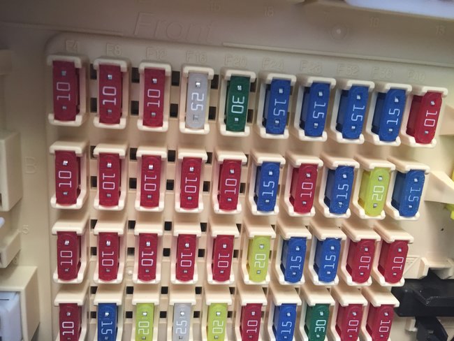

The AC/heater blower motor will not come on. There are no blown fuses in either fuse block, that I can see. I cannot find the blower relay.

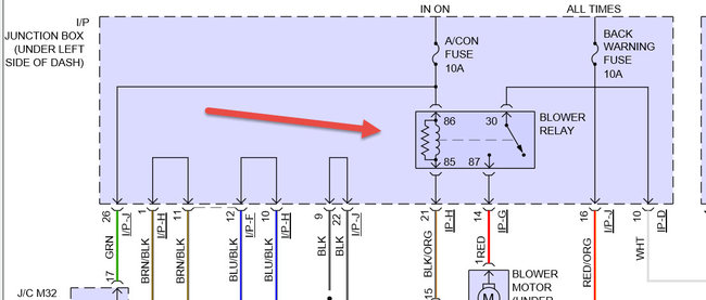

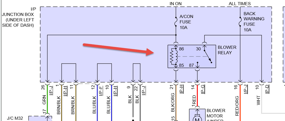

see picture for location. it is in dash fuse box.

There is only fuses in in the dash fuse box.

It is located in the engine compartment.

I found the relay, replaced it but it didn't help. If it hadn't have rained all day today I would have removed the blower motor. I will let you know if that fixes the problem. Hate let my wife drive it without being able to use the defrost function.

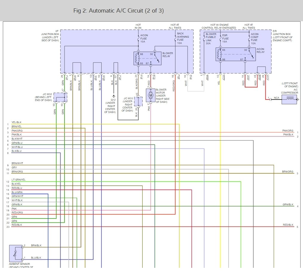

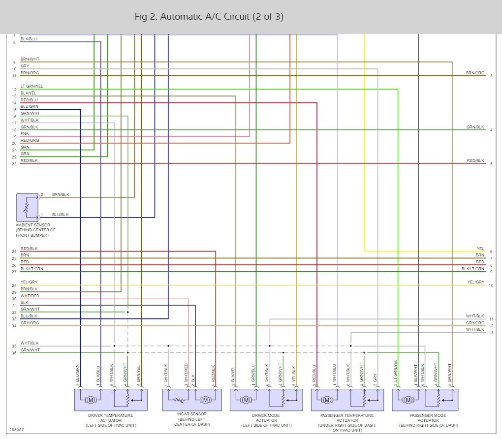

Here is a complete wiring diagram for the car, check for power at the relay first then go from there. It looks like there is a fusible link 30 amp, check there first.

Thanks Ken, the blower motor runs when wired directly to the battery, and I have 9.4 volts at the connector, but still won't run using the control panel. So I guess it's back to Kia to have them check it out.
