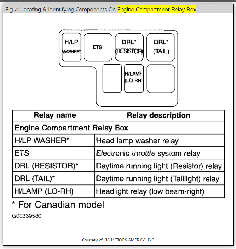

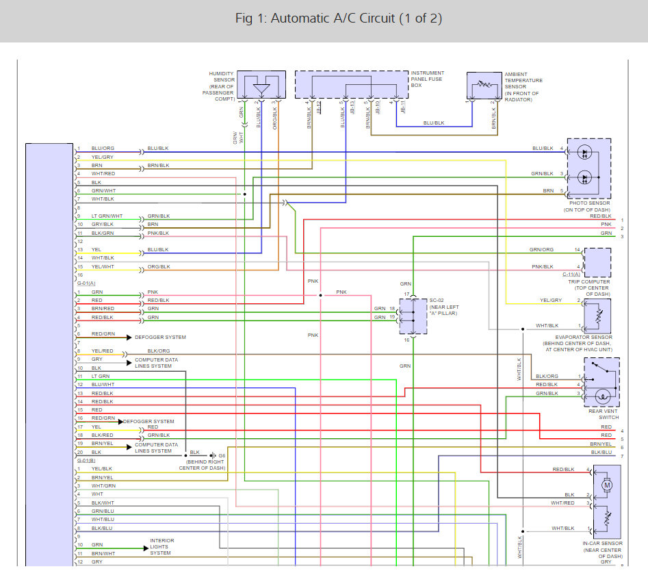

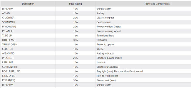

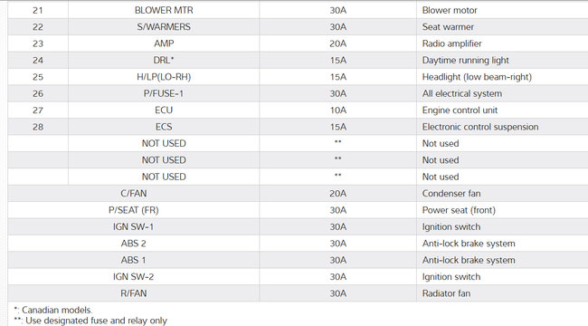

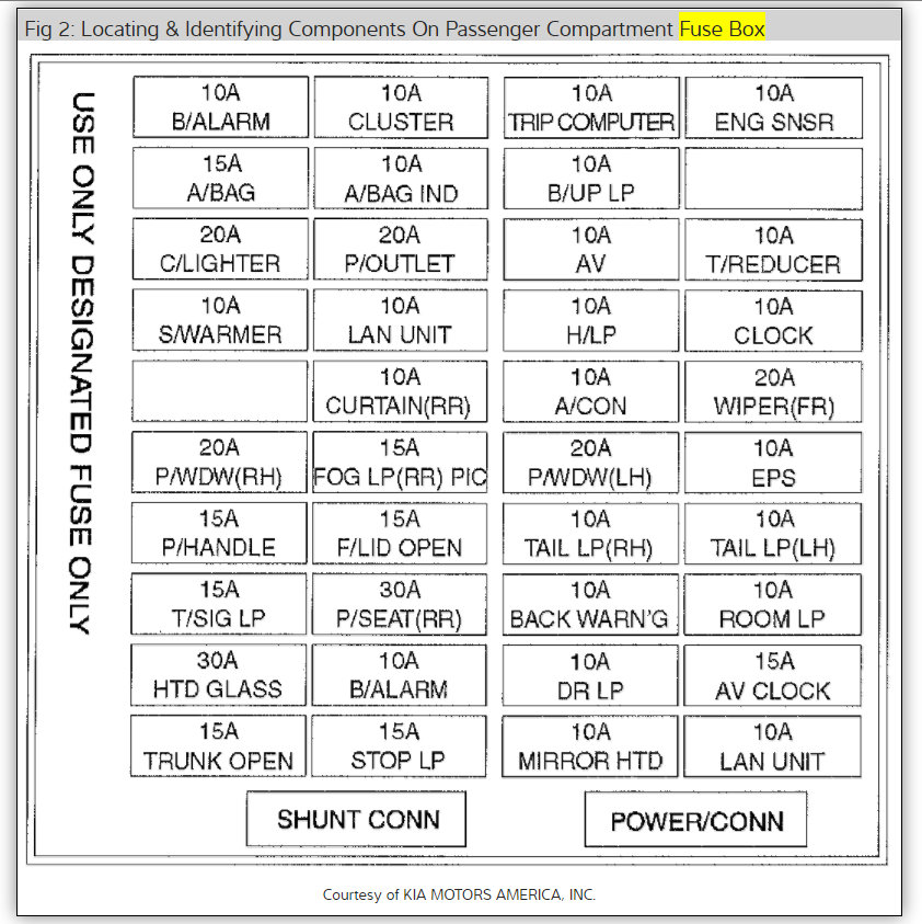

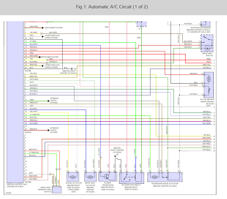

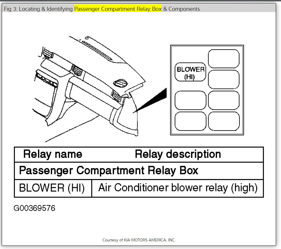

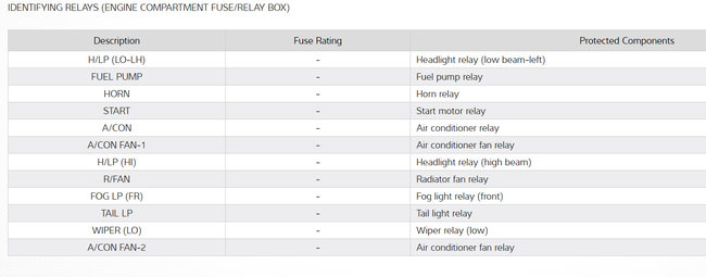

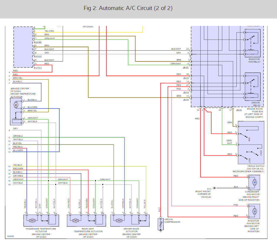

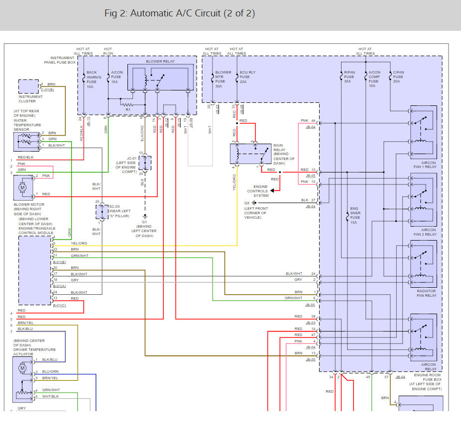

There is a blower motor relay that is out here are the blower motor and air conditioner wiring diagrams so you can see how the system works and a guide on how to test the relay.

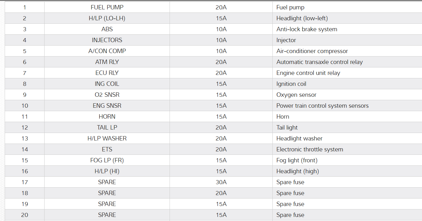

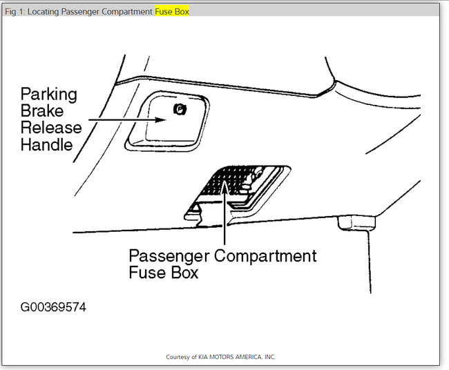

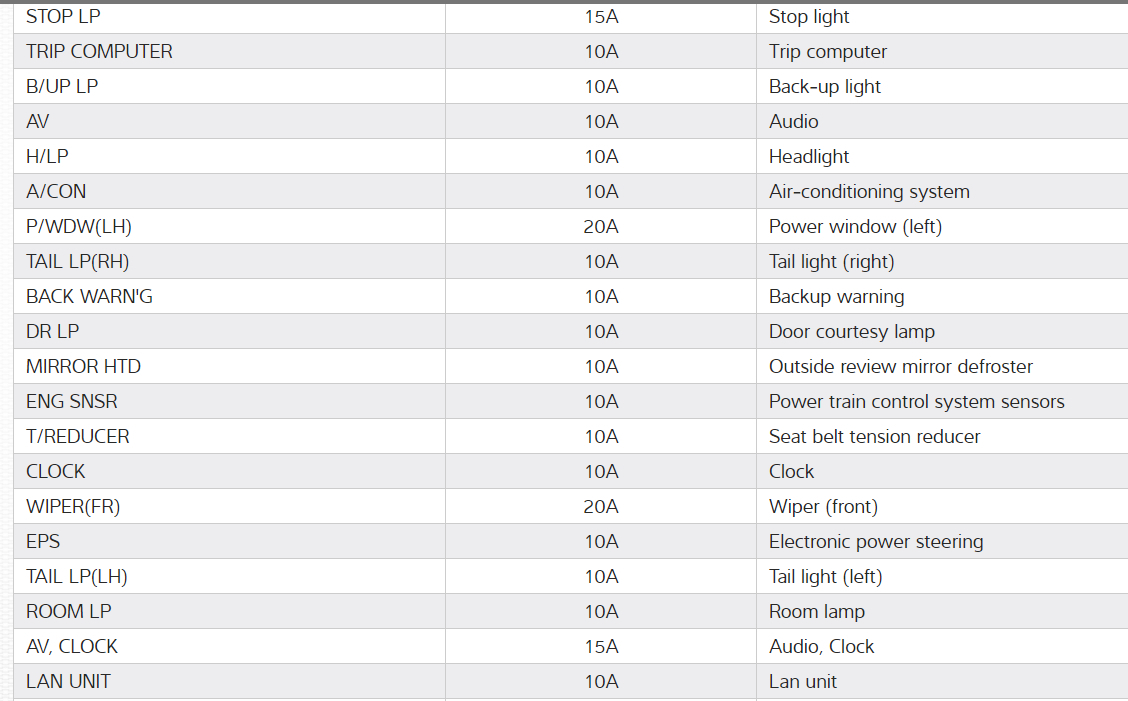

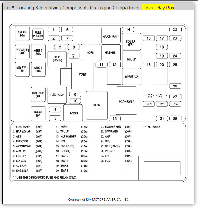

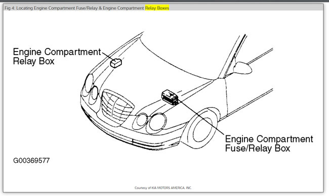

Here is the blower relay and fuse locations
Cheers

Just because the relay clicks does not mean it is working, did you try removing the relay and jumping it using a wire?

I believe there is a relay. Check under the hood for the relay block and see if you can locate it.
Also, I'm a little confused. The resister is what changes the fan speed. The inside switch just sends power to different connectors on the resister. The power should remain consistant and change based on which section of the resister the power is sent to.
Let me know what you find. Also, let me know if there is 12 volts to the switch on the dash.

Kia calls it a 'power transistor' There are only 3 pins on the plug that plugs into the transistor. I was told to check the voltage between pin 1 and pin 2 and that's where I got the different voltage readings based on the speed on the dash. We maybe talking about two different things. I know the hi-relay is getting something because it 'clicks' when I put it on high speed, but no power to the motor. Would the relay 'click' if it weren't getting power?
