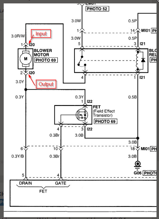

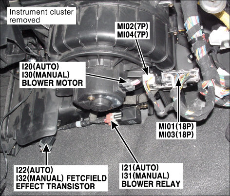

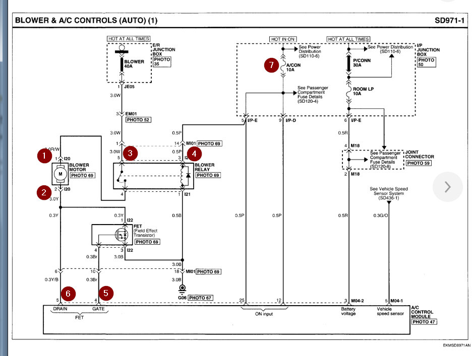

I have voltage at the blower. I have replaced the blower. Resistor, relay and control panel. I have voltage at the blower motor plug. I ran a ground directly to the frame thinking it was bad. Still not working.
Apr 19, 2020 at 1:06 AM
I can understand your issue because this blower motor is a two wire motor meaning you put voltage to one side and the other side is "ground."
However, in this case the blower relay feeds power to the blower motor and then the ground in this case goes through the resistor and back to the control module. This is called a ground side control device which means the HVAC module will increase resistance in the FET/resistor to slow the blower motor. When there is an increase in resistance behind the load in a circuit it takes voltage away from the motor to make it through the added resistance later in the circuit which slows the motor down.
So when you took the ground to actual ground, you bypassed the module and it is no longer a completed circuit.
Let's start by putting the wiring back how it was and then check voltage at both pin 4 and 5 at the HVAC module with the blower motor on high.
Let me know and we can go from there. Thanks

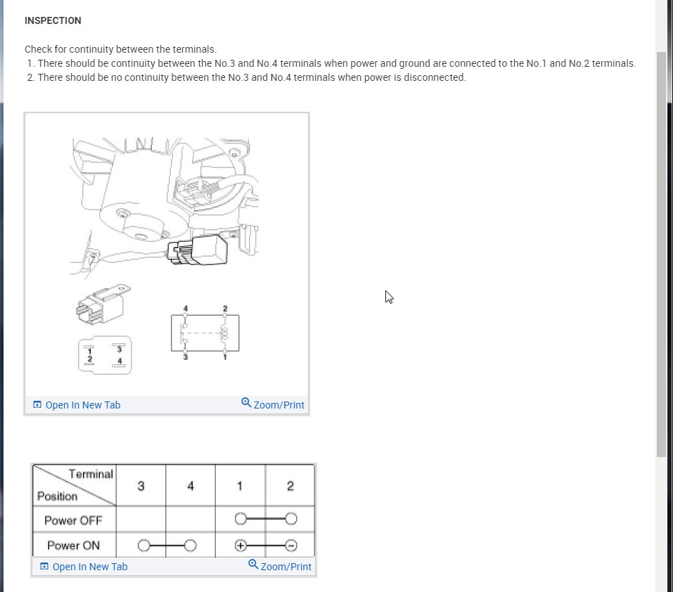

Okay. So with the relay in and the blower motor on high you have 0 volts at the HVAC Module?
If this the case have we checked the blower motor to see if it even comes on when we give it power and ground separate from the vehicle? Basically just take two jumper wires and connect the to the battery positive and negative then apply the 12 volts to terminal 1 of the actual motor and the ground to pin 2. The motor should come on. Once we confirm the motor works we can revisit this. Thanks

Input:
Low-9.15v
Med-5.56v
High-.05v
Output:
Low:3.84
Med-3.68
High-0.00
Apr 20, 2020 at 6:33 AM

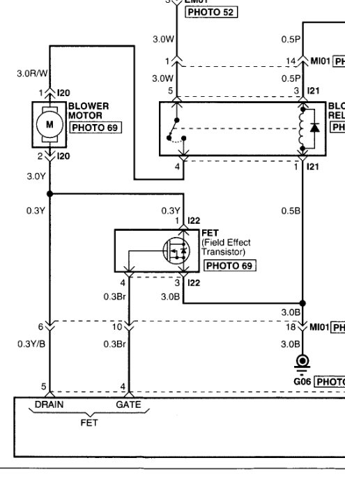

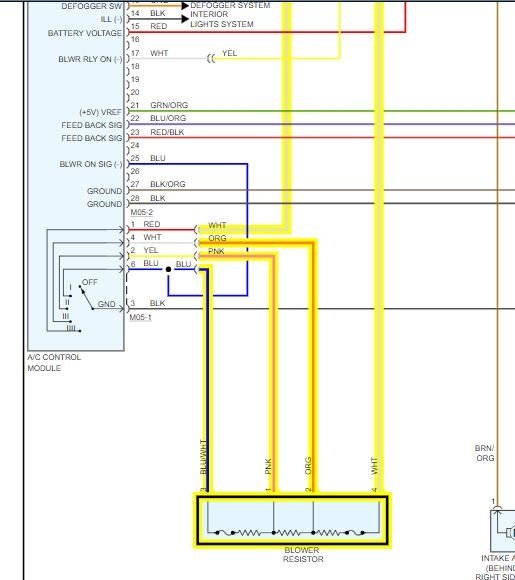

So these were at the points in this diagram with the fan plugged in and on each setting? The fan didn't run at all when you took these as well?
I am asking this because those look backwards at best but just not correct for each setting. I expected the input side to be around 12v and output around 0 on high. Then changing as you dropped to low. On low setting I expected the input to be around 4 volts and then around 8 volts on the output side of the fan. Basically the more voltage the fan uses the faster it goes. High should be the speed it was when you put 12 volts to it to check the operation of the fan.

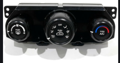

At this point, the only thing I can think is the HVAC module is screwed up but you said you replaced the control panel. That was the picture below correct?
If that is the case, the only thing left is wiring. Are familiar with taking resistance reading on the wiring? Basically you unhook the connectors on both ends and then take ohm readings on that wire. It should be less then a half ohm on each wire.
Let me know and maybe the best this would be is to run a couple new wires as an easy way to find out if it is wiring. Thanks
Apr 21, 2020 at 2:03 AM
JERRY ARCHER
  • 25 POSTS
I replaced the control panel with one I got off eBay. I wouldn't trust that. If you think it's the control panel. I will purchase a new one.
Apr 21, 2020 at 3:44 AM
Okay. Before you do that, was this issue the same before you replaced that and did it make any change? Before you buy another one, put the old one back in and take the same voltage measurements. It is highly unlikely that they are both doing the same thing.

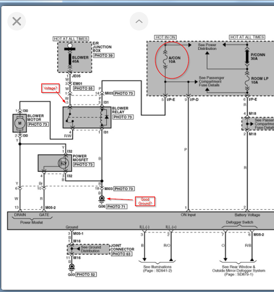

Okay. Clearly this is not making much sense but I think we have a grounding issue with the FET. You can run a redundant ground from the FET to a good ground. Then we need to check a couple other things. First the ACON fuse just to make sure. Lastly measure voltage at the power wire (number 5) at the relay and tell me what you have.
We will figure this out. I am sure of it. Thanks
Apr 27, 2020 at 1:09 AM
JERRY ARCHER
  • 25 POSTS
Ground wire did nothing.
13.92vdc with the relay out.
Zero with the relay in. At white wire #5 to ground.

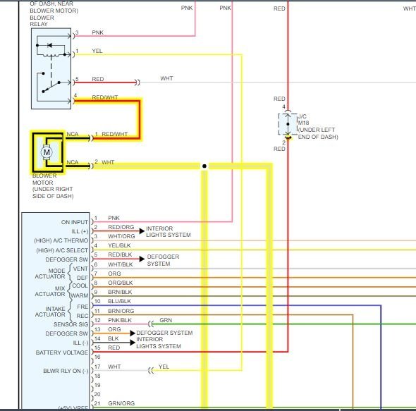

Good morning,
Can I approach this in a different way?
Can you tell me if you have voltage to the red/white wire at the blower with the key in the on position?
I attached a diagram as well.
Apr 29, 2020 at 10:51 PM
JERRY ARCHER
  • 25 POSTS
With the key in the "on" position. From red and white at blower to a ground stud I have zero voltage. With the plug removed from the blower motor. I have 13.09vdc from the red and white wire to a ground stud.
Apr 30, 2020 at 6:55 AM

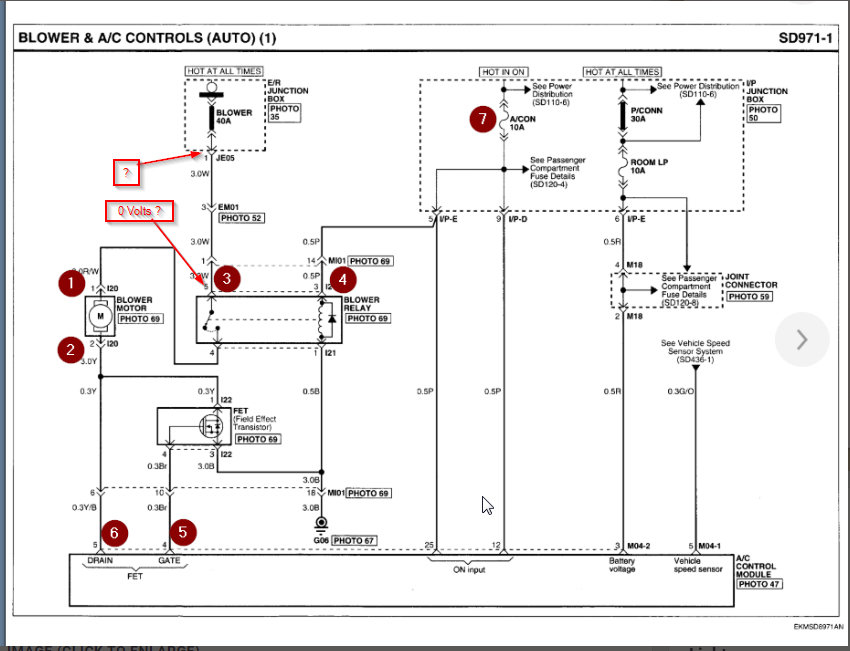

So anytime we get to a point like this, we are either missing something or making an assumption of something that is not true. So I understand that you have taken all these measurements but can we write them down on one sheet of paper and that may jump out at us as to what the issue is.
Then list the parts that you have replaced that I am missing in this list or if you didn't replace one of them.
1. FET
2. Blower Motor
3. Blower Relay
4. Control Module
In the last 12 years as a service engineer, I have had some tough issues but always figured them out. This one is confusing because we are assuming something is supposed to work a way that it is not.
It will require patients but I am sure we can figure this out. Thanks.

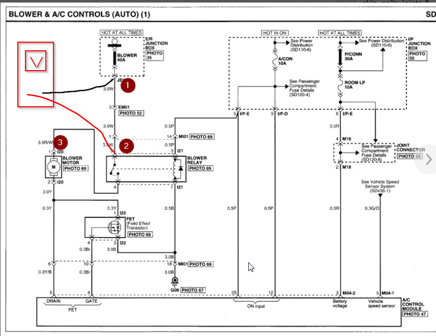

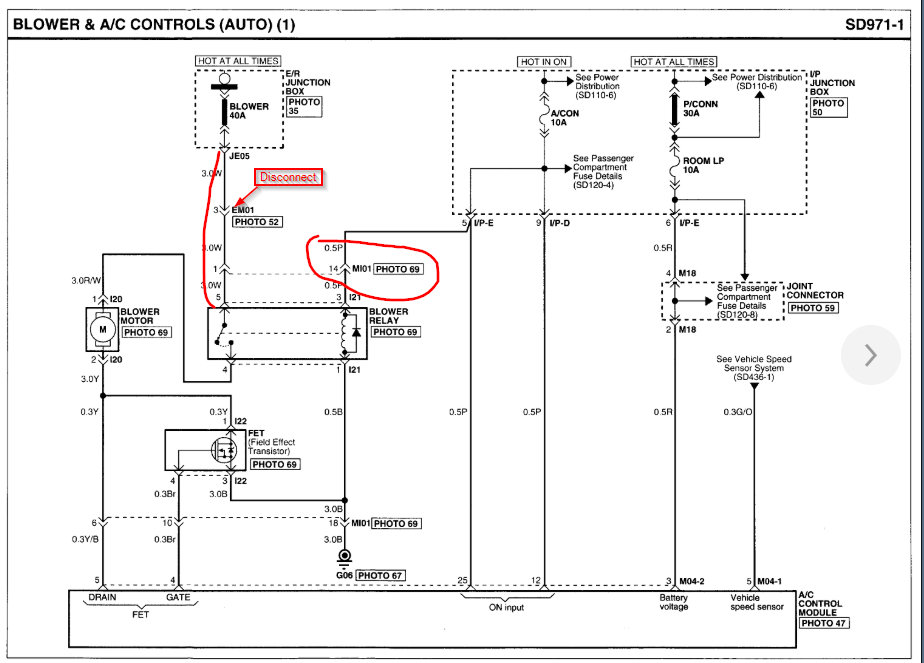

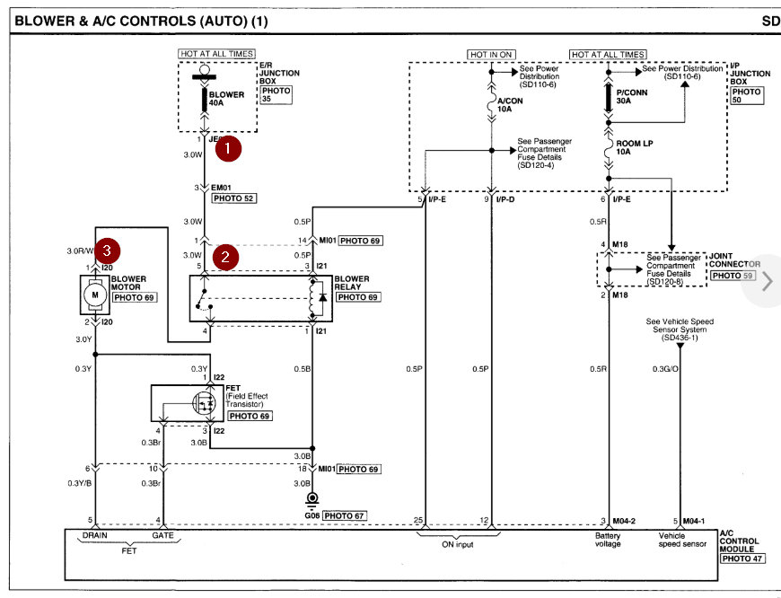

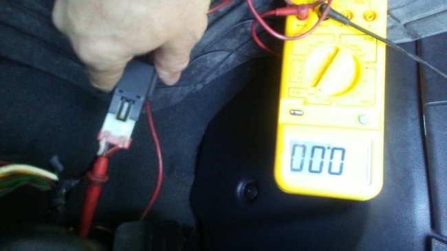

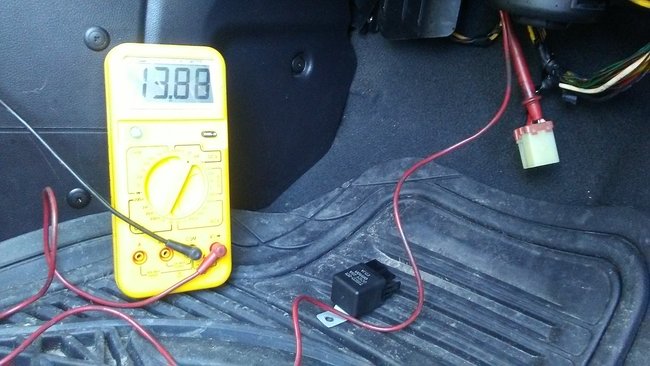

So we may be circling here but you have 0 volts at number 3? If so go back and check it at the fuse and see if you have 0 volts. You should have 12 volts on this wire at all times.
May 3, 2020 at 9:50 AM
JERRY ARCHER
  • 25 POSTS
That is exactly right. When the relay is installed I have zero volts. When the relay is removed. Now I have voltage. I sent two pictures to show what I mean.
May 5, 2020 at 7:07 AM
Okay. Let's check voltage drop on that wire from the junction block to the relay. Basically just measure voltage from point 1 to 2 with the relay in and the blower turned on.
Then measure voltage from point 2 to 3 with the same settings.
Lastly to prove out the entire control side of the system let's just 12 volts to number 3 and then try to change the fan speed using the normal controls. Are you able to increase and decrease the fan speed when you put 12 volts to the fan?
May 6, 2020 at 1:59 AM
JERRY ARCHER
  • 25 POSTS

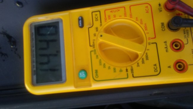

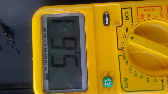

Okay, couple things. 1. I have 12 vdc going to the white wire to the relay. When the ignition is off. 2. I have 13.89 vdc going to the white wire on the relay when the vehicle is running. As soon as I close the circuit the in any way the voltage drops the zero. I open the circuit up and the voltage reappears. Now I noticed the white wire does not run directly from the fuse to the relay plug. It runs through this other module. What module is that? I have not replaced that module. I have enclosed pictures.
May 7, 2020 at 1:37 AM

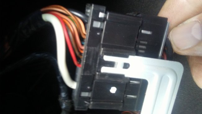

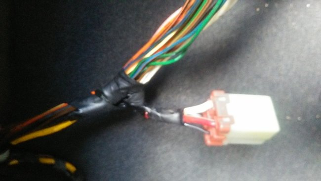

I don't know. That is not on any of the wiring diagrams. It only shows some inline connectors not a module. Is there a part number on it?
I just want to confirm you understood what I was asking for. I know you have those voltages at those spots on the white wire but I want you to do a voltage drop test on the white wire with everything hooked up. That means put your black lead at one end of the circuit and the red at the other. Take a look at this diagram. This will tell us what the voltage is on that wire.
May 7, 2020 at 12:07 PM
JERRY ARCHER
  • 25 POSTS
I took voltages as you asked. The higher voltage is with the car running the lower voltage is with the car off. I also sent a better picture of that module that I found online. There is not a part number on the module. It's labeled MI01, MI03.
May 7, 2020 at 10:18 PM
So I found that as well and that is the inline connector. I am not sure why it looks like a module but it appears that is all it is, is just a connector. It was hard to tell from your picture but does it have wires coming out of both sides? If it does then that is an inline connector.
If so, I want you to unhook the other inline connector and run a wire from the fuse to the relay. You should not have 5.5 volts on that circuit. That is just a wire from the fuse to the relay so I would expect there to only be less then a volt. That indicates there is resistance in that circuit. If you run a wire from the fuse to the relay see if the fan turns on. If so you need to run a new wire and you can just bypass those two inline connectors. We can talk more about that after we find out. Thanks
