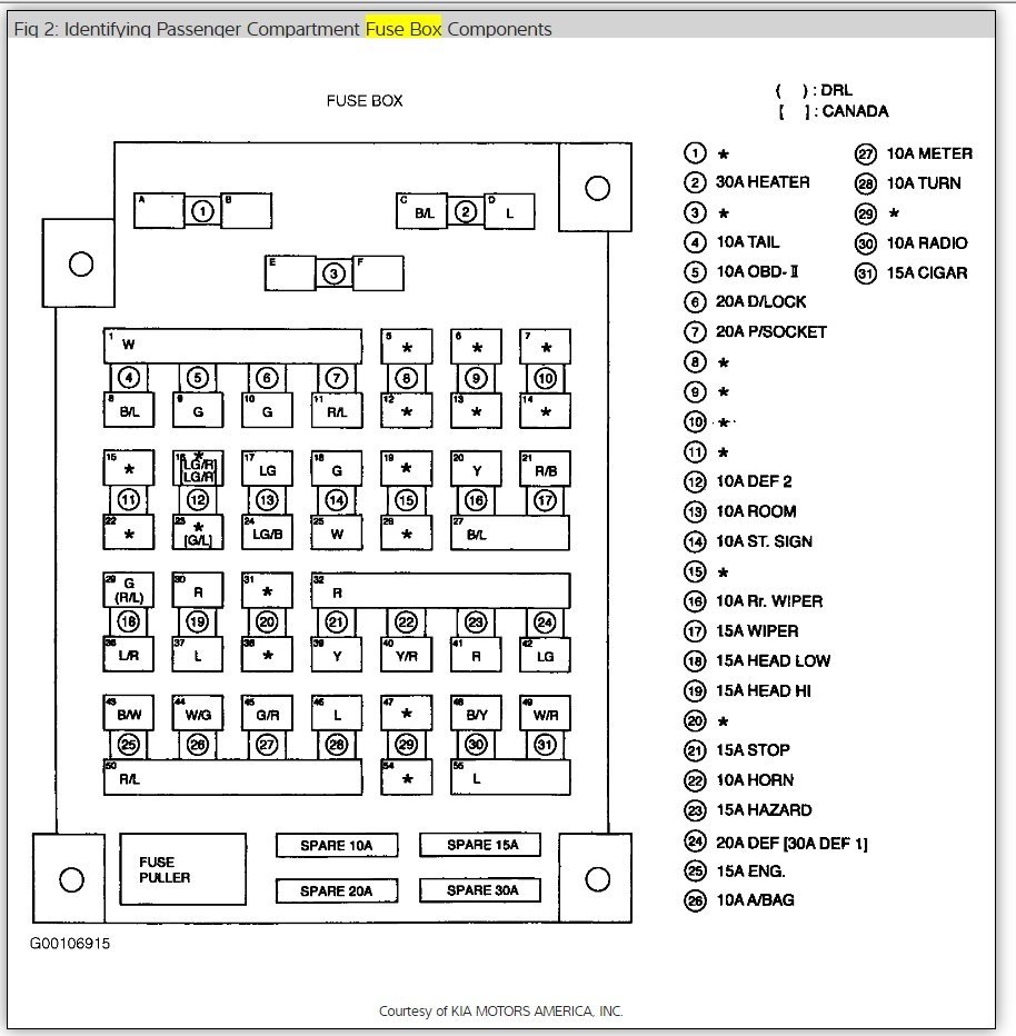

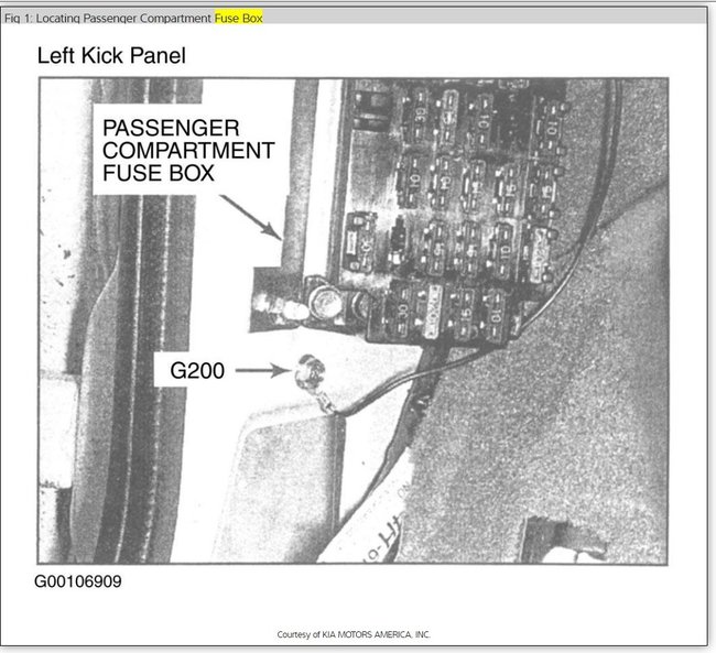

My heater fan quit blowing. is it a bad fuse on the kick panel. what else could be wrong? how do i get at the fan or the switch? how do i get the dashboard apart? how much might a dealer charge me?
Feb 8, 2009 at 2:23 PM
  • 54,840 POSTS
Hey DONK55
Please check the fuses first. below is a diagram of the fuse panel and a guide to show you how to check the fuses.

Check HEATER fuse (30-amp). Fuse is located in passenger compartment fuse block, on left side kick panel. If fuse is okay, go to next step. If fuse is blown, repair short in wiring harness. See WIRING DIAGRAMS. Replace fuse.

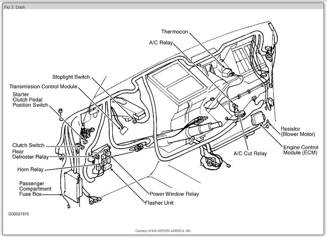

BMRFIXIT
  • 19,053 POSTS
check fuses
unplug motor wires
turn key on ,place fan switch on high
use a test light or a volt meter check for power and ground at the motor wiring
plug
what do you have missing
if power check fuses ,relay and ignition switch
if no ground suspect speed resister
