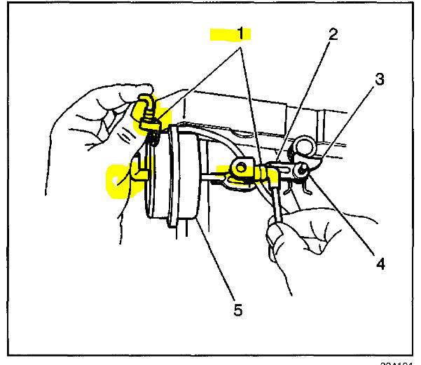

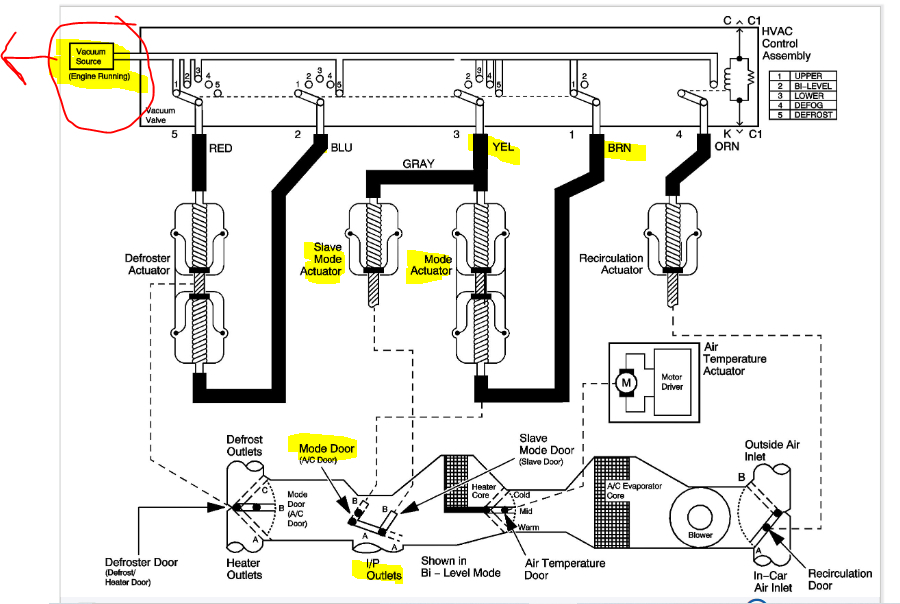

No, the resister isn't the issue. At some point in the system, there is an engine vacuum leak. The mode door actuator that controls air flow direction operates with engine vacuum. When you go up hill and your foot is heavier on the throttle, it causes vacuum to drop in the engine simply because the throttle plate is opened further.
When that happens, there is less available vacuum to the mode door actuator which is causing it to move or change the airflow direction to a different location. In most cases, it is to the defroster.
First, with the engine running, turn the fan on low and change the airflow direction to see if you hear a hissing sound or anything that sounds like a vacuum from under the dash. The actuator is on the passenger side under the glove box. I attached a picture of what it looks like and highlighted the vacuum hoses.
Pic 2 shows the entire system. I highlighted the mode actuators. Note the Plastic vacuum hoses to them are known to dry out and break. Also, the arrow in the upper left of the picture shows the vacuum supply is from the engine. We may have a leak under the hood as well.
Start with this and let me know if you find an issue.

Thanks for the feedback, 1st i checked under the hood and seen that the round vacuum ball hose was not connected, and i see that this was why the low and high speeds as explained in my question, but your diagram did help and will keep for future references. So far ,i been checking all the vacuum lines and found one that had trannny fluid inside ,not much,but on the one actuator(# 52470773) the plunger is not working. Inow have to find and locate on,which are discontinued,nobody has these,and are hard to find.. So i will have to blow out the line with very little air ,again (2nd time ) and start my hunt for the part. Thanks for all the feedback so far and will try to solve this weak air issues in my vents. Too hot to be working outside ( 95 - 100 Degrees) the past 30 days here in PA. Will keep you update, Thanks again and god bless for the research you do for me.
