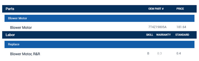

I can't get the connector for the blower motor to plug in.
Jun 30, 2022 at 10:09 PM
AL514
  • 5,639 POSTS

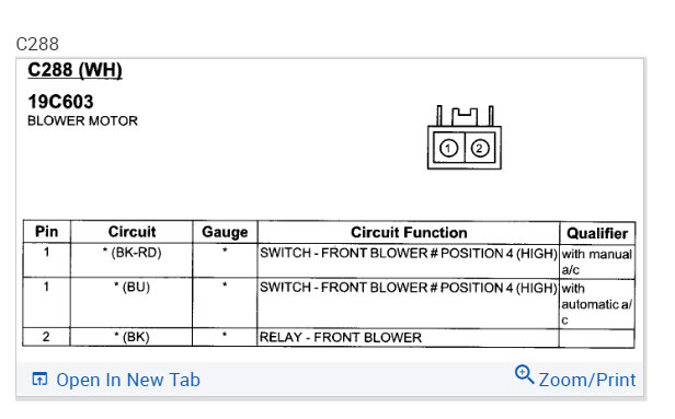

Hello, did you recently replace the blower motor and now the new one won't plug in?
Here is the correct Ford part number. And the connector plug diagram.
