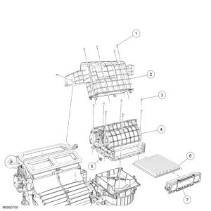

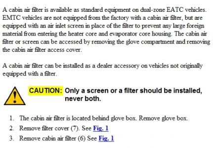

How do I find the Cabin filter and change it ??

https://images.2carpros.com/forum/automotive_pictures/261618_Noname_2457.jpg
https://images.2carpros.com/forum/automotive_pictures/261618_Graphic_610.jpg
Jul 14, 2010 at 3:56 AM
