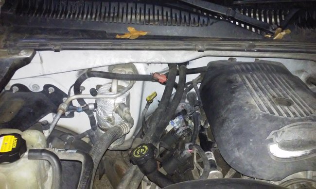

Im not wrong I have the wiring diagrams if u want ill go take a pic of my fire wall and show there are no wires on it
Tuesday, January 5th, 2016 AT 3:35 PM
BRADLEY7576
  • 17 POSTS

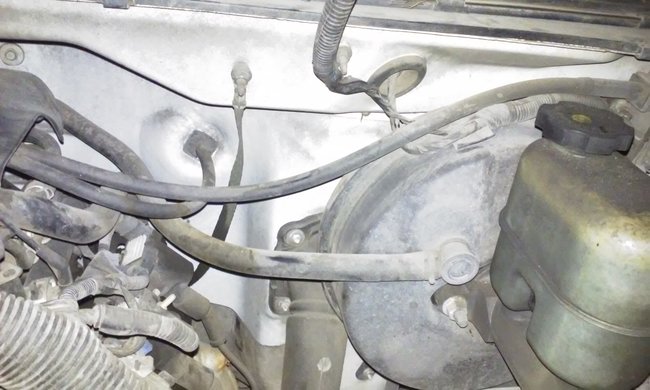

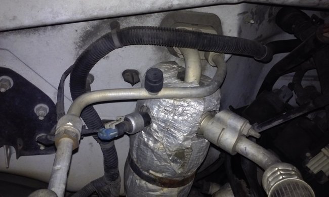

See pics the wire going across my fire wall go to the front of the truck not through it
Tuesday, January 5th, 2016 AT 4:08 PM
BRADLEY7576
  • 17 POSTS
I don't think u understand what im sayin neither organge wire goes to either fuse box. If I disconnected the ground wires at the top of my dash then the entire resistor harness would come off the truck completely

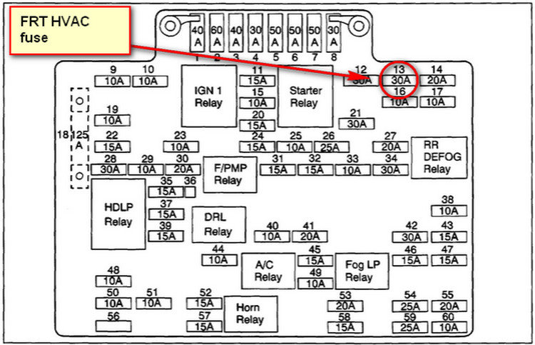

Look, I gave you very simple instructions for a test that should have taken 5 minutes total. Nothing had to come apart. You not only ignored my instructions, but you have half the truck apart and now you want to argue with me about how the truck is wired. I'm betting your whole problem is nothing but a blown fuse. I'm posting a diagram of the fuse box with the correct fuse circled.
This is my last post.
Tuesday, January 5th, 2016 AT 4:25 PM

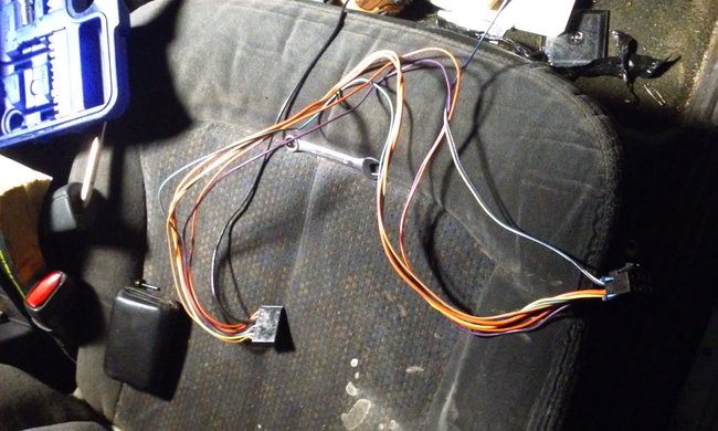

I have replaced every single fuse. And checked them after and they are still good. Im not ignoring ur instructions I have done them. Im telling u the wire going to the resistor is not contected to any other wires. If u cant help me then fine I understand that but I just don't understand u getting mad im the one that's fighting this thing. And if ur so pissed then tell me why if there is a organge wire coming from the fuse panel under the hood then why can I take the resistor harness completely off the truck with out cutting any wires. They are attached to nothing

RESISTOR HARNESS COMPLETELY OFF NO WIRES FROM FUSE TO HARNESS. BLACK WIRE IS GROUND WIRE I REMOVED FROM TOP OF DASH. LEFT SIDE IS RESISTOR PLUG RIGHT SIDE IS FOR REAR AIR WHICH IS NOT EQUIPT

Ok problem has been solved. Found the wire from the fuse panel that I thought was going out the top of the fire wall to be a plug that got lodged behind the box I guess when someone either replaced the heater core or the top of the heater box. Got it unlodged pluged it to the resistor harness and boom power to the fan on all speeds
