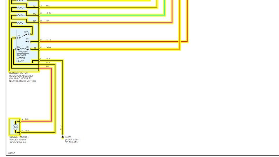

blower fan works intermitantly, the finally quit completely.
Jun 30, 2020 at 3:42 AM

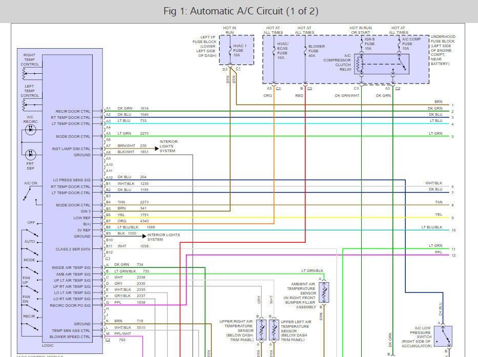

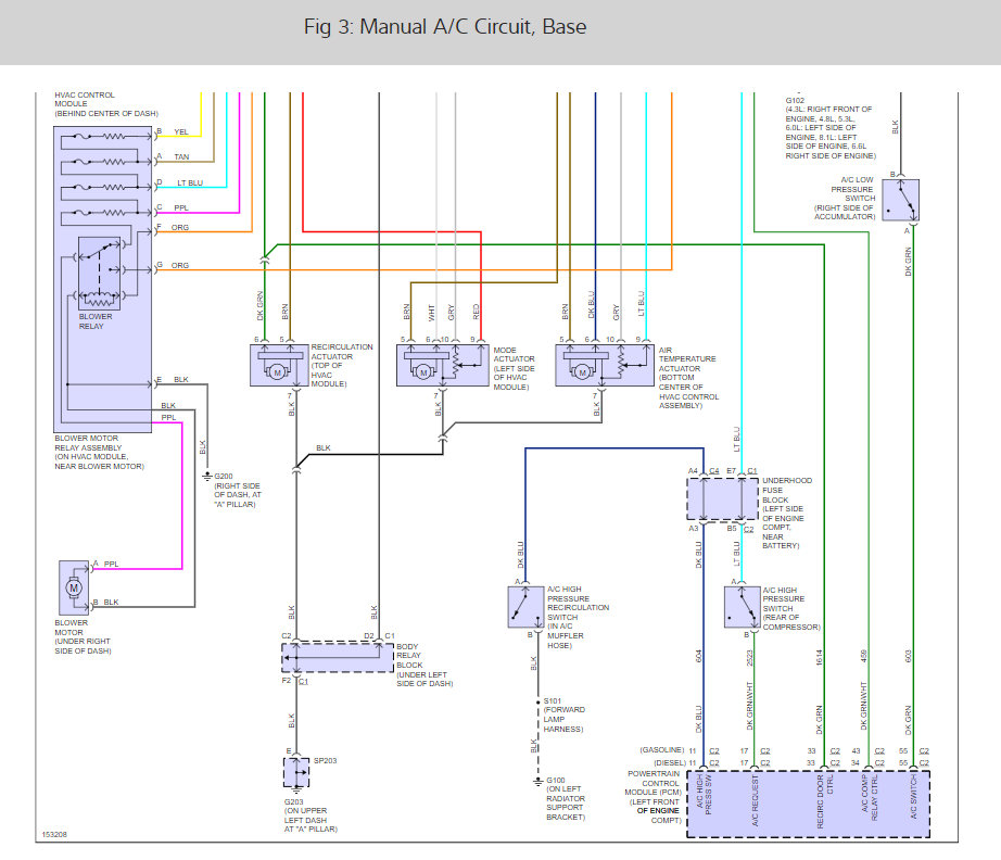

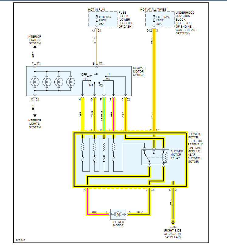

Good afternoon.
I attached a wiring diagram for you to view.
We need to do some testing for the blower motor control circuit.
Do you have a volt meter or test light to do some testing? This could be the blower motor itself or the resistor.

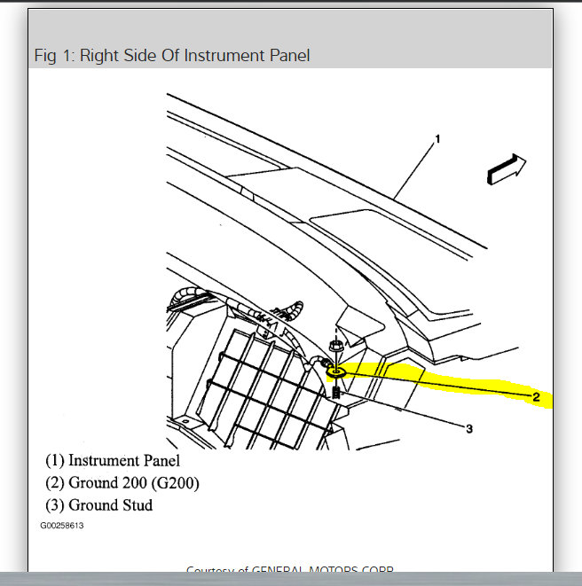

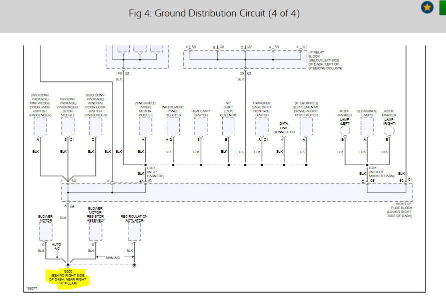

BFELDHAHN
The AC and blower motor will be working fine and then it just stops (on all speeds), and the AC and re-circulation lights stay lit. If I turn the engine off/on it seemed to fix it for a while but it is becoming a more frequent issue and restarting the engine has no effect. If I mess with it i.e turn it off for a period of time or just keep cycling the AC/re-circulation buttons it may come on. I'm not really sure that performing these actions really had anything to do with temporary resolution of my issue but all I can find on the Internet is the resistor issue. I took advantage of the resistor recall and had Chevrolet replace the resistor but that has been at least 5 years ago. Any help would be appreciated.
Apr 30, 2021 at 7:23 AM (Merged)

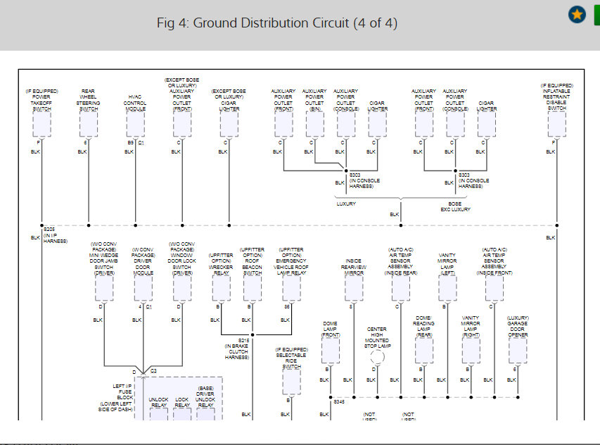

SCGRANTURISMO
  • 4,897 POSTS

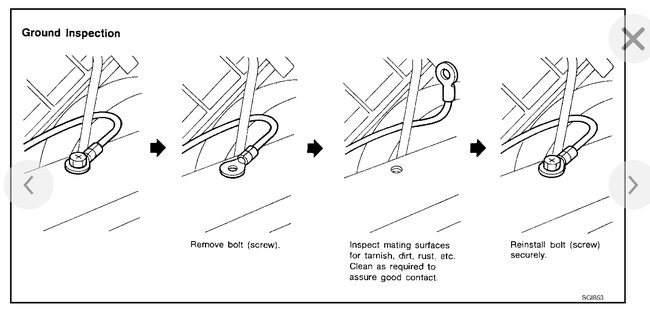

This could be a problem with Ground #200, which is located on the right side of the dashboard. In the diagrams down below I have included the Ground Distribution Wiring Diagram for your vehicle's Blower Motor, as well as a diagram of the location of Ground #200, and a guide for how to inspect the ground. Please go through these guides and get back to us with what you are able to find out.
Thanks,
Alex

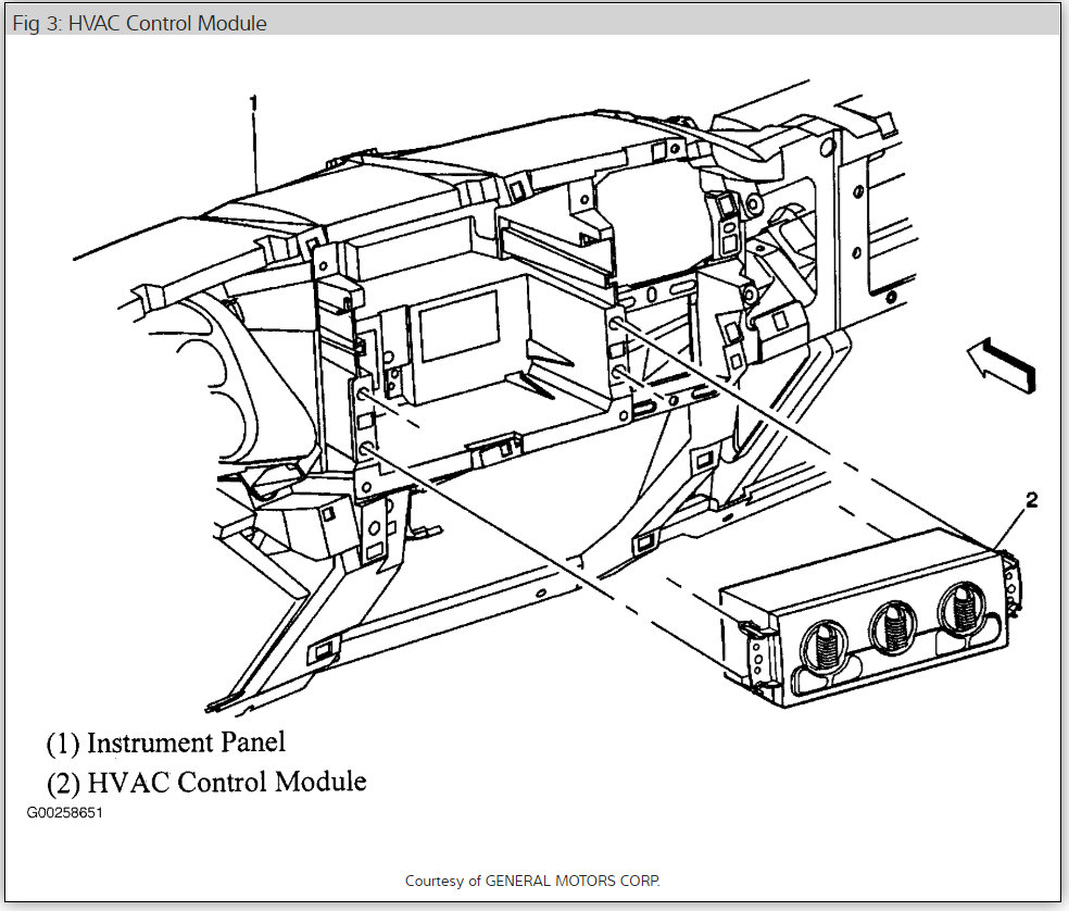

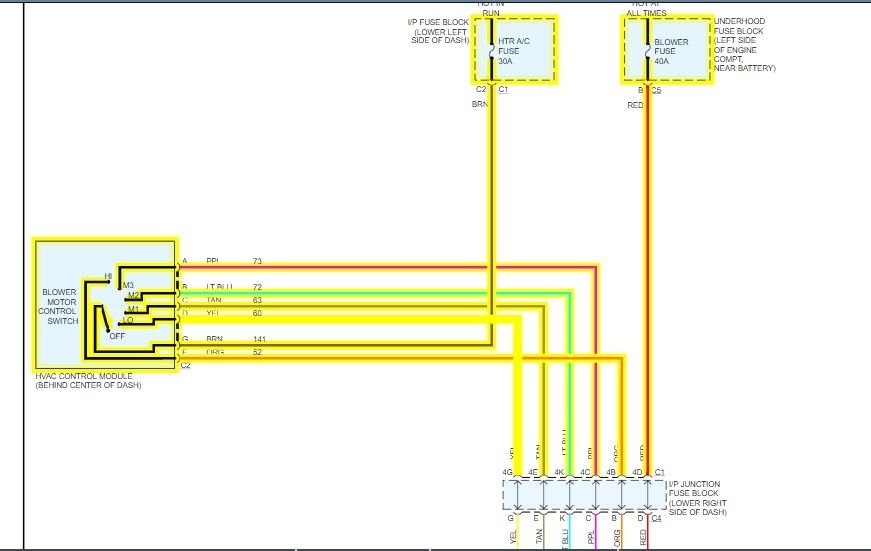

My blower motor is not working. I changed the resister, and the connecting harness that connects to it. I also checked the fuse and the fuse is good also, there is power coming from the connector going into the resister, but the pigtail that comes from the resister and plugs into the blower motor does not have power coming from it.
WRENCHTECH
  • 20,760 POSTS

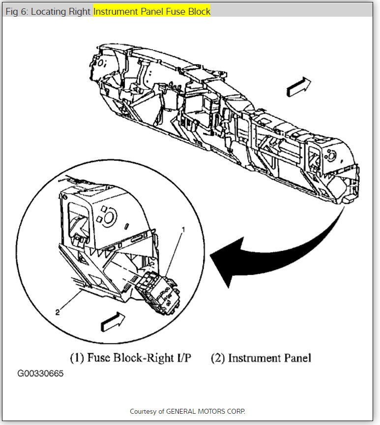

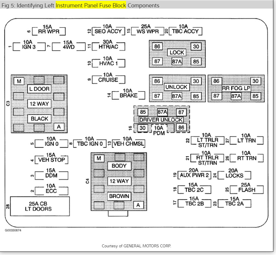

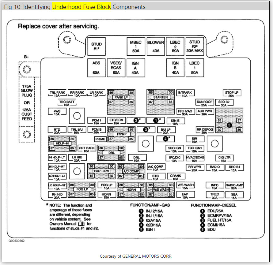

There are three fuses (HVAC, heater and blower) that run the system so make sure you check all of them. Here is a wiring diagrams and a guide to help you test the fuses with their locations:
If everything checks out we need to test the blower motor this guide with show you how.
https://www.2carpros.com/articles/blower-fan-motor-works-on-high-speed-only
If the motor checks out I would check the connection and wiring between the controller.
If all is good the controller is bad and needs to be replaced.
Check out the diagrams (below). Please let us know what you find.
Cheers

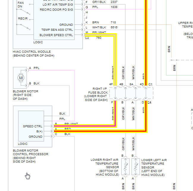

ALGAJR
  • 5 POSTS
There is no other power going into the resister besides the power from the red wire, I test all the wires and turned the knob on the control switch to all the speeds.
ALGAJR
  • 5 POSTS
I checked the fuses and their not blown, I rechecked the wires and cycled through the switch and the only one with power is the red wire. Can the problem be the AC control switch?

WRENCHTECH
  • 20,760 POSTS
If you are sure about the results of those tests, then you have a bad switch which means you need a controller. Here is a guide to help.
ALGAJR
  • 5 POSTS
The controller did it all fixed! Thanks for hanging in there with me. :) I love this site.

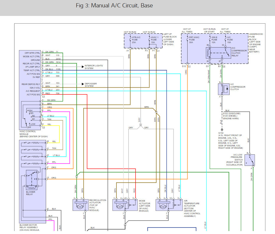

TELLME6532

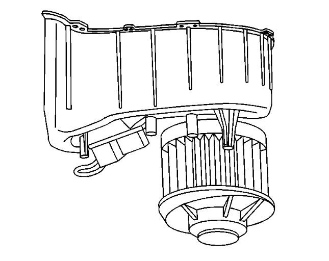

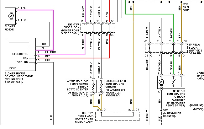

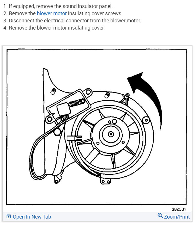

i have replaced the 7 wire plug at the resistor that goes to the motor, also replace resistor. i have used a 12 v tester on all 5 speeds all have light on the 7 plug end on the proper abcdefg line markings in proper order. even have a light at the plug end of resistor that plugs into motor on all 5 speeds,but when plug into blower motor nothing have tried a new blower motor but still no fan movement.I ran two wires to the blower motor straight from 12v source fan very powerful that way. any ideas?

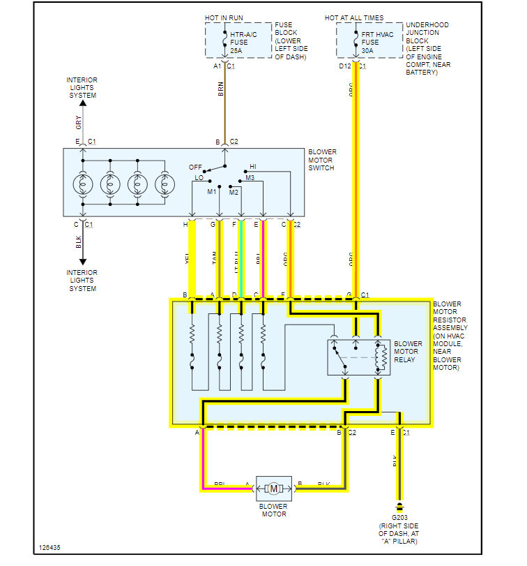

We need to back track to find out what the voltage is at the control processor (resistor). I understand you have voltage but we need to know how much voltage on each wire. Let's start with A. This should be 12 volts at all times. Next B, this should be different depending on what speed you have the fan set on. So let's check it on each setting.
Clearly if the blower motor comes on when you put 12 volts to then I suspect we have a wiring issue where you are not getting 12 volts on the B+ wire. If you don't have 12 volts there then the blower will not operate.
Let us know what the actual voltage is on each of these wires by back probing the connector with it turned on.

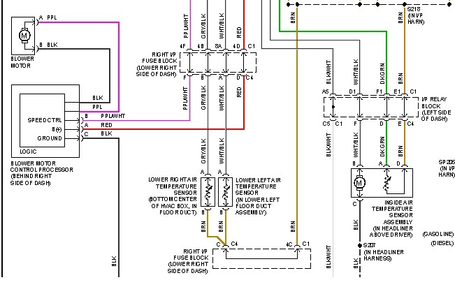

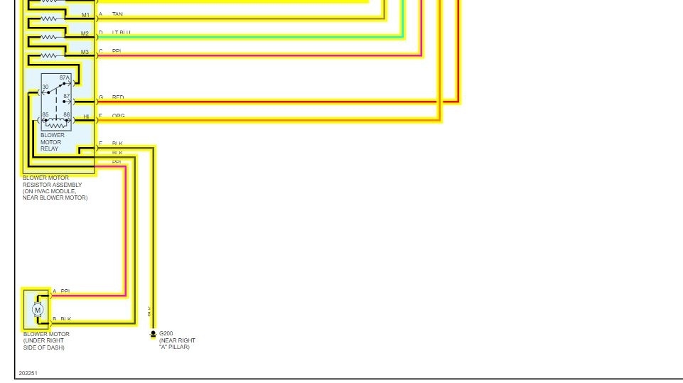

JDL
  • 16,098 POSTS

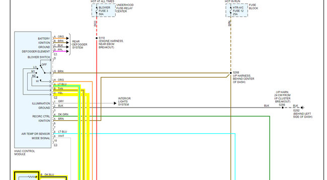

At the blower motor, the purple wire is voltage, black wire is ground. Note the diagram. The red wire to processor is fuse protected, blower fuse. There are a couple other fuses, that go to the hvac control module.

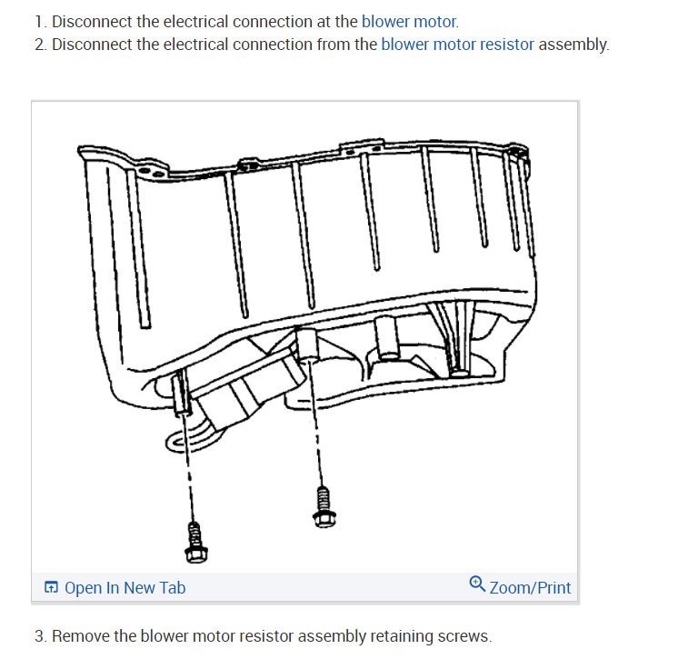

My truck's A/C system has a 5 point switch from 1-5 on blower speed. Blower speeds 1 and 5 stopped functioning but 2-4 worked. I dealt with it. Now 2, 3 and 4 are not working. I hear the compressor kicking in and I believe the trouble is the blower motor or a relay or maybe even the switch in the dash. I do not know where the relay is or how to get to the blower. I have restored and repaired A/C in trucks up to 1987 but after 1987 I am not familiar with these systems. Any information about this problem would be helpful.

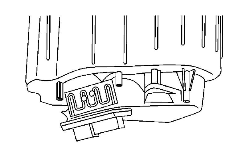

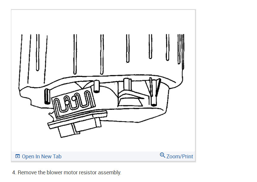

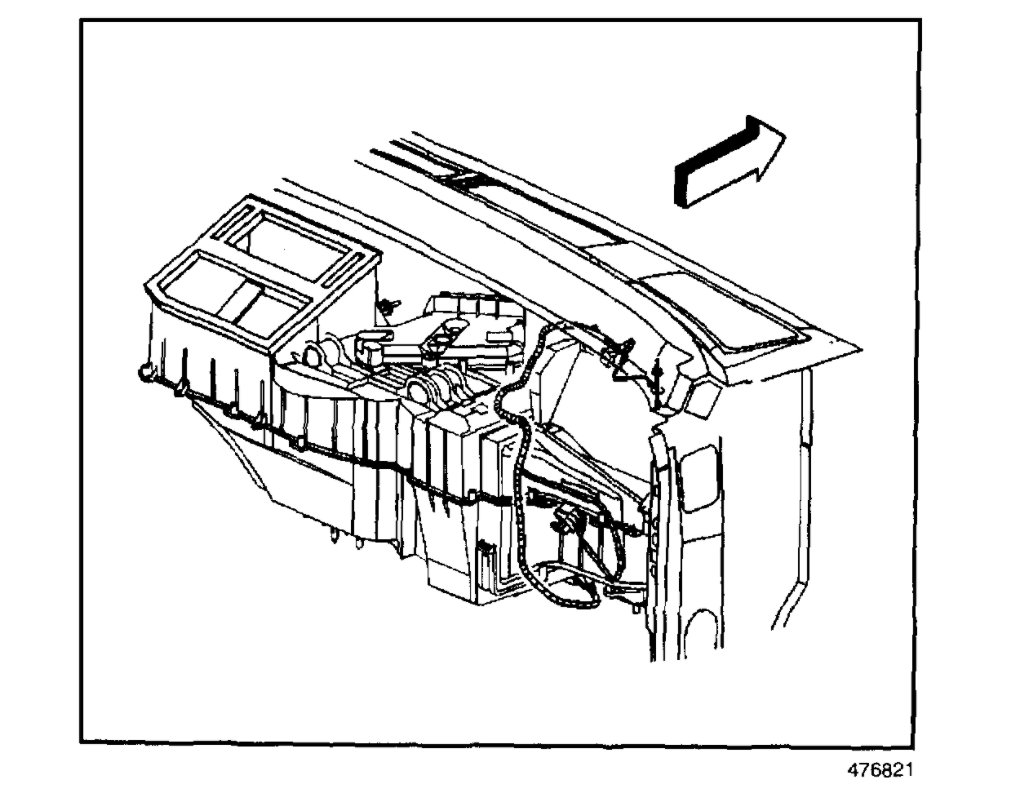

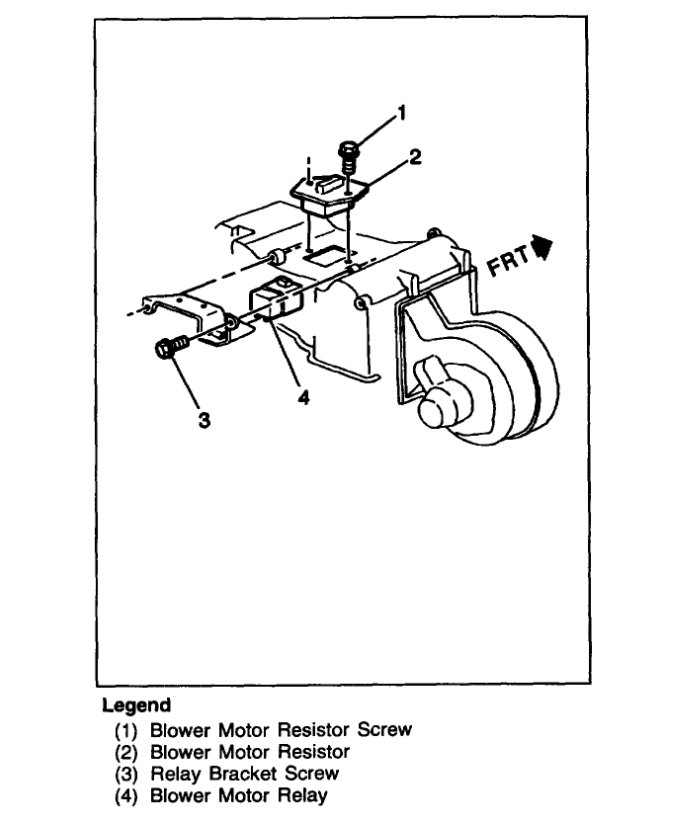

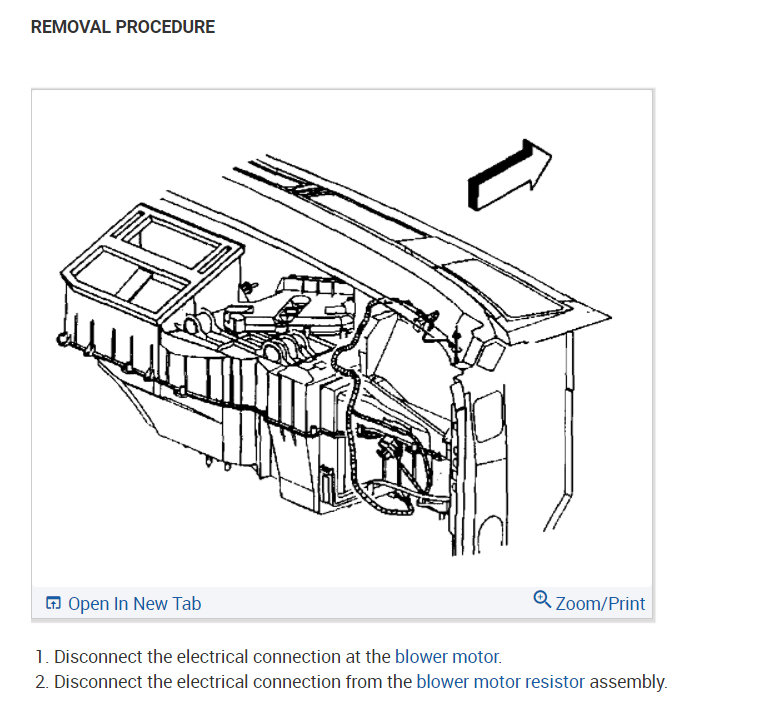

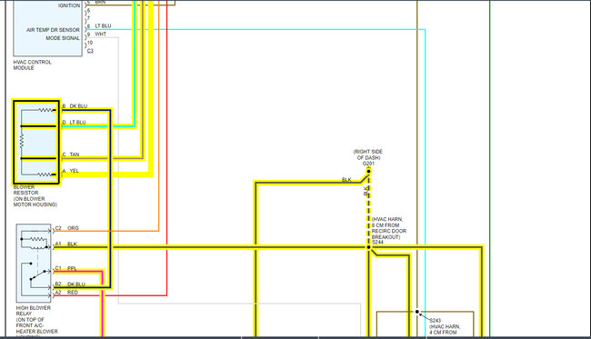

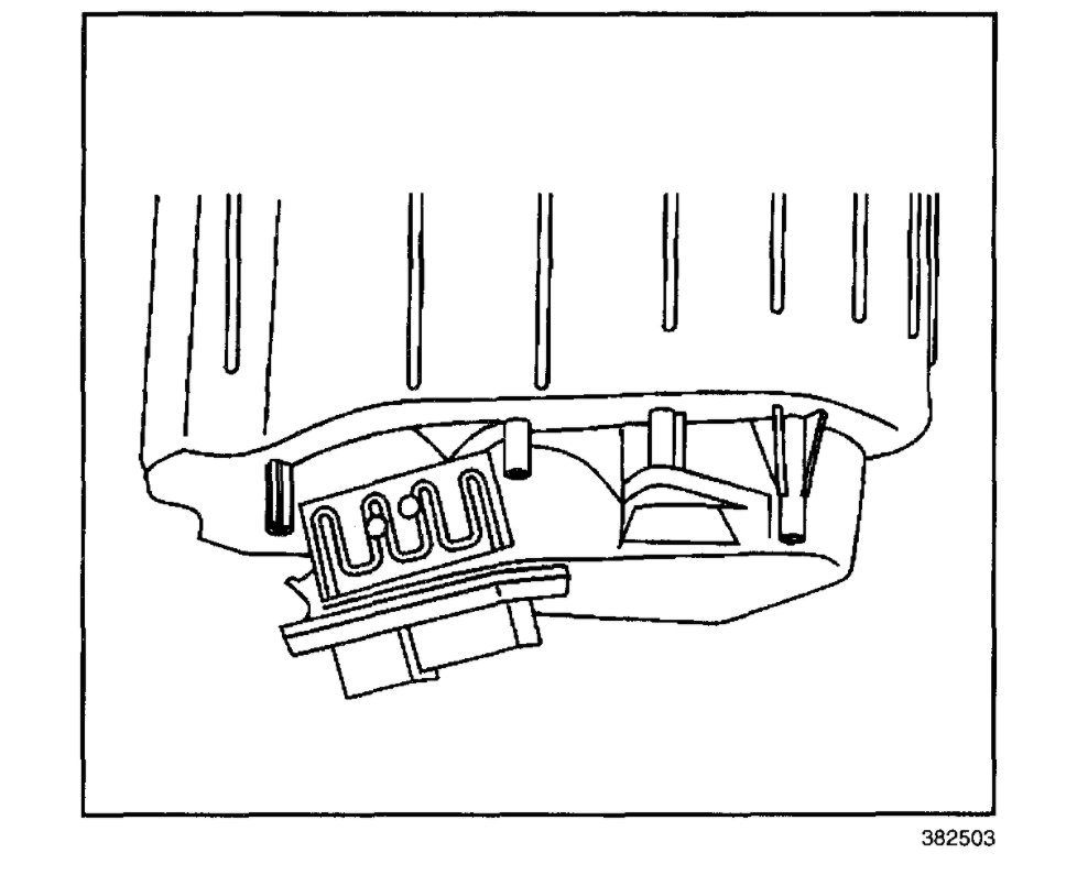

Good morning,
The blower resistor is the most common reason for this.
I attached the location and procedure for you to view of the repair.
I also attached a wiring diagram of the system for you to view. Verify power to the resistor.
REMOVAL PROCEDURE
1. Disconnect the electrical connection at the blower motor.
2. Disconnect the electrical connection from the blower motor resistor.
3. Remove the blower motor resistor retaining screws.
4. Remove the blower motor resistor.

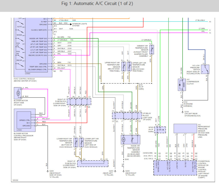

MAUDE ISADORE

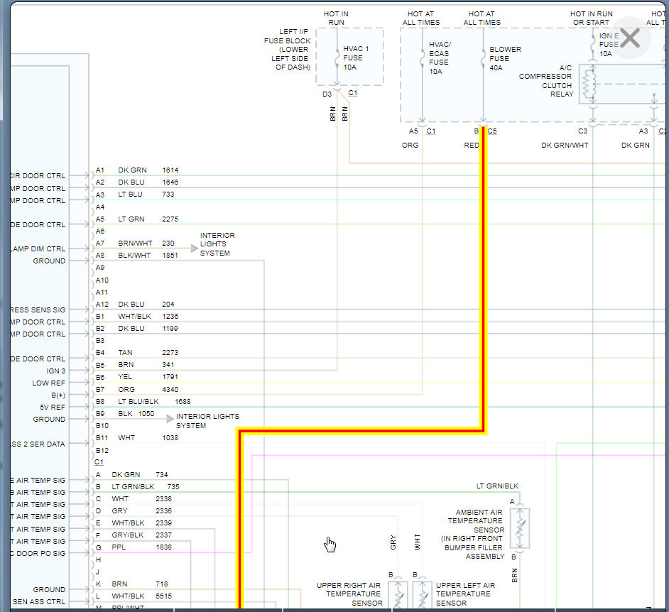

Fan motor started intermittently going on and off but only for a second but then stopped working all together. Checked 25amp fuse by drivers door=Good Larger block fuse under the hood, I did nothing with as I was told if it was bad nothing would have worked at all. Changed resistor on passenger side. Changed Relay on passenger side. Hooked wired from the battery. Changed the heater blower switch and fan blew on all four speeds for the first half of the day but then started working on just low and high and then stopped working all together? What is next?
Apr 30, 2021 at 7:24 AM (Merged)
I attached a diagram of the system for you below. Check for voltage to the blower motor when it does not work to see if the blower motor is the issue.
https://www.2carpros.com/articles/low-or-no-air-flow-from-vents

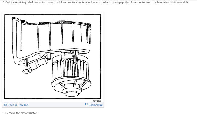

Here is a link to an article form this site that features written instructions, pictures and a video explaining how to check the blower yourself.

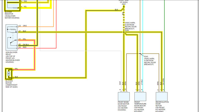

JWELZBACHER
I have a part truck so I took it out of it to replace. It still didn’t work. I took my controls my relay an my blower to part truck an hooked it all up everything works fine. I rehooked everything back up in my truck still doesn’t work. I put a meter on it in my truck an I am getting power all the way to blower but it want kick on for whatever reason. Any ideas?
May 25, 2021 at 4:46 AM (Merged)

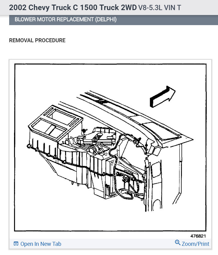

Good afternoon,
This sounds like the blower motor resistor that is the issue.
I attached the procedure for you of replacing the resistor.
