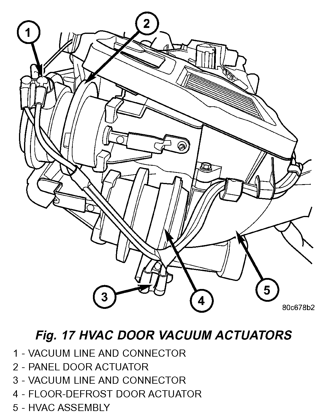

Where should I start to diagnose the problem?
Aug 18, 2019 at 3:35 PM
  • 110,194 POSTS
Welcome to 2CarPros.

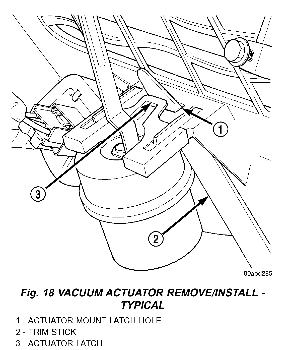

If you only get air flow through the defroster, chances are the mode door actuator has failed. Take a look through this link:
https://www.2carpros.com/articles/air-vents-stay-in-the-defrost-position

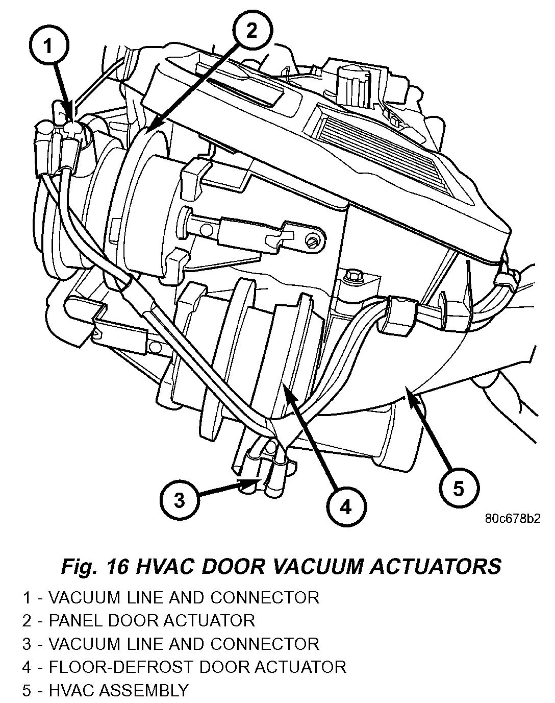

Now the interesting thing about your vehicle is that the actuator is controlled by engine vacuum and not electric. The problem could be a vacuum leak to the actuator or something is disconnected. You will have to inspect under the dash for any indications. I will say that with the engine running, you may get lucky and hear a hissing sound or slight whistle if there is a leak, but the engine will need to be running to hear that.
If you determine that it isn't a leak and the actuator is bad, here are the directions for mode door actuator replacement. The attached pictures correlate with these directions.

3. Unplug the vacuum harness connector from the defrost door actuator.
4. Insert a trim stick or another suitable wide flat-bladed tool into the latch hole on the HVAC housing actuator mount. Gently pry the actuator latch while pulling firmly outwards on the actuator to remove the actuator from the mount.
5. Rotate and tilt the vacuum actuator as required to disengage the hole on the end of the actuator link from the hooked pin on the end of the defrost door lever.
6. Remove the defrost door vacuum actuator from the vehicle.

Fig.17 HVAC Door Vacuum Actuators
pic 2
3. Unplug the vacuum harness connector from the floor door actuator.
Fig.18 Vacuum Actuator Remove/Install - Typical
pic 3
5. Rotate and tilt the vacuum actuator as required to disengage the hole on the end of the actuator link from the hooked pin on the end of the floor door lever.
6. Remove the floor door vacuum actuator from the vehicle.

Let me know if this helps. Also, often times, it is a vacuum related issue and not the actuator, so check that first.
Aug 18, 2019 at 7:32 PM
ANTHONY.H

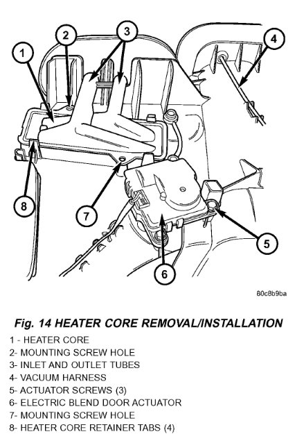

air only blowing through defrost vents. if i go under dash on driver side and by hand press the plunger that move the door to let air escape from other vents it will hold for little while then eventually it will go back to defrost vents only... i did find one break in the line and i fixed it but did not solve the problem i even replaced the mode plunger still not solved... so i was going to replace the blend door actuator that is behind the glove compartment that is hard to get to but wanted to know before i tore into the dash if there is anything else i should try before i do that.. i am mechanically inclined and still learning is there anything you could help me figure out so i don't have to tear into the dash... thank you

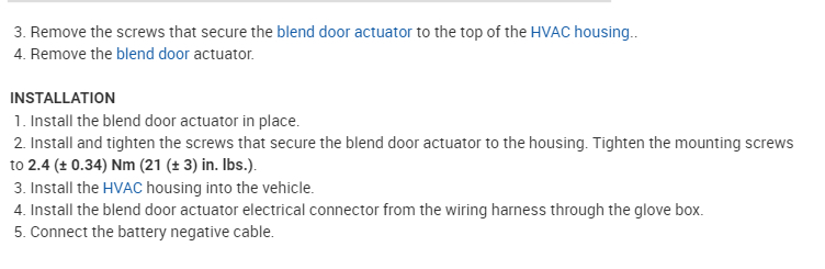

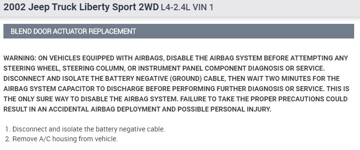

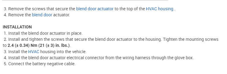

Yes, It sounds like you're having a problem with the blend door actuator.It sounds like it's broke/defective. Here is a tutorial showing whats involved in its replacement:
I've attached step-by-step pictures for your Jeep below.Hope this helps and thanks for using 2CarPros.
Danny-
Sep 10, 2019 at 4:47 PM (Merged)
ANTHONY.H
Okay, so the images you have provided are not the same... The actuator is under the airbag this is a 2002 Jeep Liberty 2.4L.
