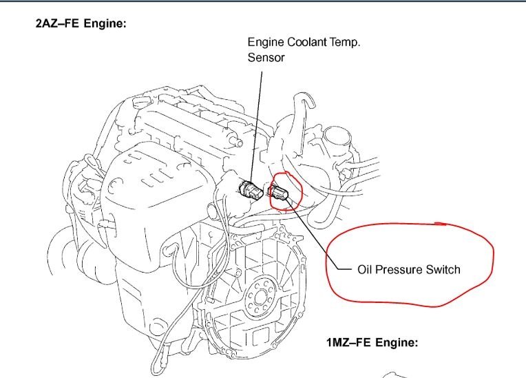

The indicator for engine oil light keeps blinking while the engine is hot and the car is idle despite there is adequate oil in the engine. The car vibrates whenever this happen
Nov 7, 2019 at 5:09 AM
  • 110,241 POSTS
Hi:
That is indicating low oil pressure, regardless if it is full. Are there any noises from the engine such as a ticking or knocking sound when the light is on?
There is an oil pressure sensor that may be bad. If there is no noises from the engine, we have two choices. One is replace the sensor to see if it was bad or get a mechanical oil pressure gauge (most parts stores will lend / rent one to you) and check pressure. All you do is remove the electrical pressure sensor and screw in the mechanical and start the engine.
I attached a picture of the oil pressure sensor's location for you to see. Check to make sure there are no leaks by it. If you plan to replace it, it screws out.
Let me know what you find.

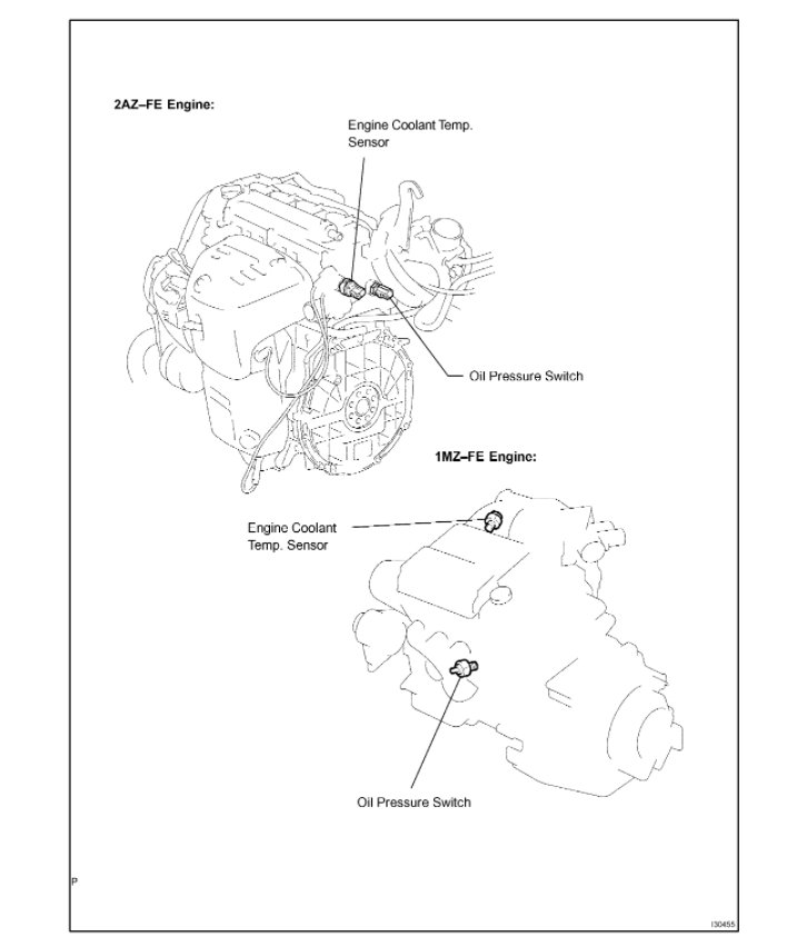

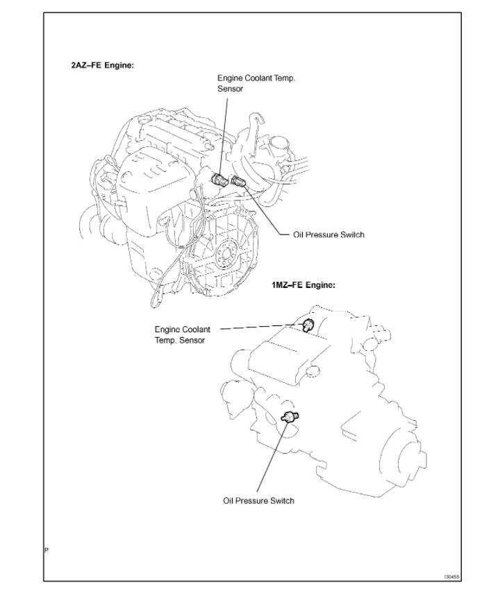

Can you tell me where the oil pressure sensor is on a 2.4l 4 Cyl Camry so I can remove and test/replace it.
May 23, 2021 at 3:37 AM (Merged)
  • 75,992 POSTS
The OPS is located on left rear of engine block. Check out the diagrams (Below). Please let us know what happens.
