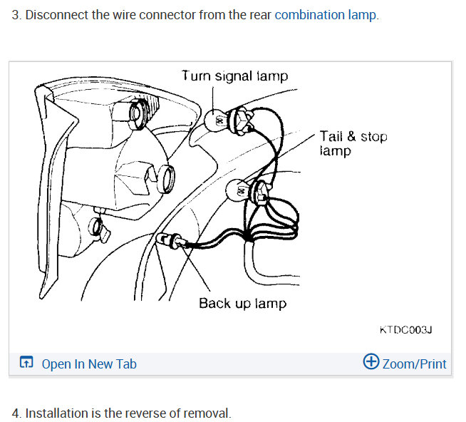

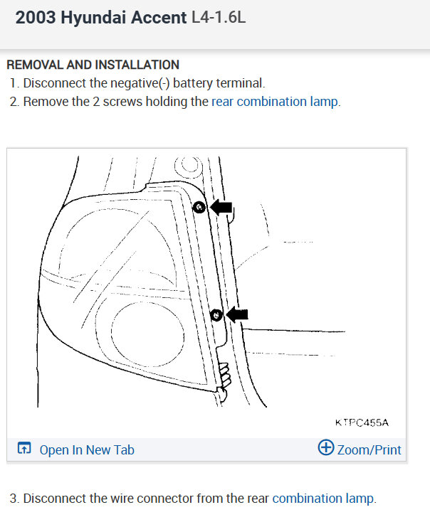

Yep, this is usually because the bulbs or sockets in the rear of the car get melted. Here is a guide to help and I have included how to remove the bulbs for inspection for your car:
https://www.2carpros.com/articles/turn-signals-not-working-blinker
Check out the images (below). Please upload pictures or videos in your response of any problems so we can see what to help you with.
